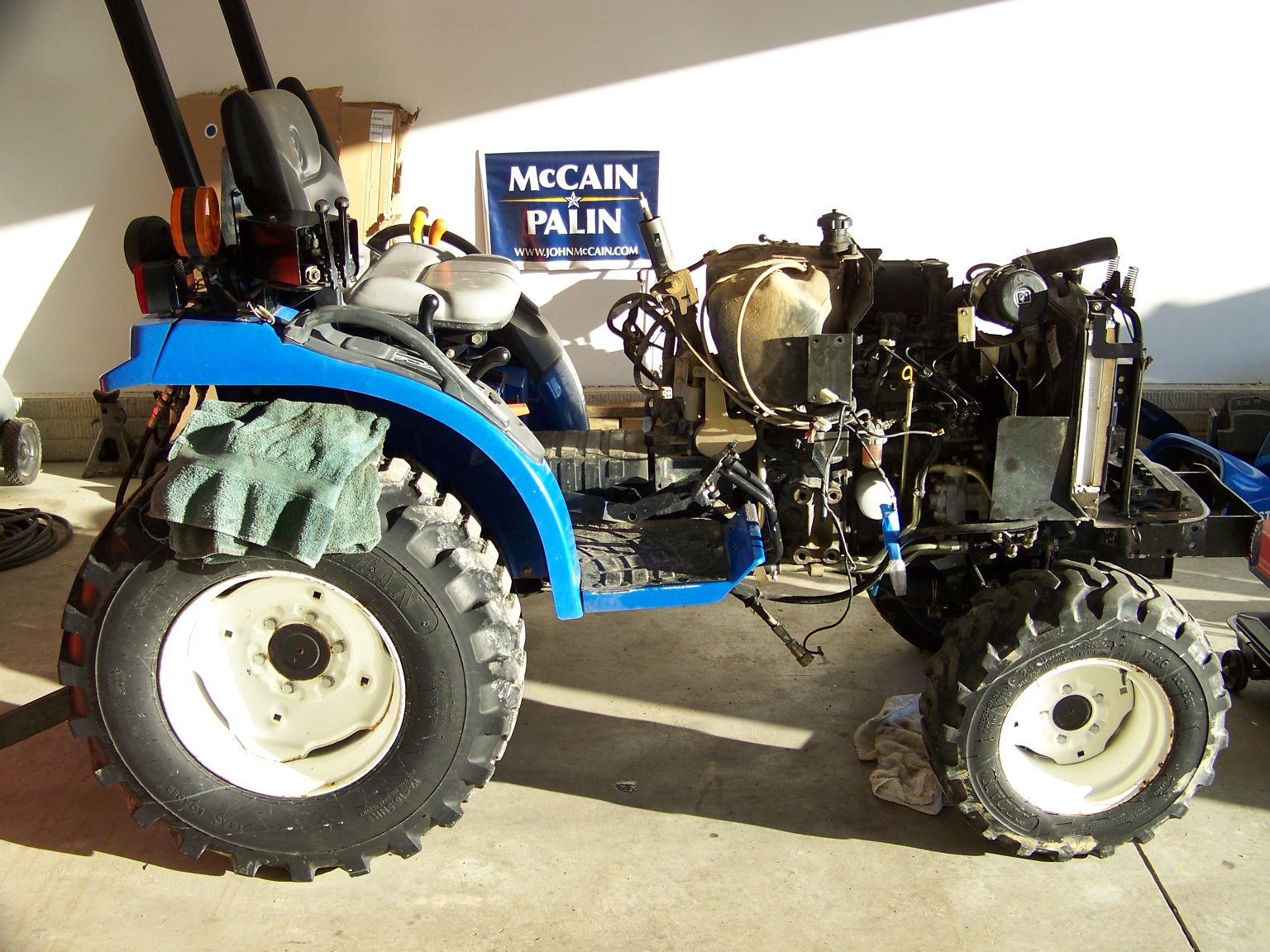

The doctor says, "nurse....hand me a beer!" The projects begins!
   / Surgery begins, splitting the TC24DA.
Various pics of parts and the like. I am putting the associated bolts, nuts, etc., in zip-lock bags and taping them to the respective part. Also, I'm under strict orders (not really...but I'm just being nice) to not take up space on the other side for the wifes car. I built last summer my other garage 24'/32' you guys may have seen the post. I would have really liked to have done it there as now I have to leave my truck outside. No electric out there yet!
I plan to take the time since I'll have everything apart to also go ahead and clean everything up good.
The first causality was the handle on the throttle. I had to drill the head off of the little screw that holds it on. In the process, the handle took some damage. Oh well, I'll add it to the list of parts needed. It seems the little things are going to be an issue here....aren't they always with any project?

Opps! I noticed in the background of one of the pics is a campaign sign! Sorry if it offends anyone, I know there are no politics allowed here!
The good news though, "change is here"! :)
Hey, MEGA, before you take any more parts off, why not roll the tractor
outside and pressure-wash everything? It will make working on it a lot
easier and the risk of contamination of the oily bits will be way less. It will
look near-new.
I am lookng fwd to the rest of your tear-down/reassembly pix. Thx for
posting.

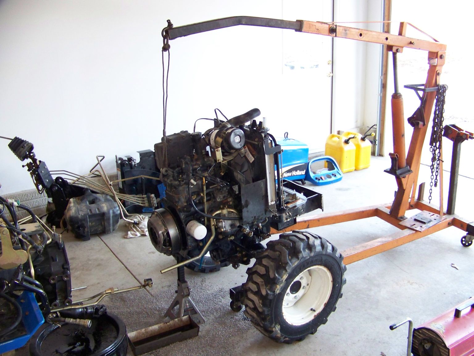

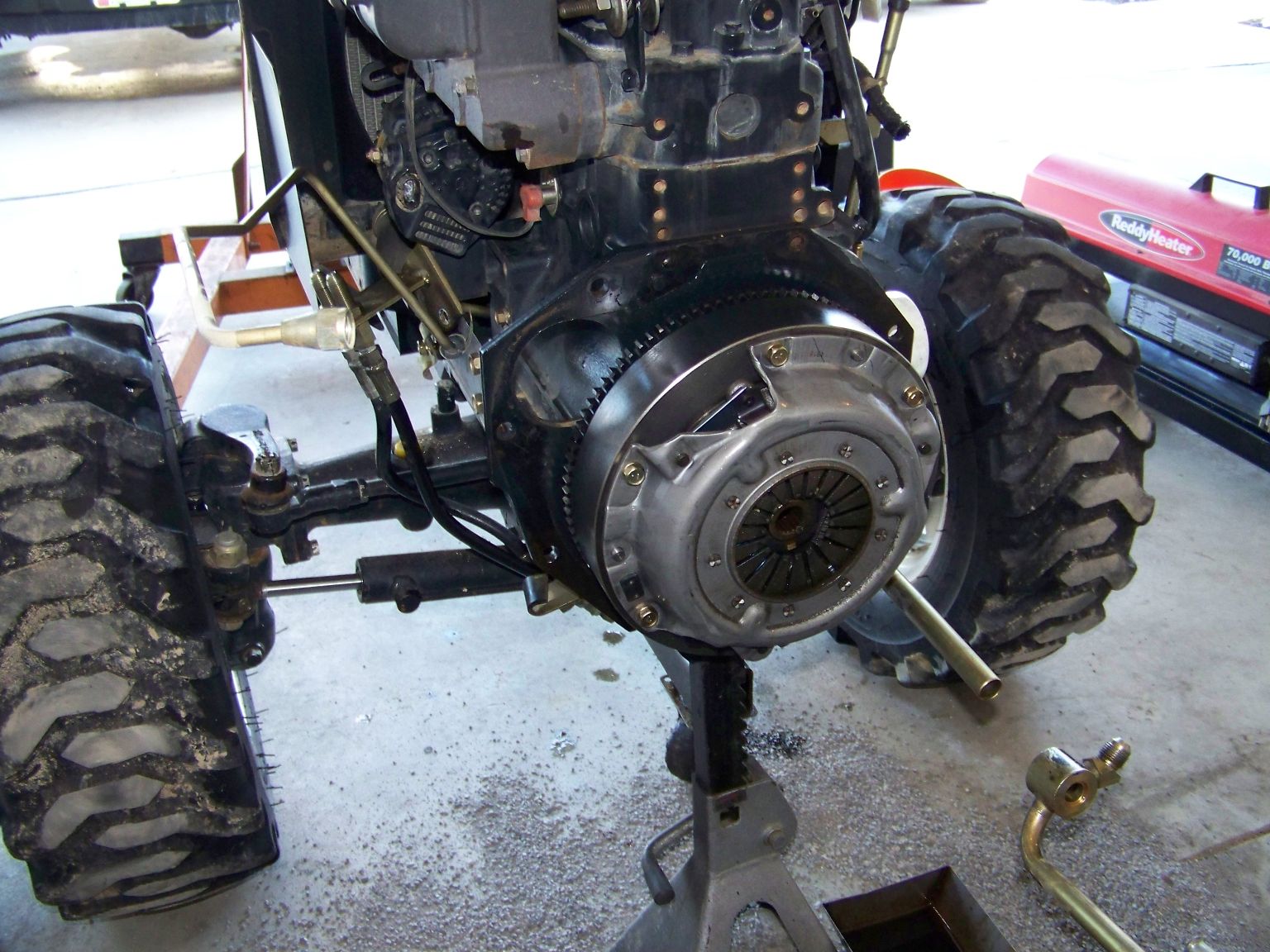

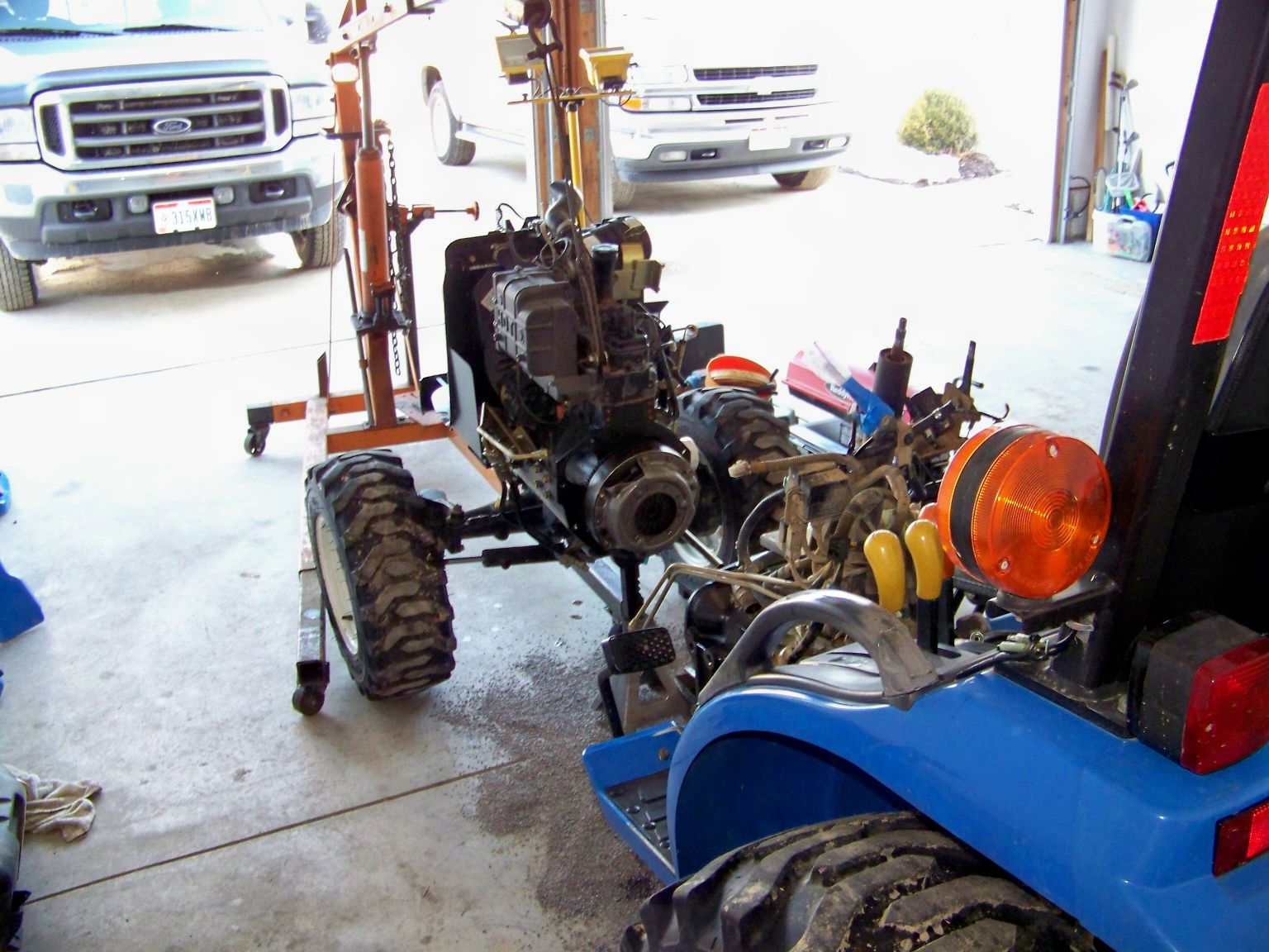

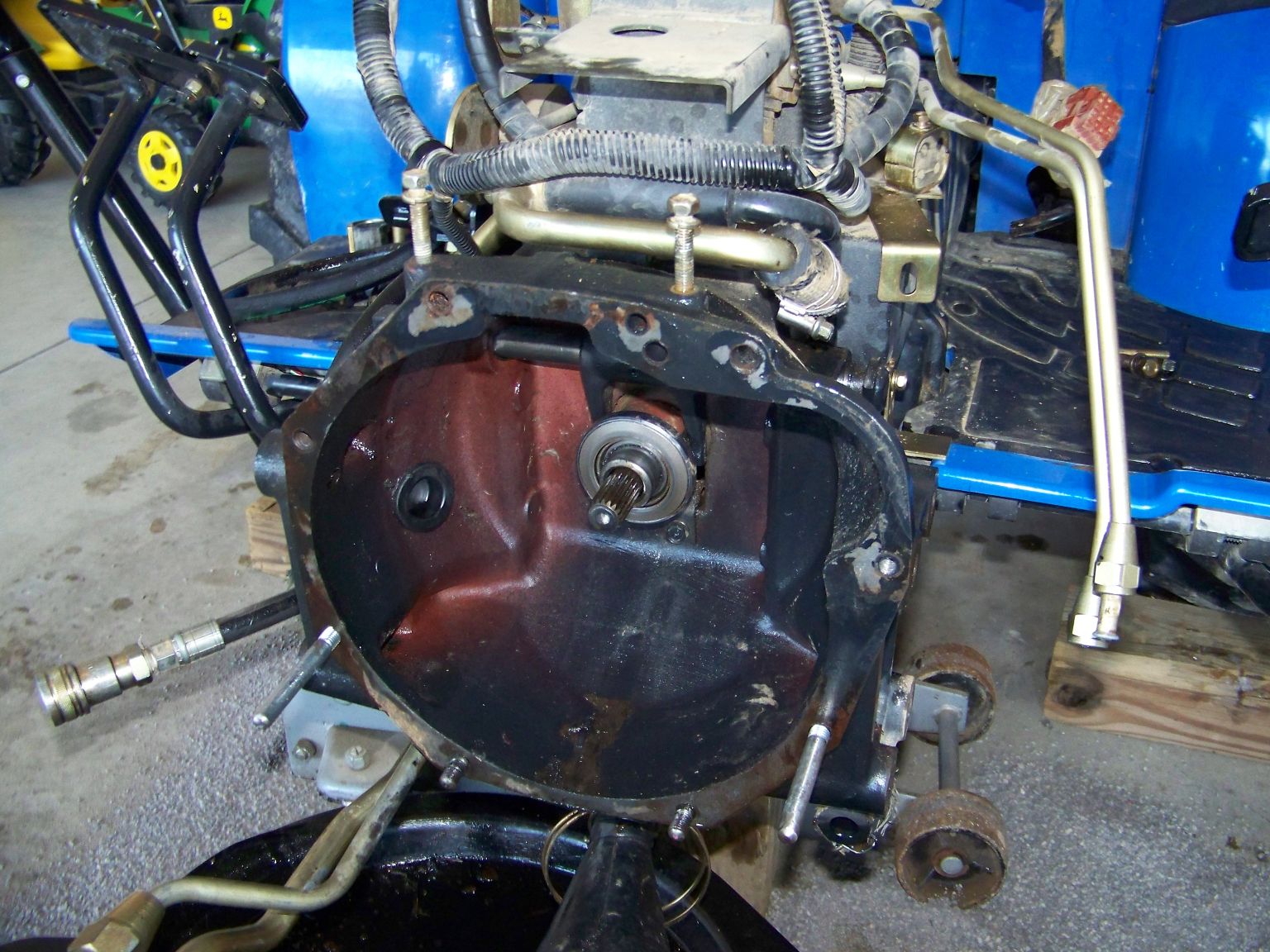

It ain't pretty but it is apart! It really went pretty easy so far. I noticed that the entire inside of the bellhousing was wet from both engine and hydro oil. The clutch seemed to be okay, but I'll see later about that.
I did not get a chance to clean things up as the wife was rushing me to get ready to go out with friends. Now I'm waiting for her to get ready so I thought I'd post these pics real quick. If not suffering from a hangover, I plan to dig in some more tommorrow.
Thanks for all the comments!
