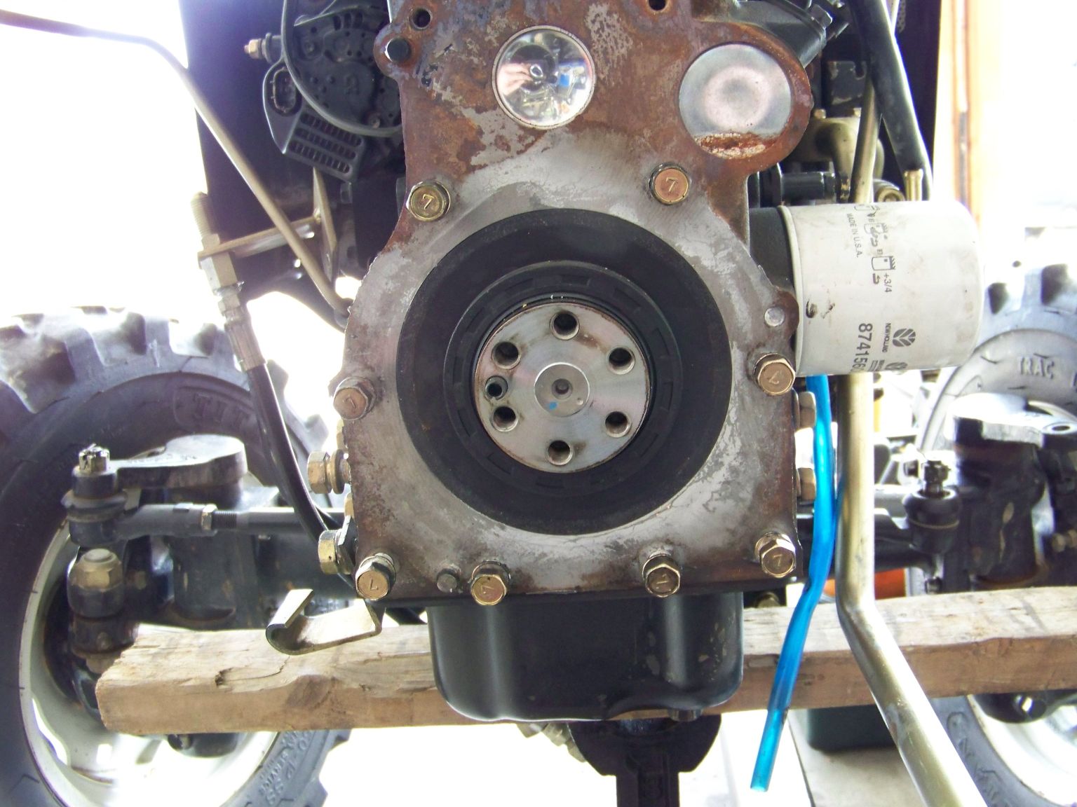

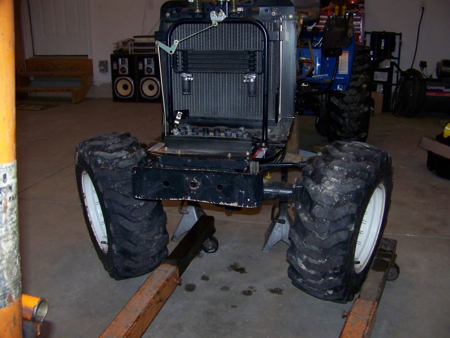

The first picture is of both front tires turned such that there will be no movement forward as the garage floor slopes out towards the door. One tire is wedged against the support leg of the lift. The lift is attched to the engine block via the factory lift point and tension is applied at all times.

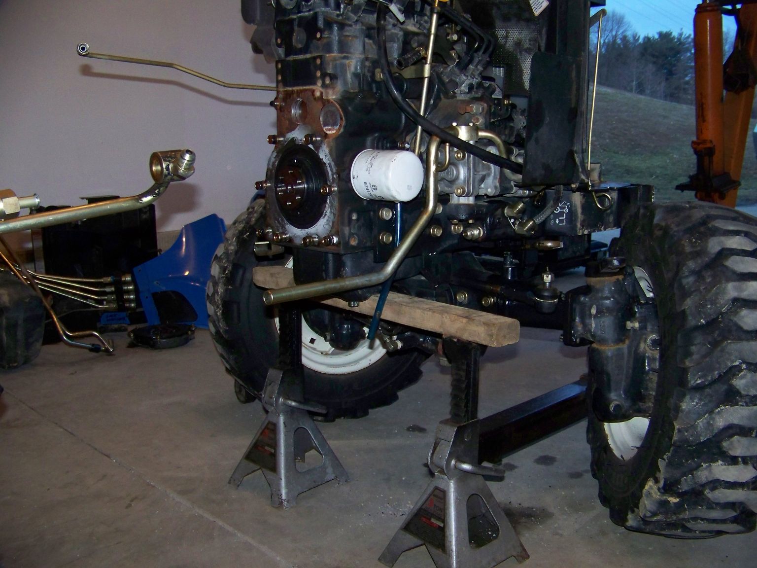

The second picture shows two (2) jackstands supporting a block of wood (not sure of the exact tensile strength :)) across the bottom of the oil pan (yep thats right...the oil pan). There is not much weight being supported at the back as it seems the majority of the weight is focused towards the front of the front half. This is purely in case the lift leaks off.

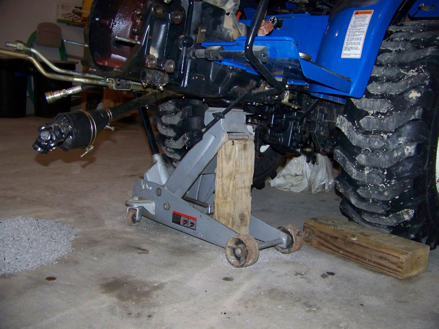

The third picture is of the floor jack that is supporting the rear half. As you can see, there are blocks of wood in front of the rear tires. In addition to that, the parking brake is still functional and it is applied. The floor jack has been secured in place with a piece of treated 4x4 and the pressure has been released onto that. A slight pump has been made so that both the jack and the 4x4 are both carring the weight.
At this point I think most of the safety concerns have been addressed. Thanks to those of you who have pointed out the lifting, supporting and other aspects of safety during the potentiallly expensive do-it yourself project.

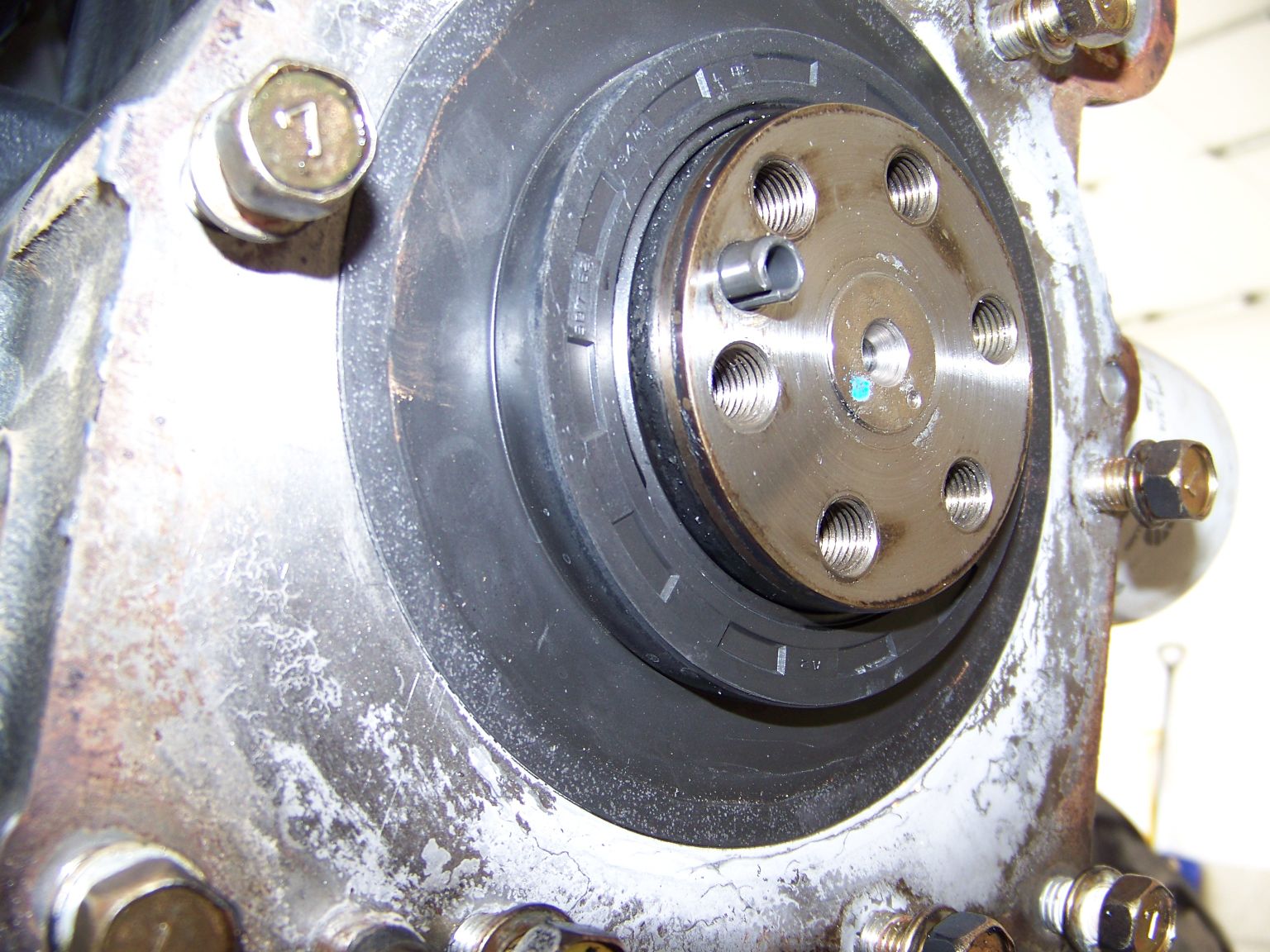

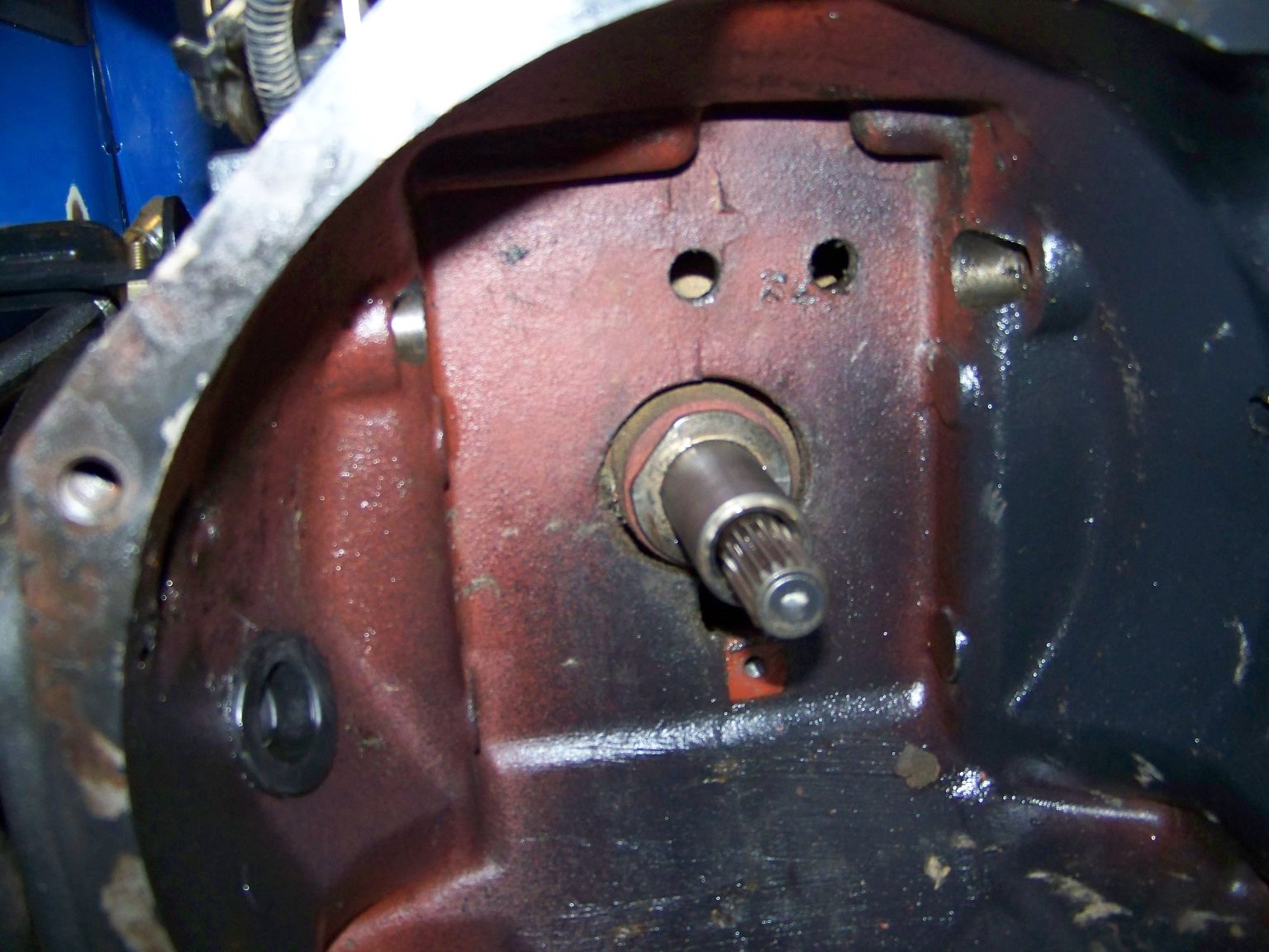

It seems that I was wrong in assuming it was the rear main seal. As you can see, it looks pretty good considering 600 hours. I have found however the culprit is possibly the seal on the input shaft of the transmission. I think is the same issue that TCBoomer had faced.
This is going to get replaced anyways since it is apart.

Heres the input shaft. Looks like a leak to me.

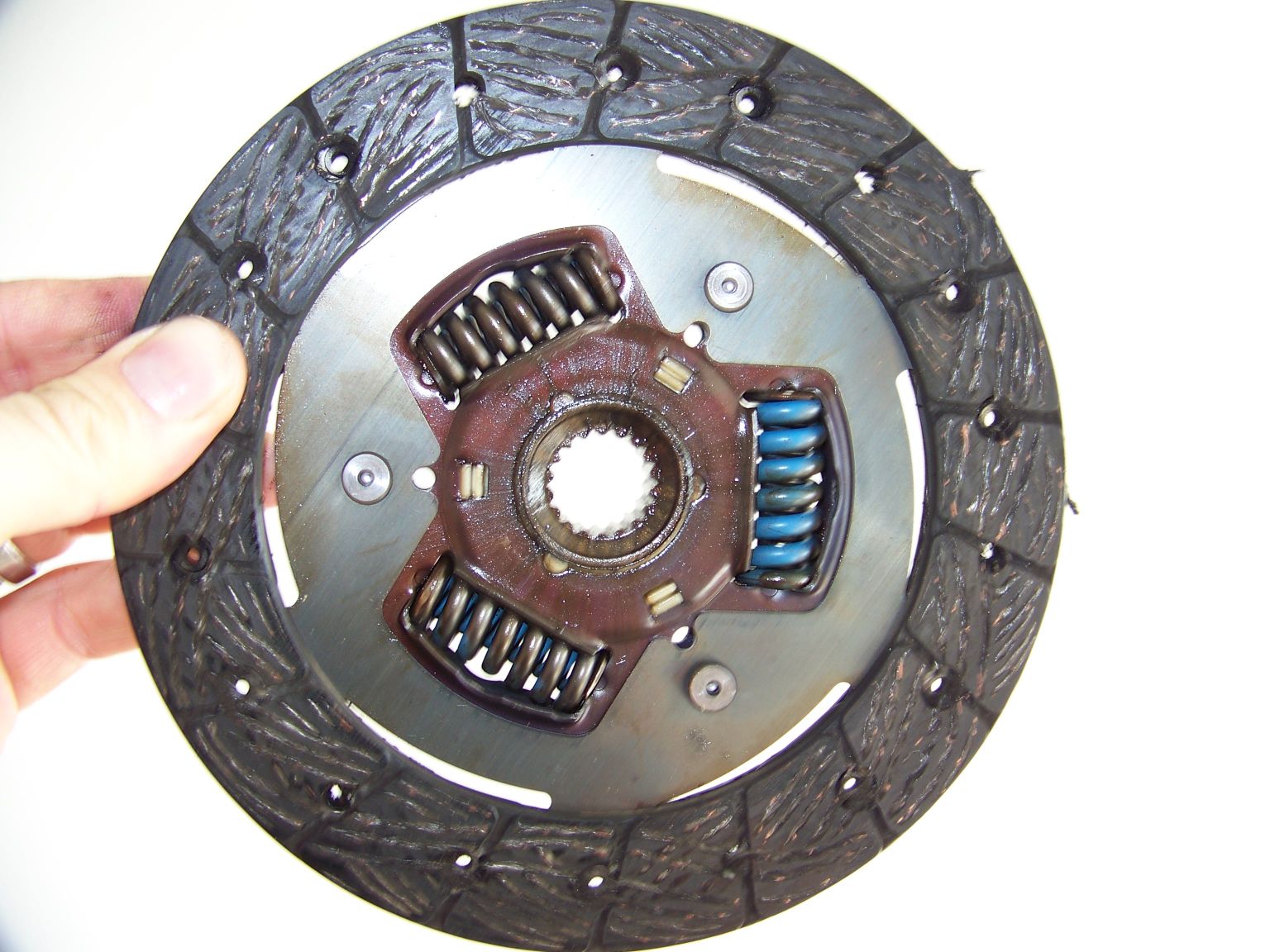

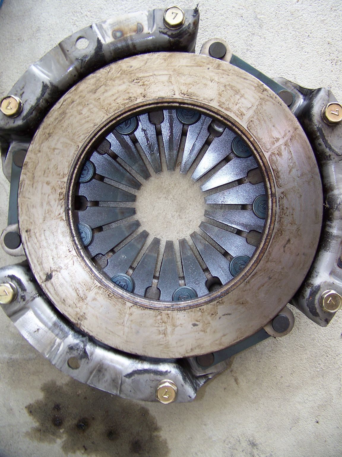

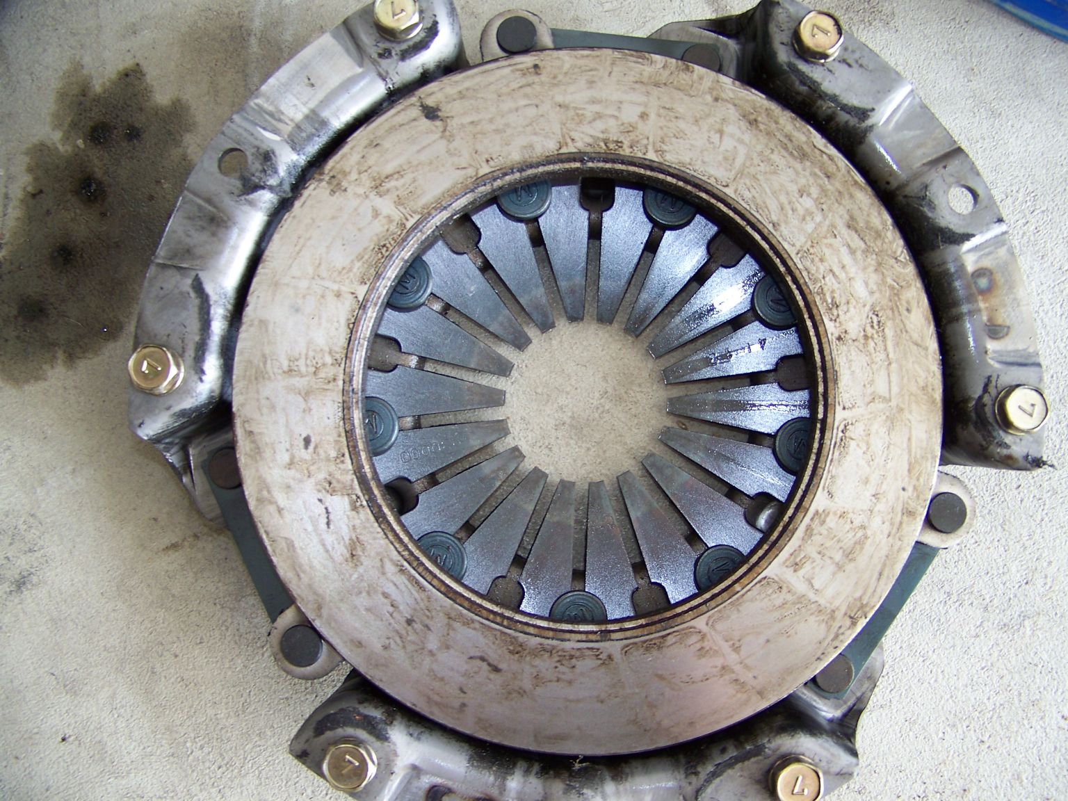

The clutch and associated parts were soaked. I never noticed any slipping or grabbing of the clutch prior to the teardown. I plan to clean all of the parts and either have the clutch refaced locally or replace it since everything is apart. I need to research the clutch disk price as it seems pretty steep....we'll see.
