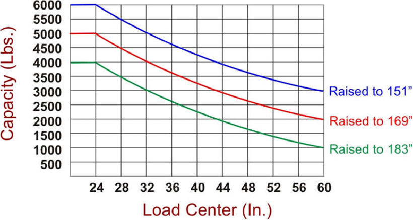

When I started this thread, I had no idea it would get such a great response. I'm learning a lot by reading the posts.
I do have a number of points I want to make. Some of those responding seem to be pretty disdainful of us new tractor owners and the fact that we do not magically know everything there is to know about operating a tractor safely. Number 1: I DID read my Kubota manual......in detail.....3-4 times before I used the machine, and unlike in a John Deere manual, there is no mention anywhere in it of the amount of ballast needed when operating the FEL, particularly when operating it near the limits in the specs. It does give the maximum weights of 3PH implements, but there is not a corresponding reference to those implements being used as ballast and how much ballast is needed to safely use the FEL. Number 2: According to the specs, everything I have lifted is below the specified limits (including the weight of my fork attachment) of the machine and I have never lifted any of these loads more than 4' above the ground. The specs refer to the limits lifting to maximum height and I have very intentionally never approached that height because I do have a fundamental understanding of the physics, and the weights I have lifted have all been below the weight limits specified at maximum height, so I wrongly presumed that I was safe since I was not approaching the maximum height and because I had loaded tires. Well, that was a mistake and I won't make that assumption again. I have been VERY careful moving this material around.....I'm talking moving material 30'-50' on a flat gravel area with the FEL 1' off the ground while I'm moving it, traveling very slowly, so I'm not being reckless here. Number 3: For 20 years I owned a millwork manufacturing business with 40 employees, a 50,000 square foot plant, multiple CNC machines, a bridge crane, and 3 forklifts. I had regular safety training for my employees, regular forklift safety training provided by my forklift dealer, and in 20 years, never had an OSHA reportable accident or injury. I am VERY safety conscious. But there is no such safety training that I am aware of that is available for new tractor owners. I would gladly pay $500 for a day of training on how to use my machine in the safest way possible, but there is no such hands-on, ass-in-the-seat training like that out there anywhere that I've been able to find, and I've looked. I resent the implication that we newbies are dumb goobers who should be nowhere near a tractor. I could probably teach people a few things about operating industrial woodworking equipment safely because I have a lot of experience with it and I welcome questions from new shop owners and help them whenever I can. I'm not a farmer and I don't have a thousand acres and I didn't grow up with tractors. But I'm not an idiot and I have my own little 11 acres and I have my 800' driveway and I need to maintain those things......and I need a tractor to do that. And I'm trying to do it as safely as possible.....and there are few resources beyond safety manuals, available to us. And the safety manuals do not remotely compare to ass-in-the-seat training....which is unavailable......and that's why I come to this forum; because there are a lot of experienced, knowledgeable people who try to help us out. So I, and I'm sure the other newbies would appreciate those experienced members who are more concerned with disparaging those of us trying to learn than with helping us stay safe with substantive advice, just take your ego and move on to the next thread. And to those who have been so generous in offering their helpful advice, THANK YOU very much.
I do wish there was a tractor stability load chart like the attached forklift stability load chart. Does anyone know if there is such a thing? And I've been thinking about the two-pencil discussion.......once the rear wheels get light, doesn't all the weight of the tractor and load shift to the front axel? And correspondingly, if you had a heavy 3PH implement or if the rear implement got caught and stopped the tractor and lifted the front end, all the weight of the tractor is then on the rear axel. So when you have a heavy load on the front axle but the rear axel is still carrying some of the weight, what is the proportional distribution of the weight of the machine + load on the 2 axles?
So anytime a manual gives an exact weight four a counterbalance they are very likely making the assumption you are on level ground and probably not moving. I've never seen a deere manual with specified ballast needed for lifting but the last one I looked at pre-dated DVDs...and cell phones...and personal computers. So between my bad memory and the years maybe it was in there but I don't recall it.
Shoot, millwork? I could probably get in there and wrap myself around a lathe faster than you could stop me. I can see how the same is true for tractors to the "newbs", mater of fact I think it's been proven over and over in news articles and horror stories. I never thought about a class, I already know everything but I even would be interested in taking one, you know, for science. You should send that comment in, I'm sure many dealerships would be glad to have an extra cash flow and manufacturers could make a good show for their insurance folks about how they improve safety.
So as I mentioned to the first question these charts have to assume you're lifting on a level surface, you're lifting straight up, probably not moving. None of that is likely to be true for most applications with a tractor. You'll have a tire in a hole, you'll be facing down hill already trying to lift that fence post out, you're lifting the bale up to to put it in the feeder with two wheels on 12" of accumulated manure. A tractor loader unlike the forklift pushes the weight away from the front wheels as it lifts to a certain height then pulls it back closer maybe even over the front wheels. We also move on tractors a lot while, maybe not ideal or something we should do, but we adjust loads on the move and even pick things up moving (cleaning bales of a field comes to mind). I wouldn't want the liability of saying "ohh yeah, you put 437 lbs on the 3PT and you can lift max load with the FEL safely" vs the forklift which we are 99% safe in assuming the conditions and stability of a lift based on the intended use of the forks (warehouse, lot, off pavement, off road).
