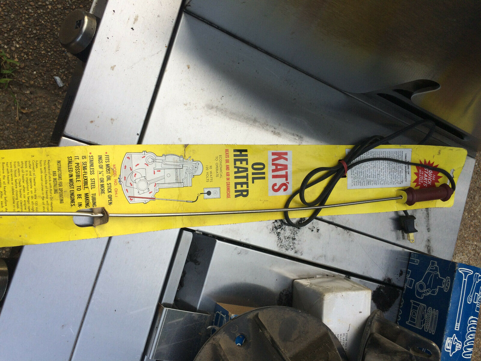

Does anyone have experience with these? I used one for the 90w in the tranny but now use a magnetic. Was afraid it would scorch the oil. Had no evidence of that, just paranoia I guess.
