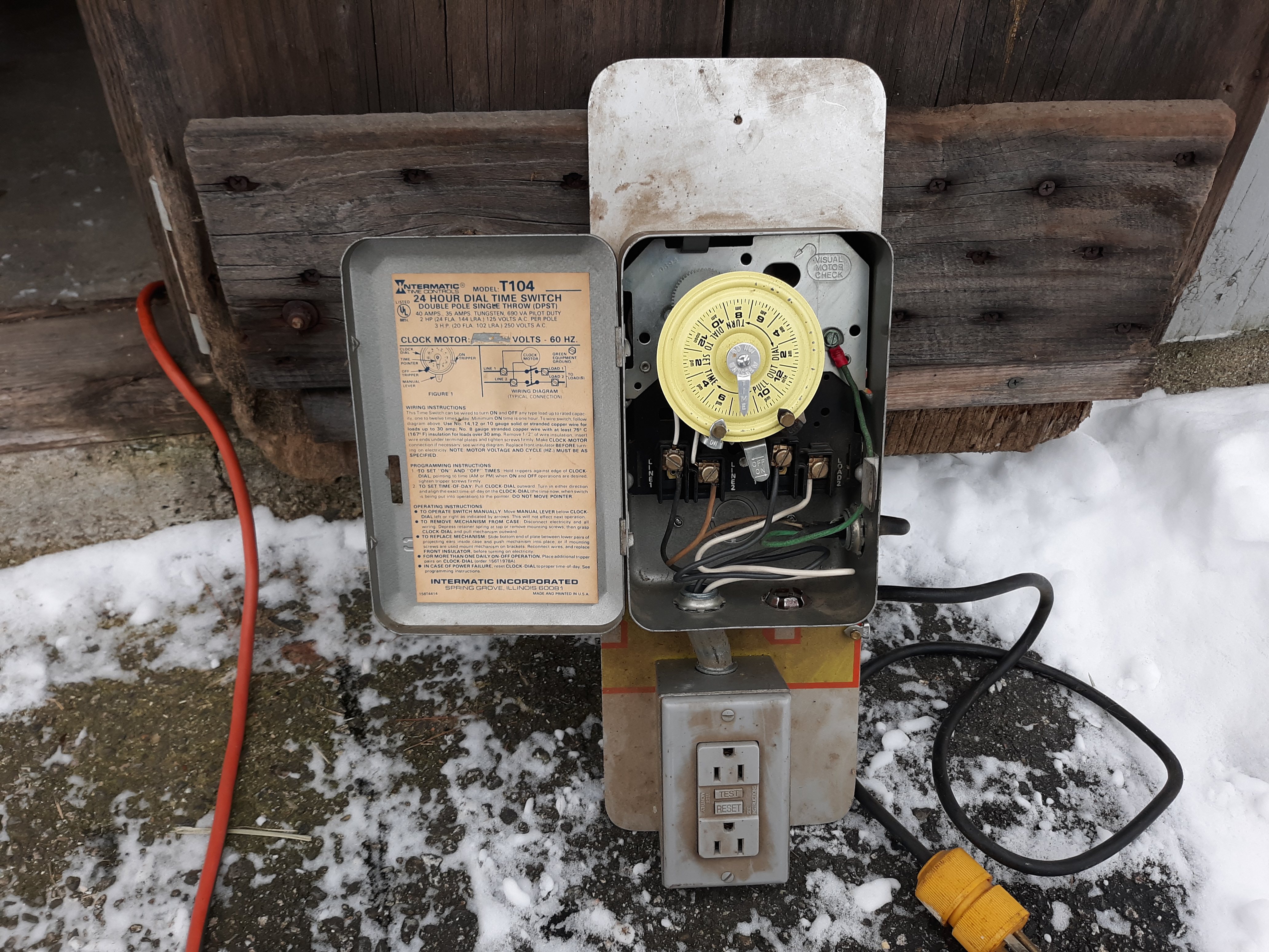

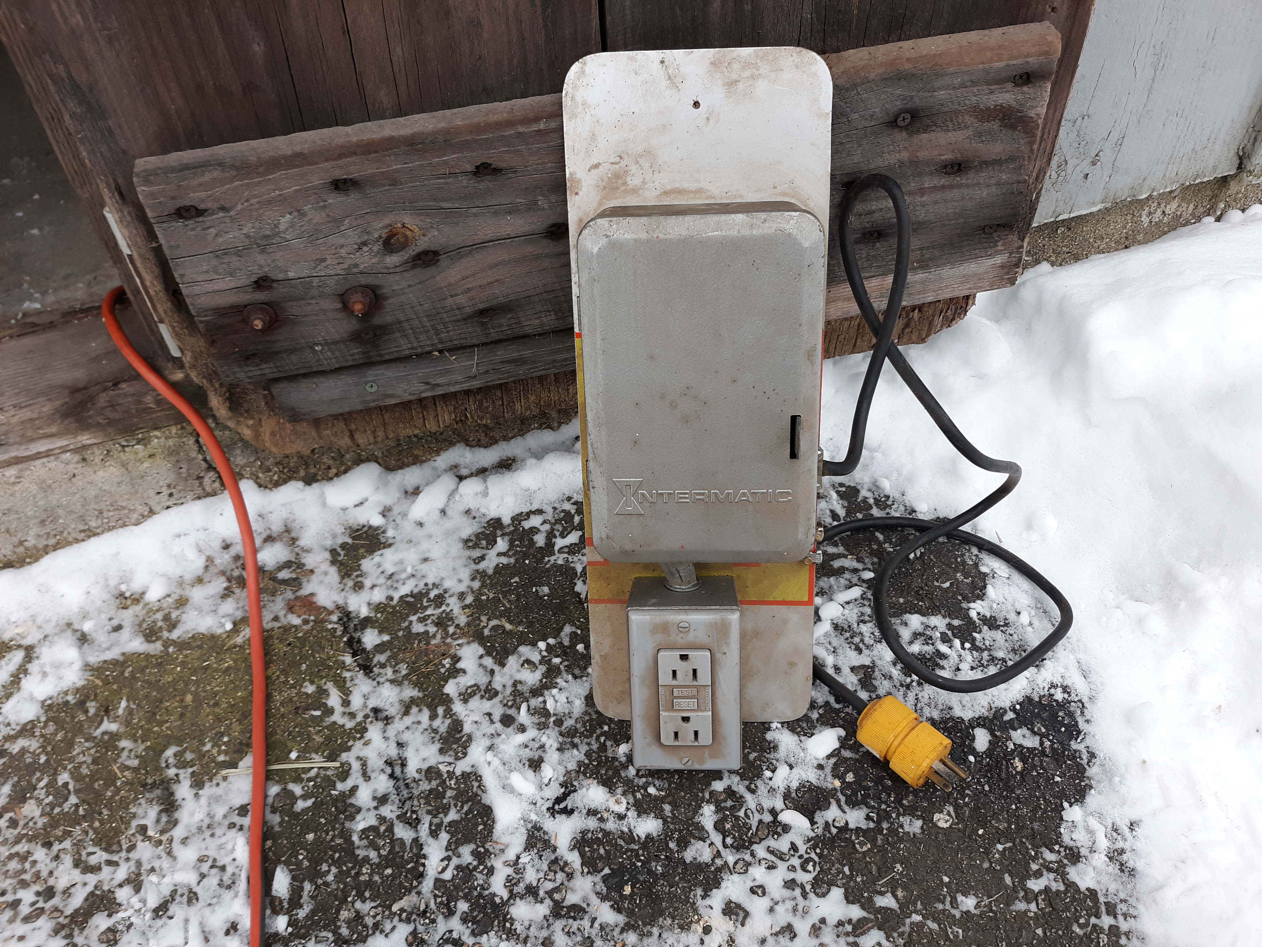

Anywho the real question.. These simple household Timers, the don't list their amperage capability. At just under 4 amps for my block heater, I wonder if these times will be OK long-term. I don't need to strain them and have the contacts arc closed.
Anyone rely on this type of timers?
   / Surprised how much block heater helps starting diesel #67
Not if they don't list an amperage or wattage rating. I wouldn't buy one to turn a lamp on without knowing what it is rated for.
   / Surprised how much block heater helps starting diesel #68

There are plenty of 15 amp rated timers available that would be preferable to an unrated device. The Holiday decorations isle should be full of them.
I have the manual dial types, electronic 7 day type, and my current choice of a WiFi controlled plug in outlet (WeMo).
