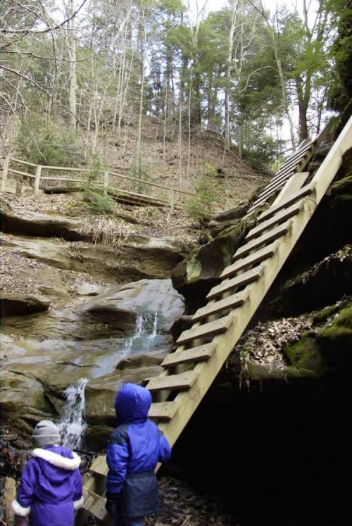

This is a view looking east at the access stairway at the south end of the bridge.
