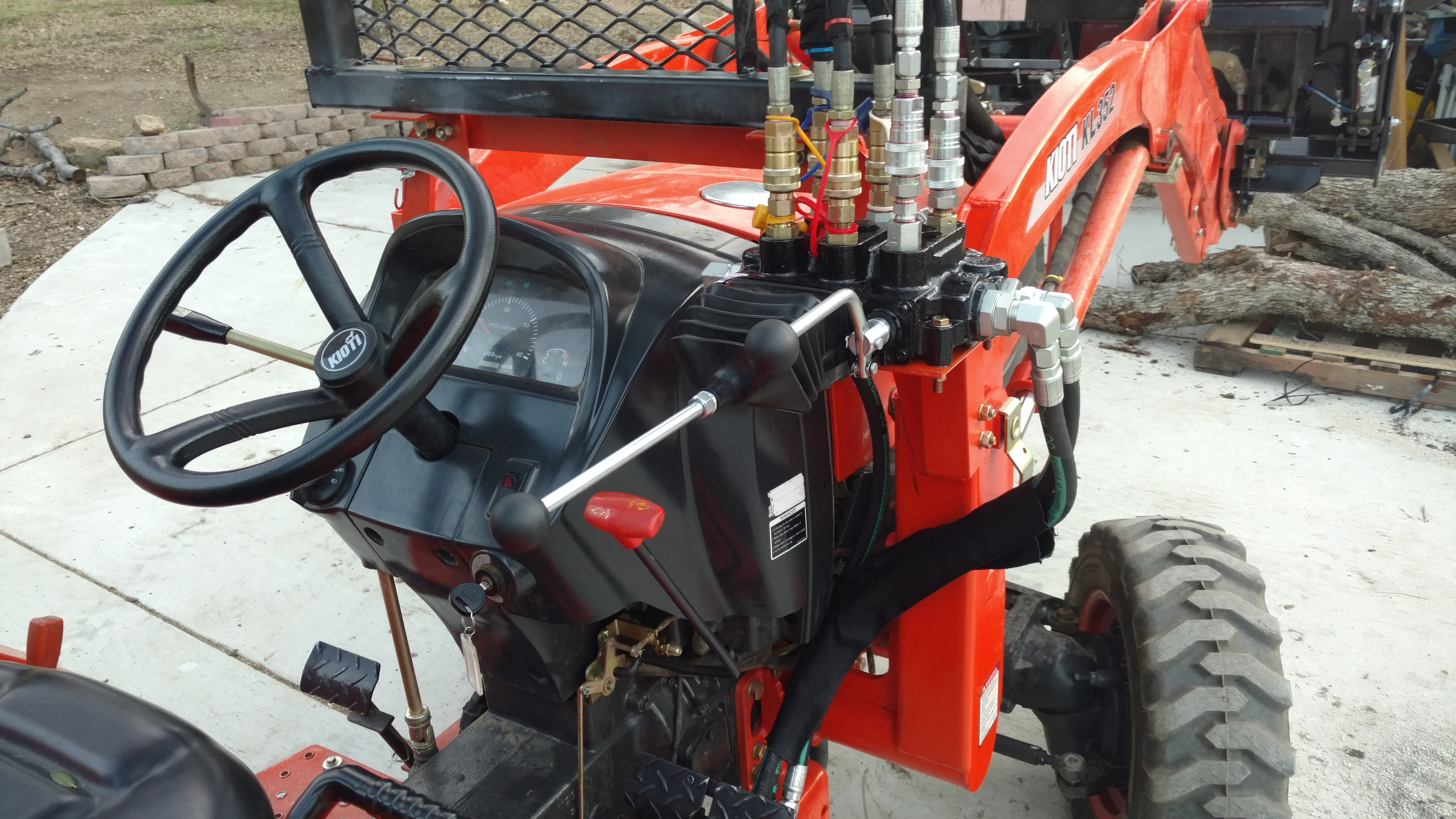

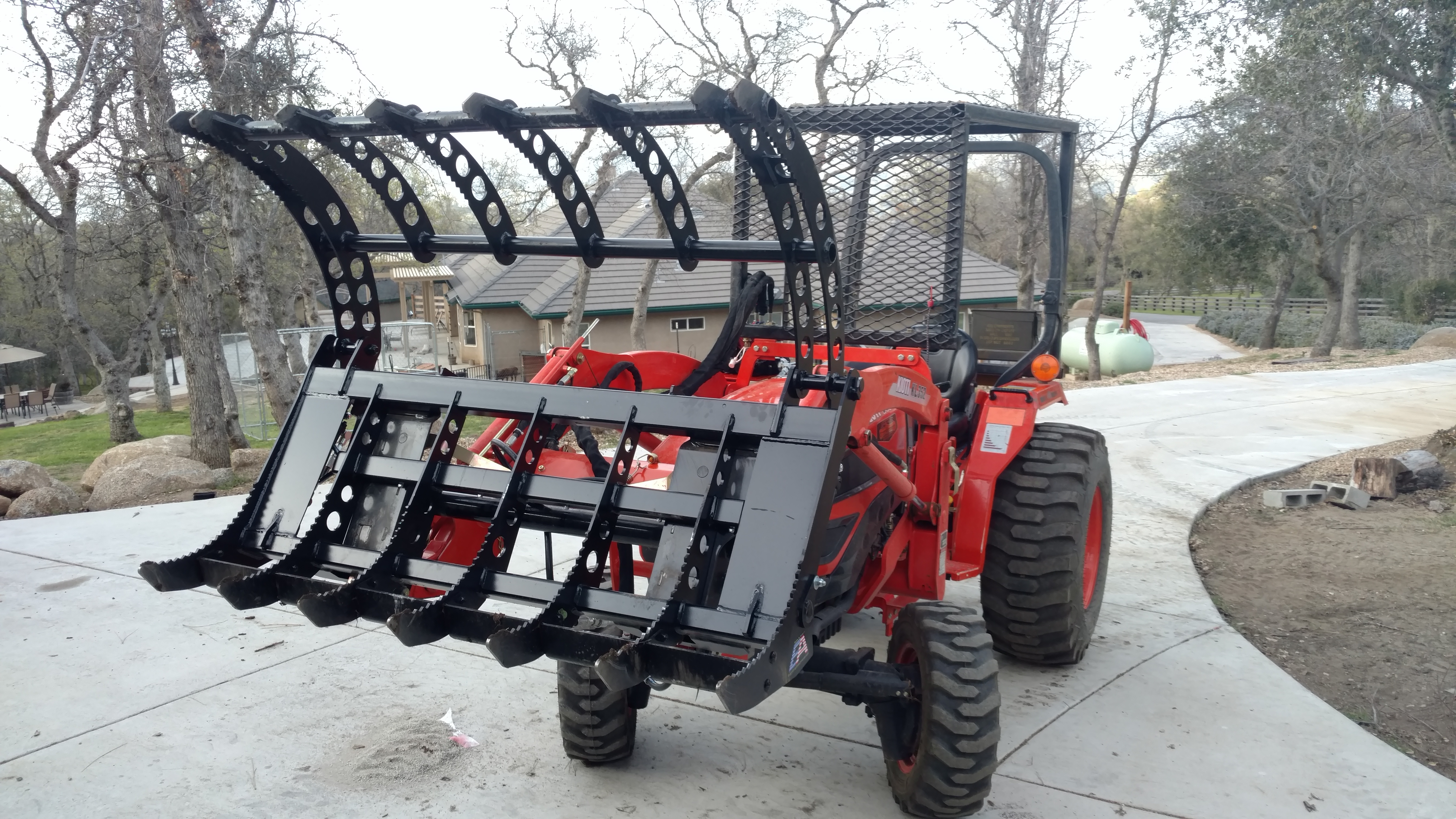

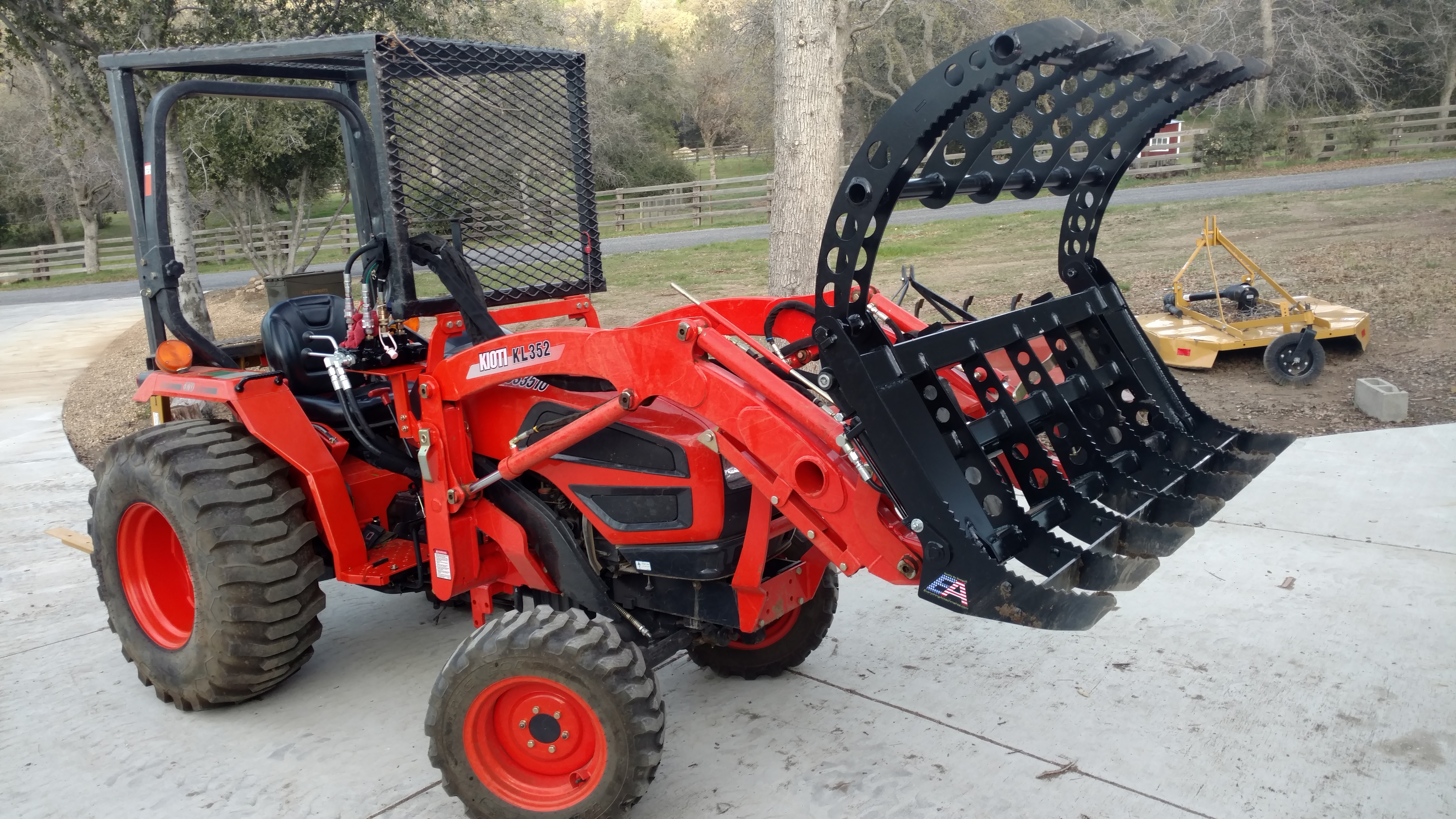

I read this thread with interest - I'd been considering the same valve for my Kioti DS3510. I damaged the original joystick, but cobbled a repair. I wanted to add a grapple, and avoid a button. I hesitated because of the sensitivity, but gained confidence from your post. The valve has arrived, and I've plotted a mount. I will get to fabbing right after Christmas (been too short of time and energy to get started) as I'm off until January 8.
Thank you for sharing your experience.
Finally got well enough to get 'er done!
Works great, much better than the factory joystick.

I just purchased one of those valves and was wondering if you could tell me what size and type fitting were required. My Kioti loader is using 3/8 lines. Thanks
   / Swapped Out FEL Valve, Got Grapple Control and FREE Rear Remotes #15
I cheated. I took the tractor and the new valve to the hydraulic shop. The helpful folks there hooked me up with all the fittings I needed to adapt to the new valve, and made up the hoses where I needed them. I lacked the knowledge and experience to do it myself, and it's 35 miles each way if I missed something. They even had the Power Beyond adapter in stock. I also bought the sleeve material for the new hoses.
I reused the original quick connects, and added four more sets for the new third function lines. The supply, PB and return ports are SAE 12, the valve ports are SAE 10, IIRC.
