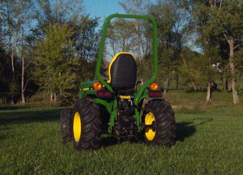

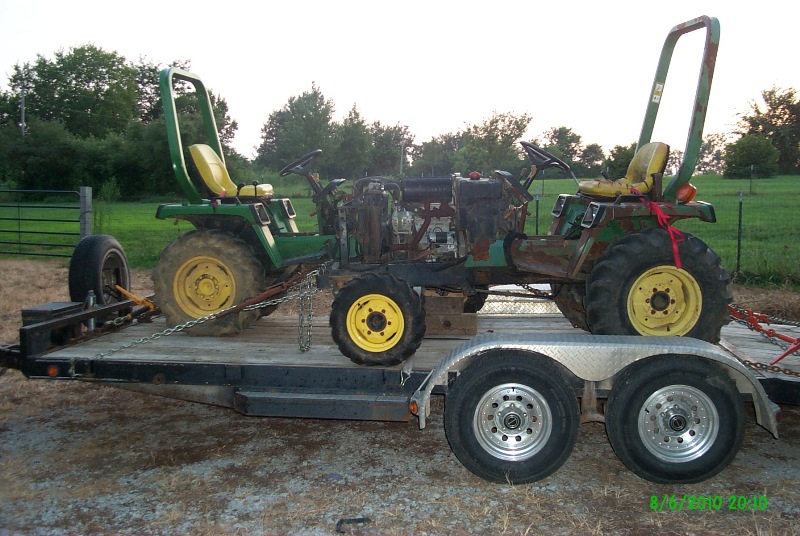

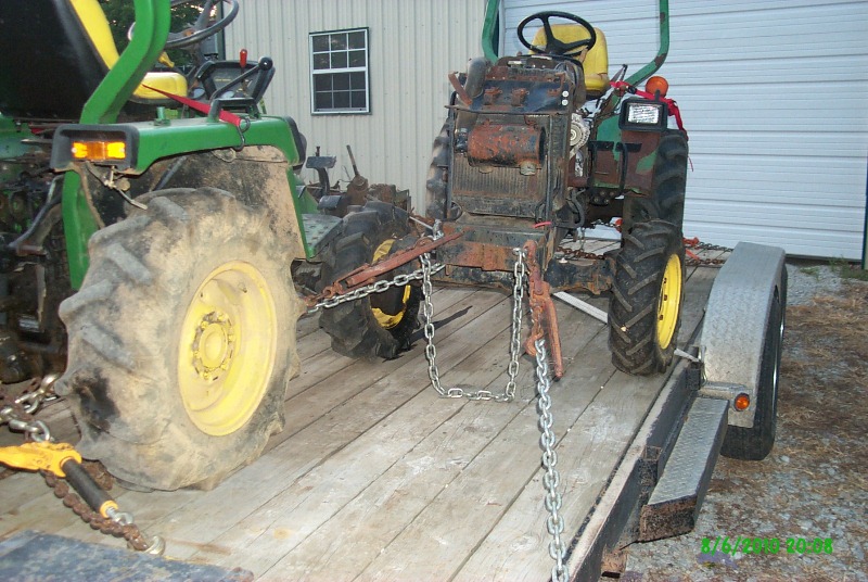

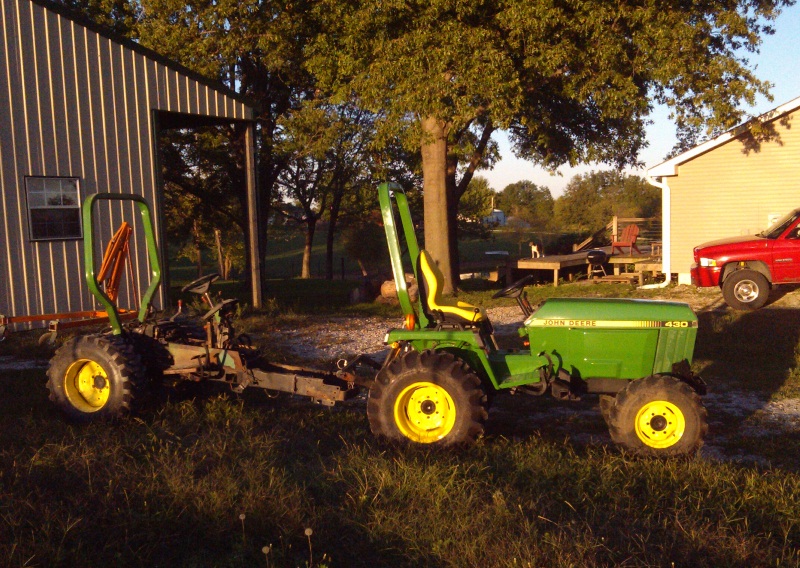

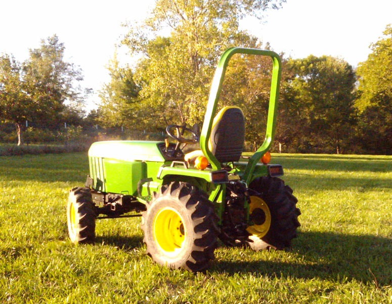

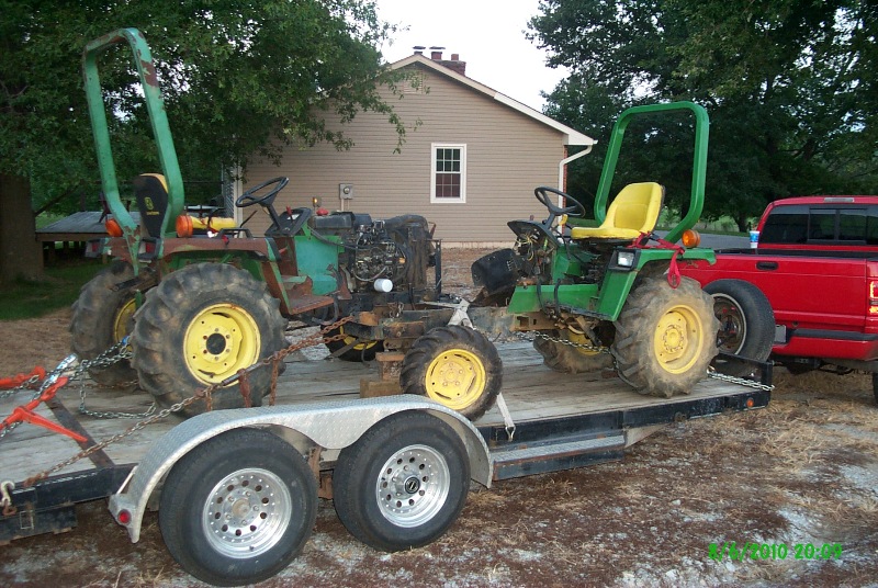

A little backstory...
Two years ago, I purchased this rather pathetic looking partial 955 that also came with a partial 855 parts tractor.

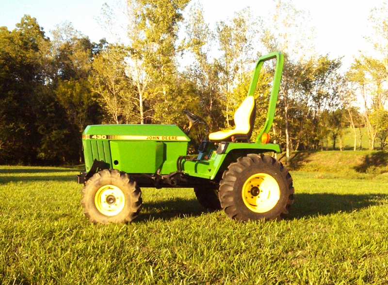

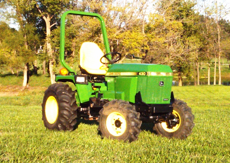

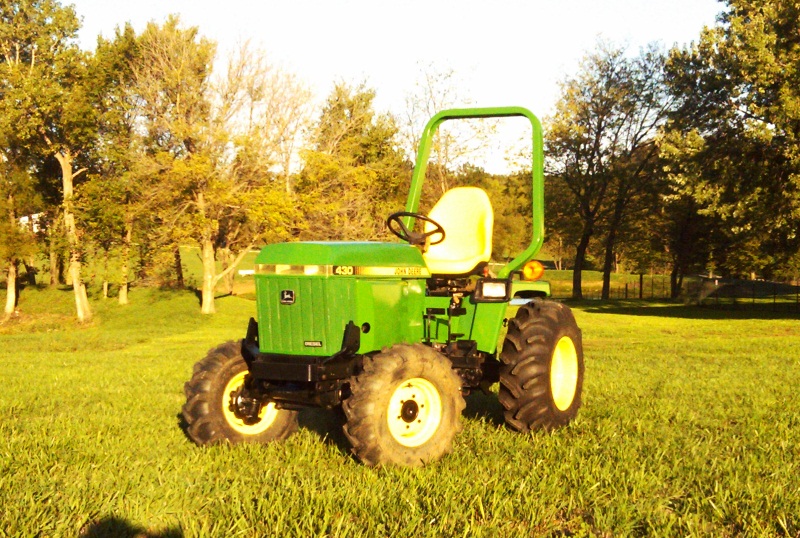

I was able to make a runner out of the 955 and began to use it in it's disgraceful condition while I set about locating and acquiring the pieces needed to put this 955 back together properly. Along the course of the last to years I scoured craigslist, ebay, etc. and slowly accumulated the all the parts. One of the things I bought was a 70A loader that came with another 955 that was pretty much stripped from the operator's station forward. I started going through this second 955 fixing and replacing things, painting body panels, etc. until I reached the point where I needed the engine out of the runner I'd put together. That was about 2 1/2 weeks ago.
So, I pulled the runner along side the the other frame and began tearing it down to pull it's engine. The enging was cleaned up while it was out and transferred over the other frame and I began reassmebling things. Here are the results:
2012-09-18_17-55-58_589.jpg 2012-09-18_17-56-50_5.jpg 2012-09-18_17-57-52_665.jpg 2012-09-18_17-58-17_111.jpg 2012-09-18_17-58-46_105.jpg 2012-09-18_17-59-39_823.jpg
And here's a pic of it's first office task... towing the remains of the "old" tractor out of the shop to make some room.
For those of you that wanted pictures... I hope this satisfies your desires.
   / Swapping tractor with my engine #20
Re: A little backstory...
Very nice. Thanks for the pictures. But why does the decal say 430?
