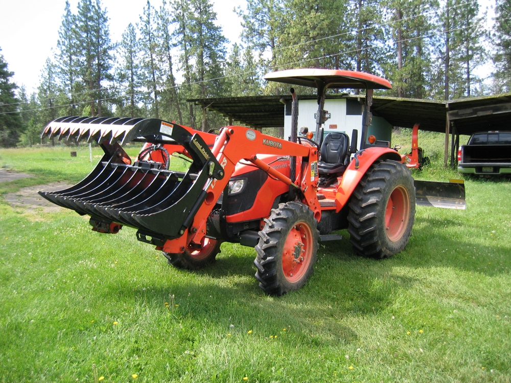

I think your decision on "types" is valid. I choose a rock/root grapple. I have little to no brush. My land is all open stands of Ponderosa pine and fields of bunch grass. Either grapple would function, for you, well.

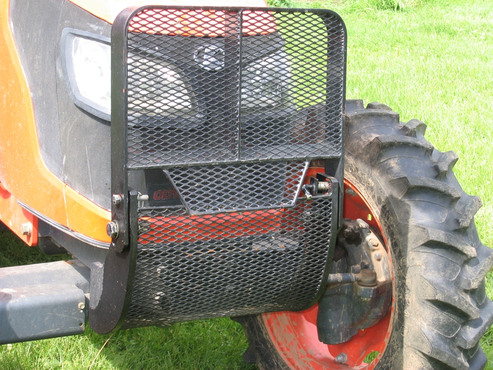

Consider this - do something like I've done - BEFORE - you add a grapple. Sticks, stobs and limbs have a nasty way of finding your grill, radiator and battery. Expanded metal added to my OEM grill guard.

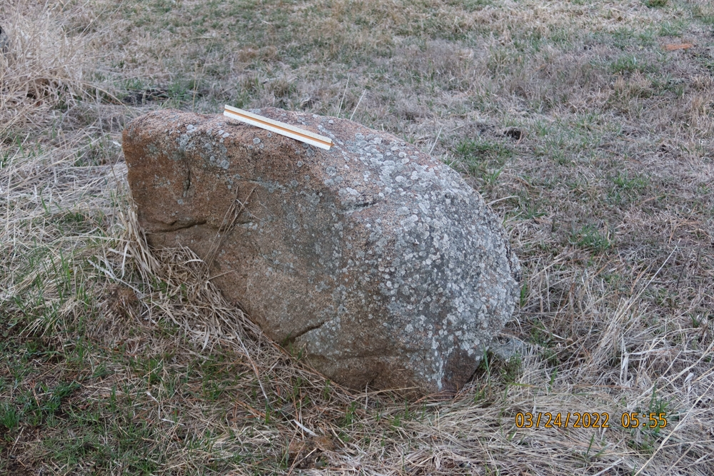

If you keep your load low( knuckle dragging) you can move remarkable objects. The rocks - 2400 to 2600 pounds. The chunk of pine trunk weighed 2400 pounds when I moved it( it was green). Just be VERY CERTAIN of your path and keep it LOW. I have, on occasion, moved both rocks and logs weighing over 3000 pounds.
Just keep any load within the limits set by your FEL weight charts. Load distance forward of the pivot pins and distance off the ground.
View attachment 738783View attachment 738784
Great point. I have a nice grill guard all lined up. (y)
