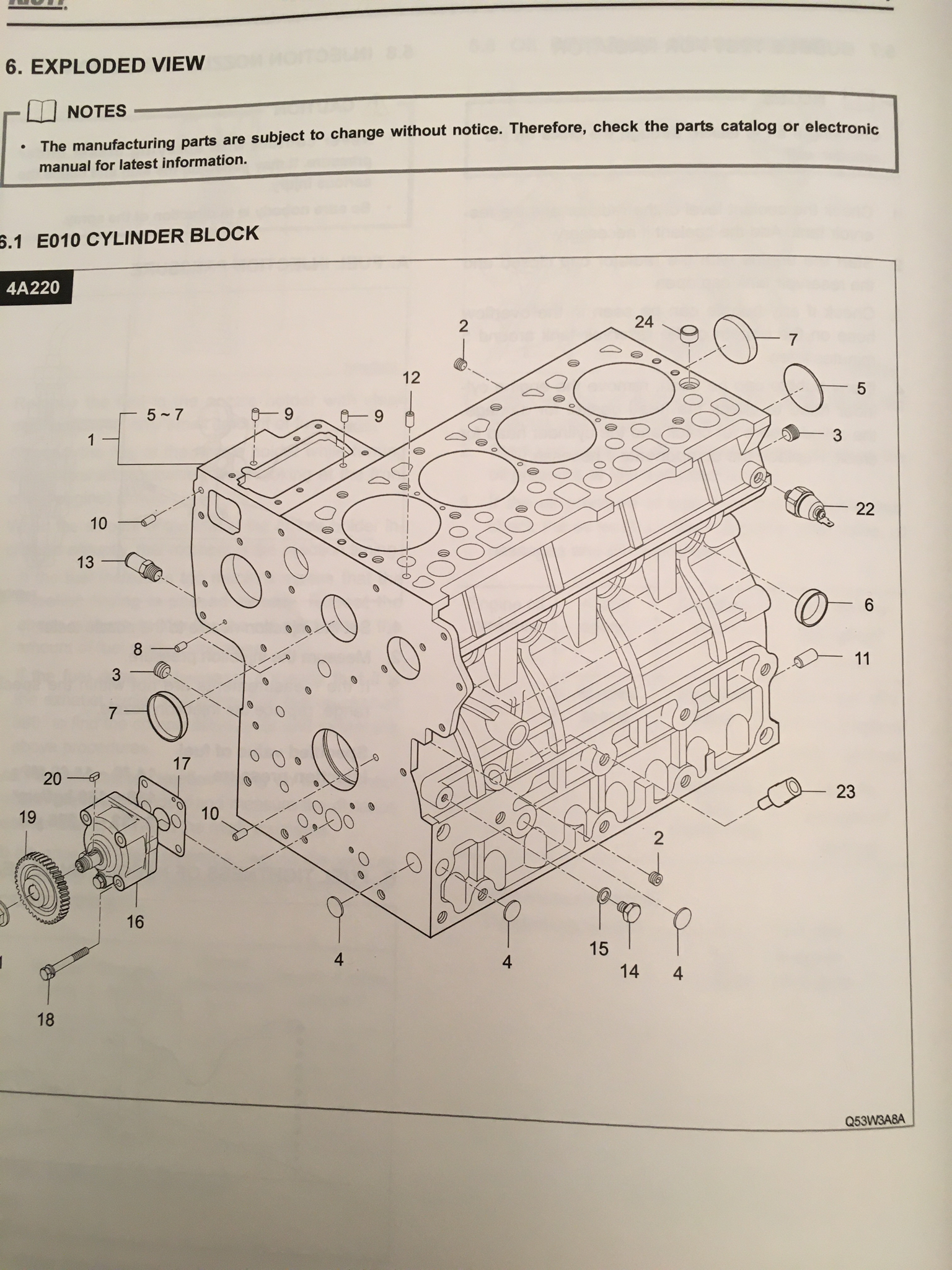

I notice when my tractor is in the garage there will sometimes be a very small amount of antifreeze on the ground under the engine. It seems to happen when there is a big swing in temperatures outside ie. hot to cold or cold to hot. Is this normal. Coolant level is never noticeably low. Kioti DK40se

What does a freeze plug look like and where would it be located?
   / Sweating Antifreeze? #4
Item number 6 is a freeze plug, although Kioti calls them “caps”. There are three on each side of the block. They are small metal disks pressed into the block at the water jackets.

It appears to be from the very bottom of the water pump. Tiny leak. Can I just keep running it until it goes?
   / Sweating Antifreeze? #8
There's a weep hole in the back of most (if not all) water pumps. When coolant makes it past the internal bearing seal, it comes out that hole. Usually the leak gets progressively worse over time until it fails completely. I ran an old pickup for a couple years before it went from the occassional drip to total failure.

A leaking water pump is a sign of bearings going out. I wouldn't prolong replacing the pump. They can send a fan through the radiator. If you can get to the fan and wobble it about 1/4" at the blade ends, It's bad enough to change NOW. Don't wait until it empties your coolant. :cool:
