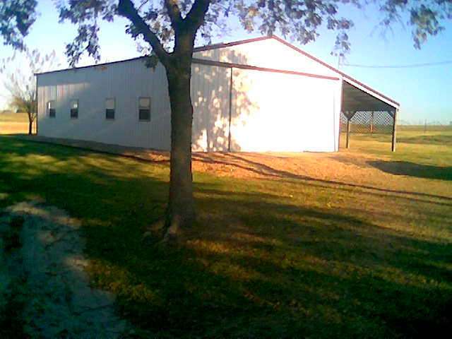

So my last wooden pole barn (30x30x10) didn't sweat at all, doors faced north and south. My new all metal building (40x50x16) with two doors facing west and one facing east sweats like crazy. Not really sweating but condensation, all over everything this time of year. Ill literally have beaded up water all over anything metal.
So my question is do you guys think a 1700 CFM exhaust fan would help? Should i mount it up high near the roof, midway up the wall?
Close behind the East wall with one door there is a creek bottom and a pond. From the West wall with two doors the elevation is all up hill. Should I mount the fan blowing out of the East wall so as to not pull in the damp air from the creek bottom?
Thanks for the help.

Anytime a surface is below the ambient temperature dew point it will sweat if the relative humidity is adequate to support it....iced tea glass, loaded tractor tires, tractors, sheet metal buildings. To sweat you need moisture in the air aka relative humidity up. If you had a roof vent at the peak, natural convection would vent the air out of your shop. This helps to reduce the condition and is a recommendation. I had bubble roll insulation applied to my new barn prior to steel sheating to prevent this problem which it has. The ridge cap also has 10' vents every 20'. Floor is concrete with a vapor barrier between the concrete and cushion sand. Seldom do I have sweating of anything in the shop and when I do it's on a real damp day and you can see the water accumulate from the open door gradually moving across the shop wetting the floor and cooler objects.
The roof continues outside making a 15' overhang (uninsulated) for protected parking. Moisture runs down the sheating big time and when it gets to the wooden purlins, it accumulates and drops down on whatever is below.
I don't know if a blower (located high on the wall, would work or not but if a roof ridge vent works then why wouldn't a blower....same principle only forced vs natural convection. Only thing I think you would need to do would be to not turn it on with humid days, keeping your door closed as much as possible till the humidity dropped. Use it/them after the dew has burned off things or on non humid days. I usually keep my doors closed if not immediately in use on humid days and it really helps in keeping the floor and things inside dry.
On your location, yes you want to pull the drier air into the building so you want to pull from the hill side. 32000 cu ft at 1700 CFM = 18 minutes to replace contained air. I don't think I'd use up power and listen to it run all day. Turn in on half an hour before you close shop or better yet, turn it on around 2-3 pm when the air is dryest. On humid days leave it off....do more harm than good.
