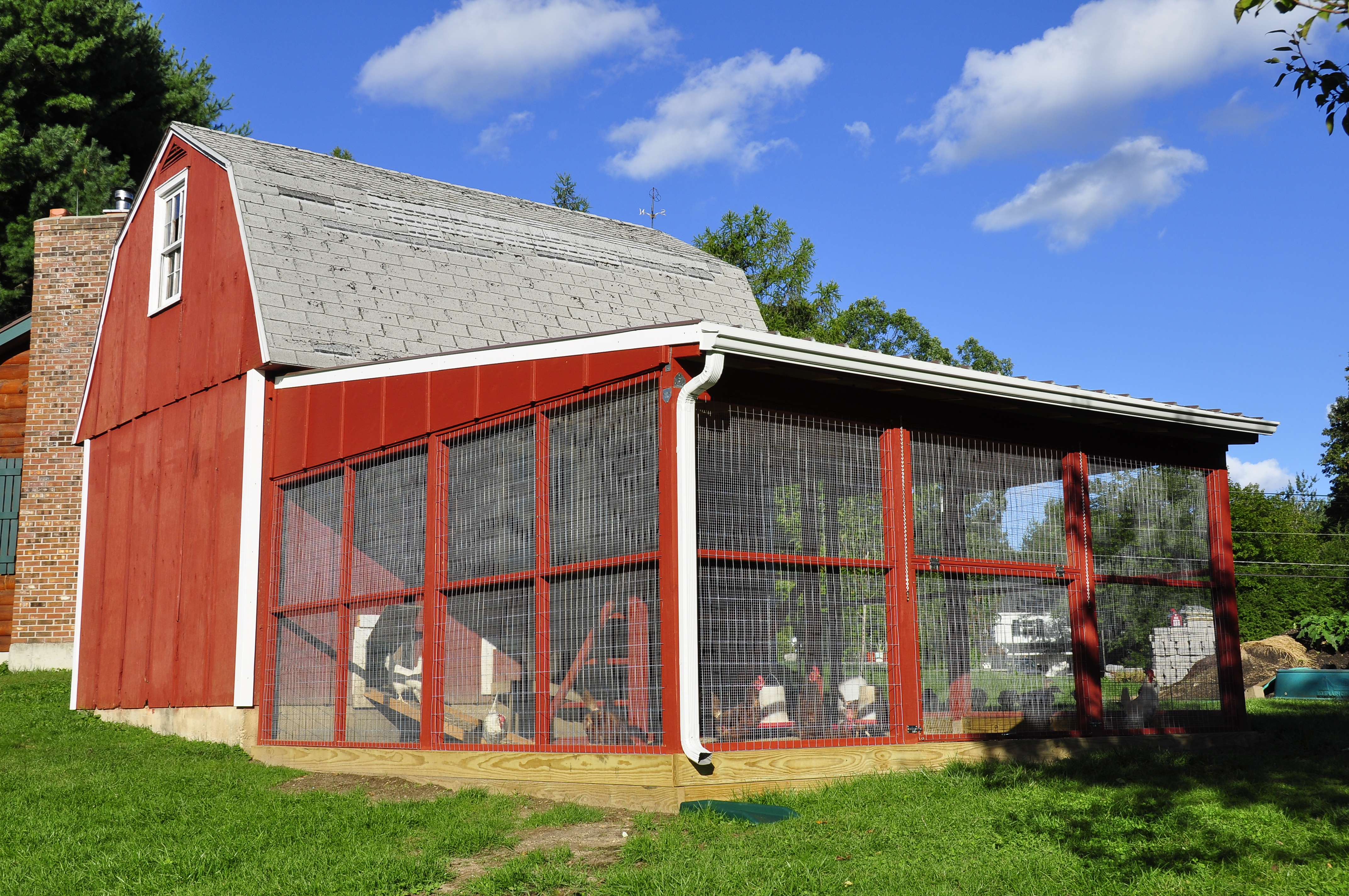

Questioning the balancing the temp issue. I have a chicken run as a lean to off one side of a large shed. The roof is metal and the sides are open but have fencing to keep the chickens in, predators out. I get condensation all the time on the metal roof. Since the sides are open, the temp inside is the same as the outside temp. So I don't have a venting problem or an unequal temp problem. But I get wet roof many mornings.
My experience with this metal roof is causing me to shy away from a larger lean to off my barn that I will use for equipment storage - camping trailer, 6x10 trailer, car transport trailer plus zero turn, lawn tractor and wood splitter. I don't want water dripping down causing rust on the equipment. Seems plywood and asphalt shingles don't have this issue.
The metal holds the overnight temp longer than the ambient air as it's displacement is heavier, requiring more energy to heat and adequate convection heating in this case, for it hasn't occurred. It's cooler than ambient air, moisture in the air condenses on the cooler surface. As I said, I have the same problem with the leanto on my shop.

The problem I have is the humidity all winter long in CT is 60-100%. Right now it is 30 out with 89% humidity. Heating the equipment shed is not an option. So should I avoid a metal roof knowing I don't want condensation dripping on everything? The inside of my barn never has the condensation issue, it is a typical New England barn built of wood in the 1800's.
You should avoid a metal roof exposed on the inside. Glue/spray a thin layer of insulation inside and a metal roof should do fine. Like slipping a cold pop can into a koozie.
