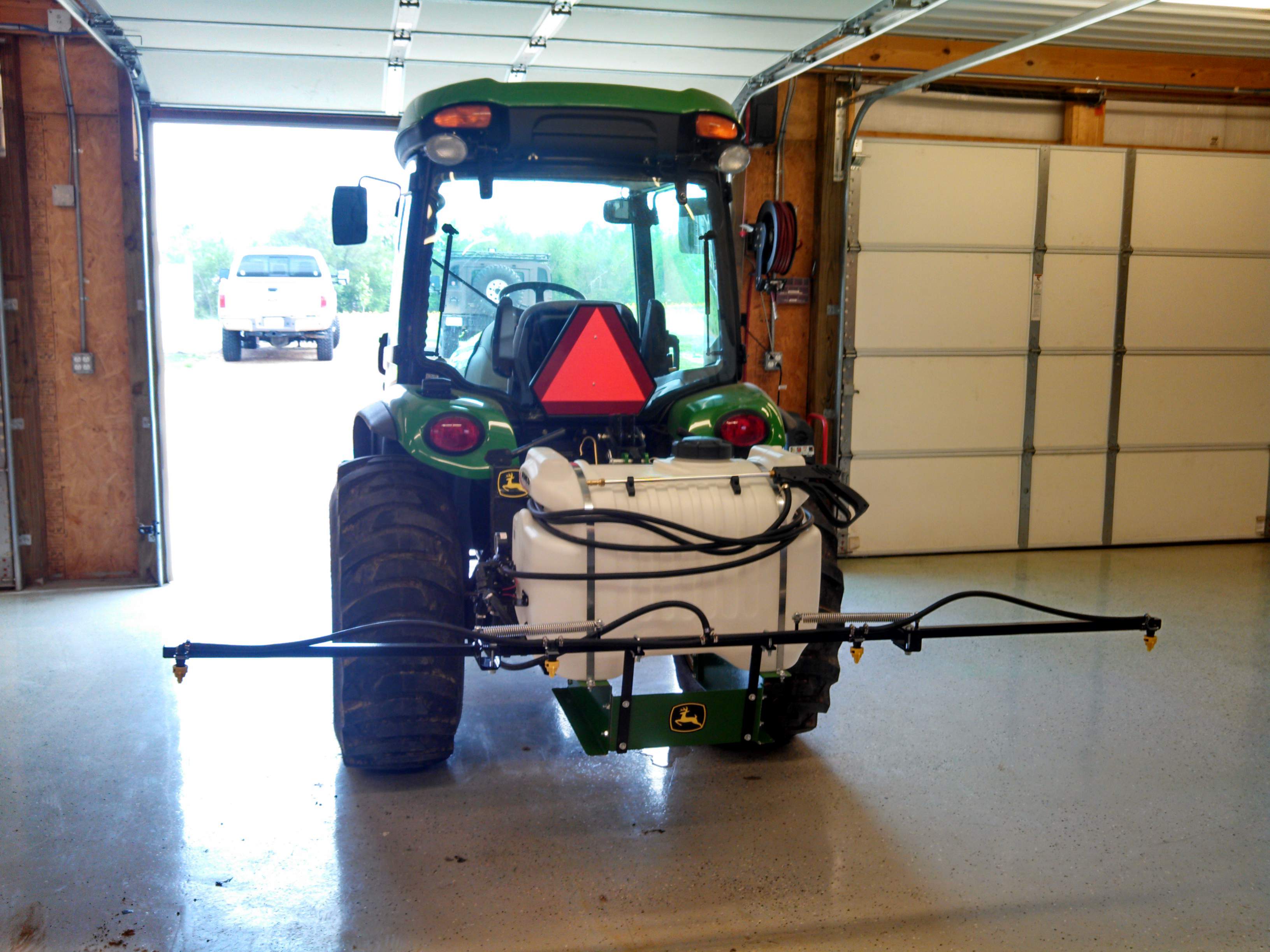

pictures

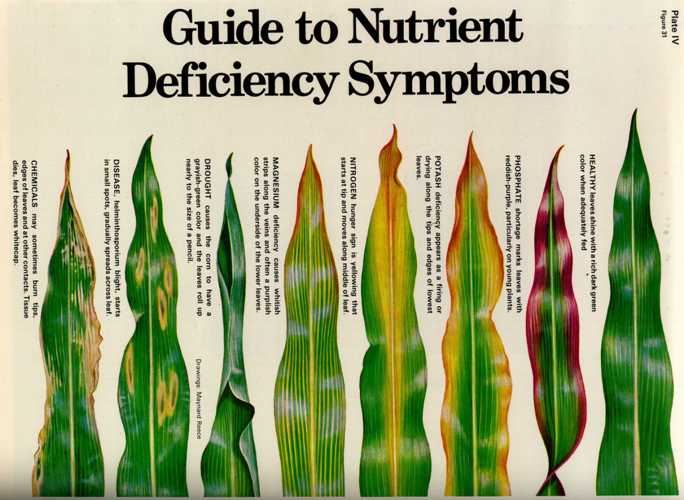

I don't know if this picture attached or not but this will give you a general idea of what you corn is needing based by looking at the leaves.
