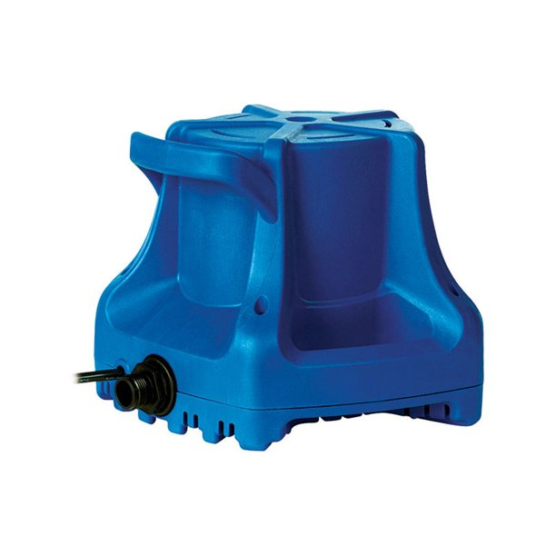

Anyone else have troubles with the so-called automatic swimming pool cover pumps?
They only pump down to about the depth of the pump, leaving a puddle to later freeze and possibly damage the pump.
I Gooped the 2 floats in the one I got from Walmart in the "up" position and use it in manual mode. Pumps the puddle dry.

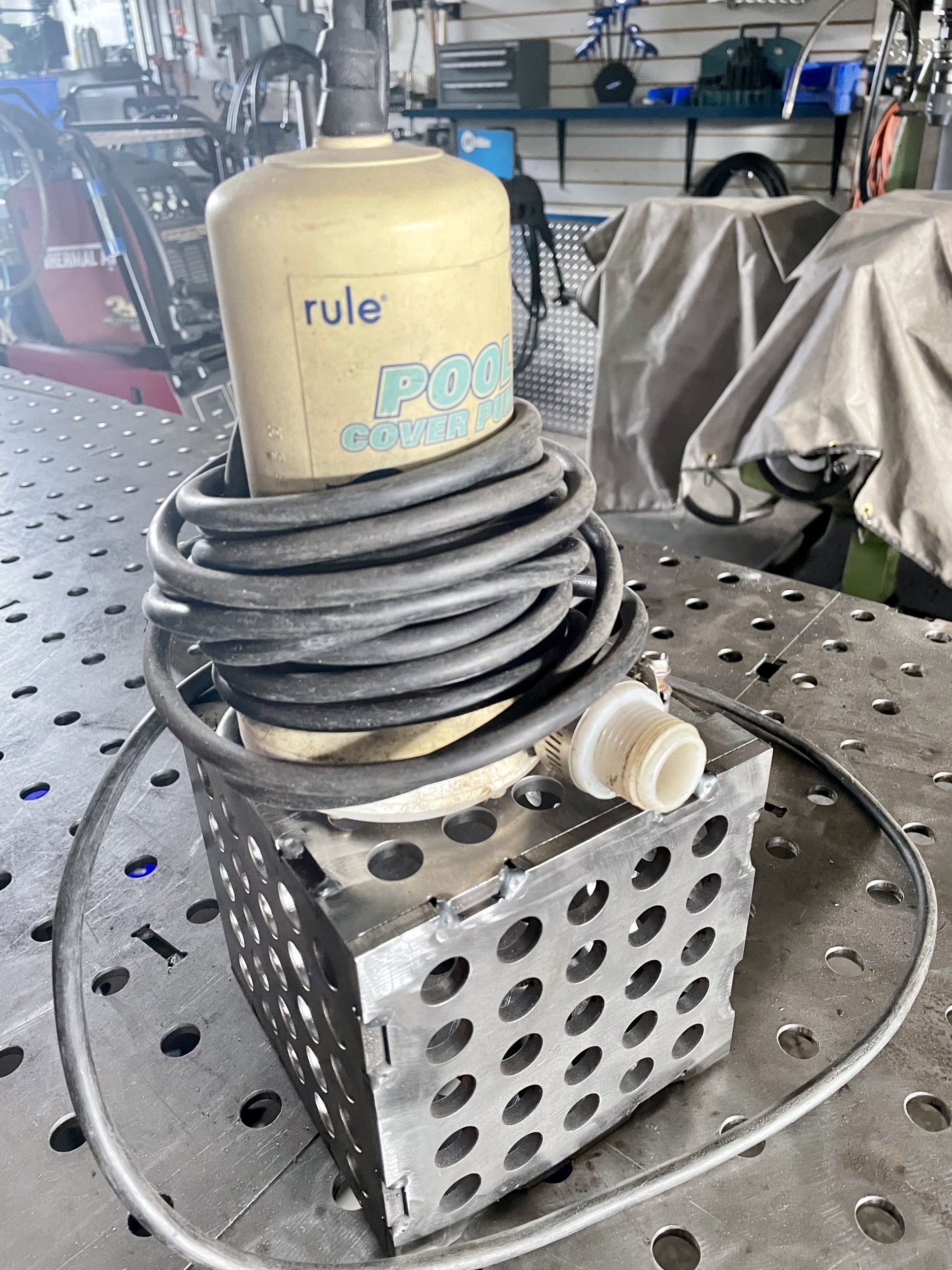

I went through two of these pumps in 16 years
They are thermally activated and will automatically pump down to almost nothing.

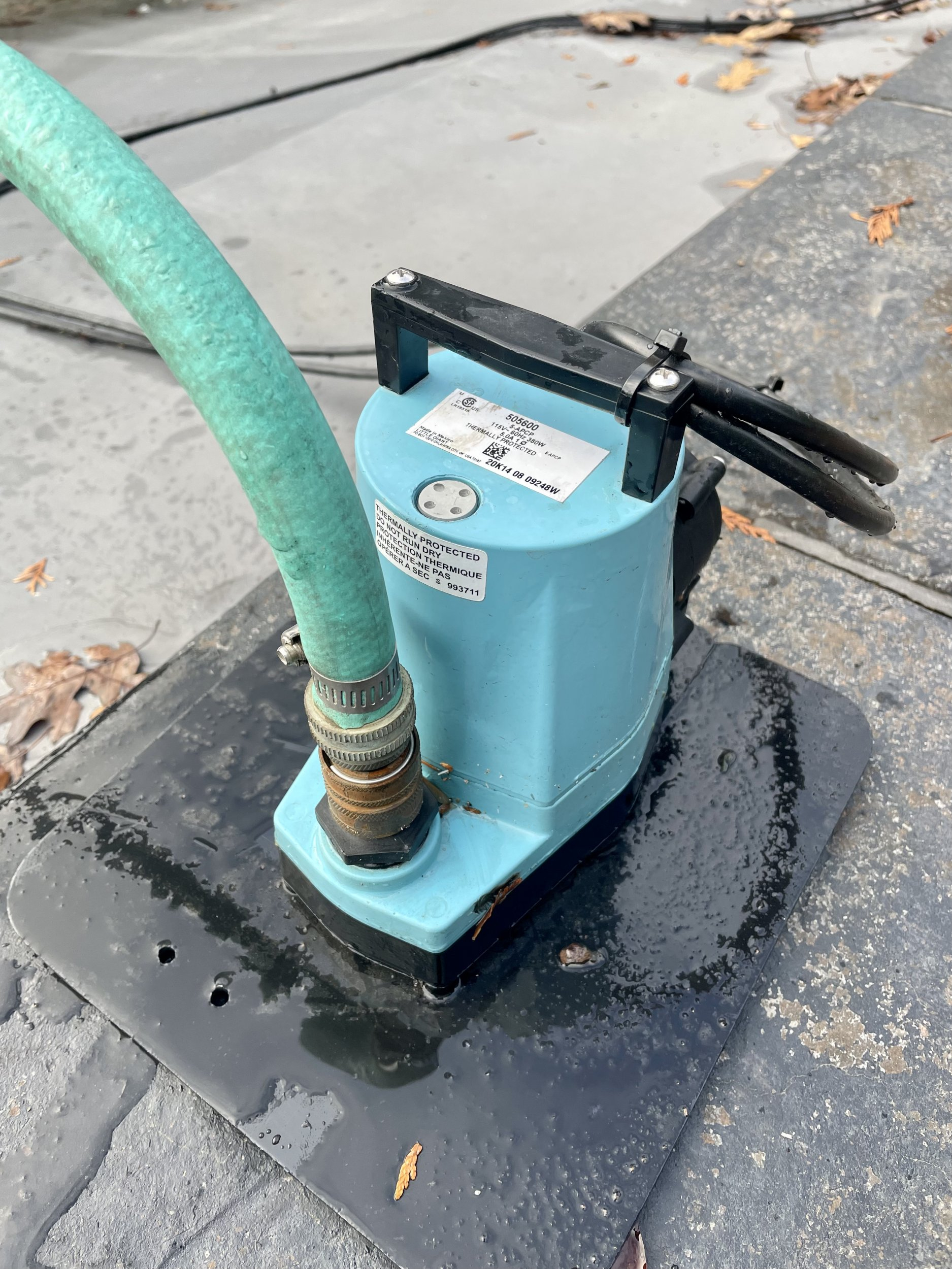

This spring I switched over to one of these with a float switch. You need to bypass the float and plug the pump in directly when you want ALL the water removed.

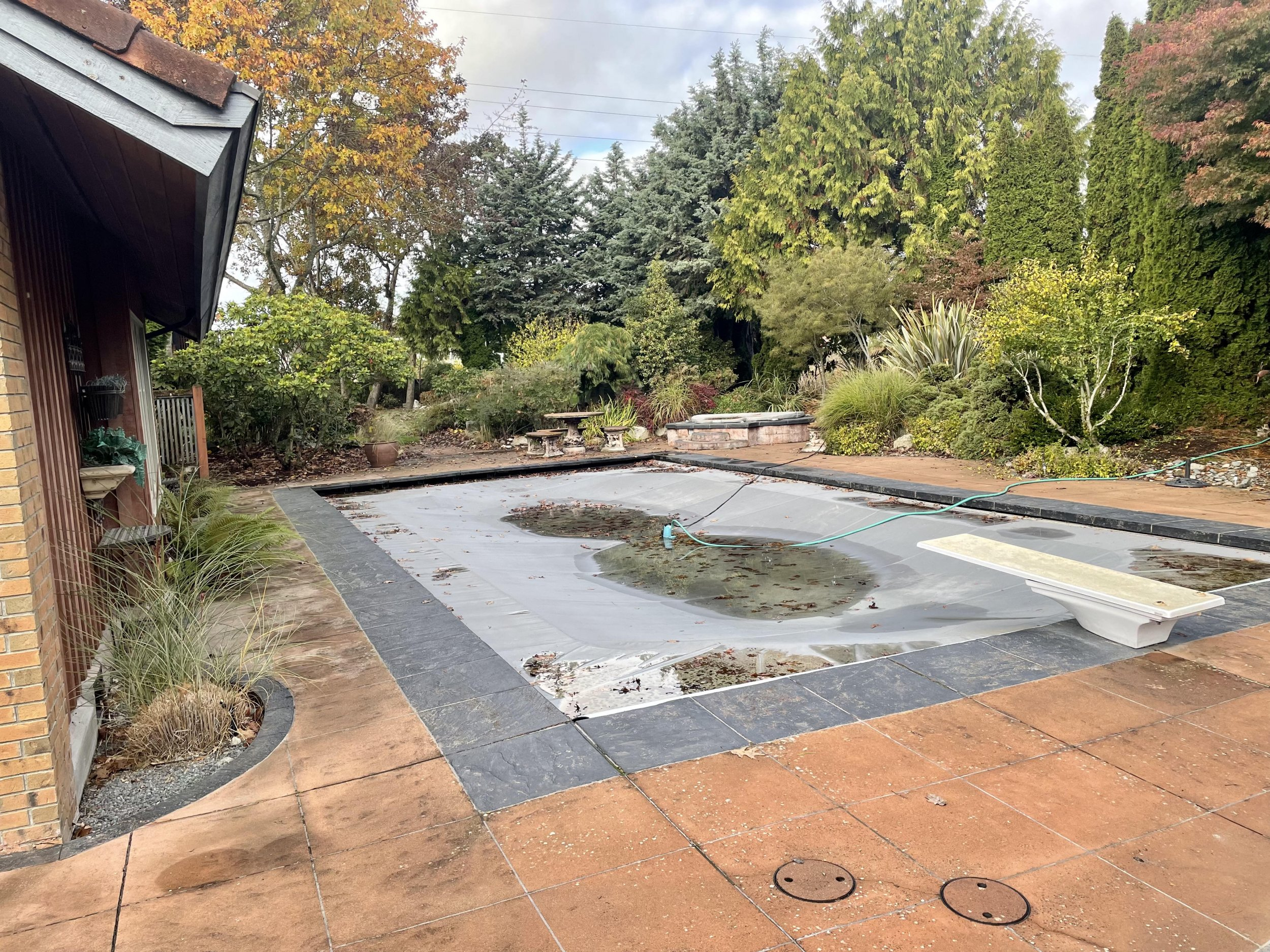

This is what it would look like on a typical off season day.....
