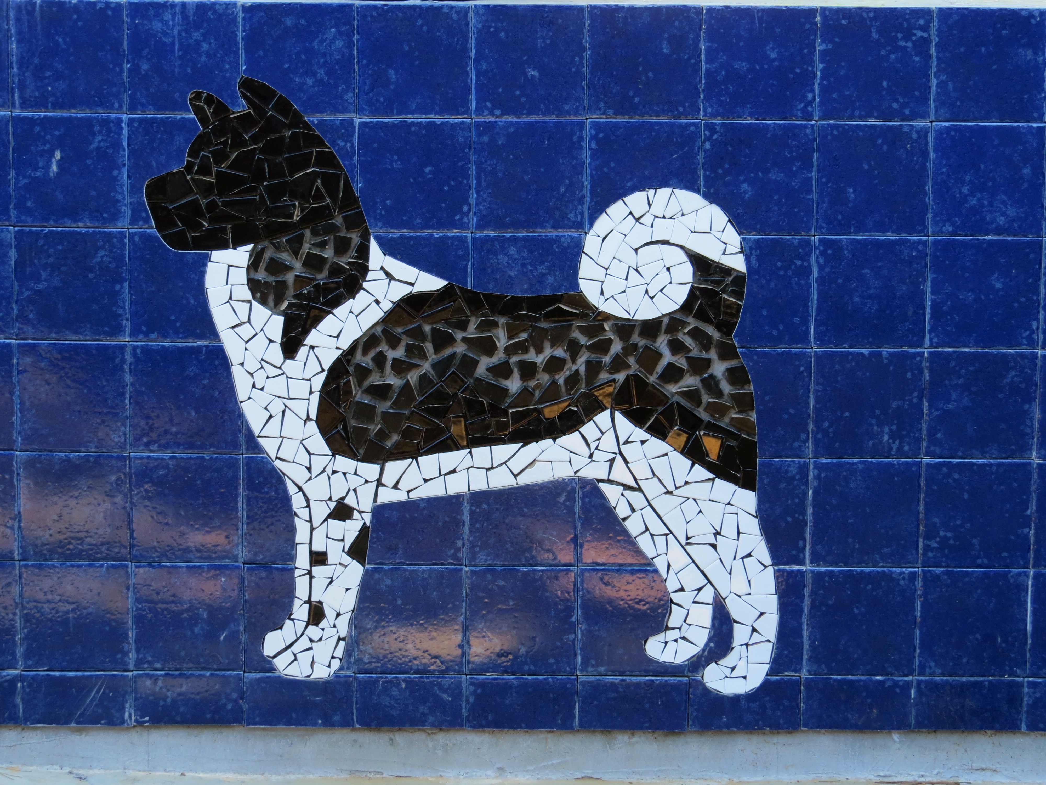

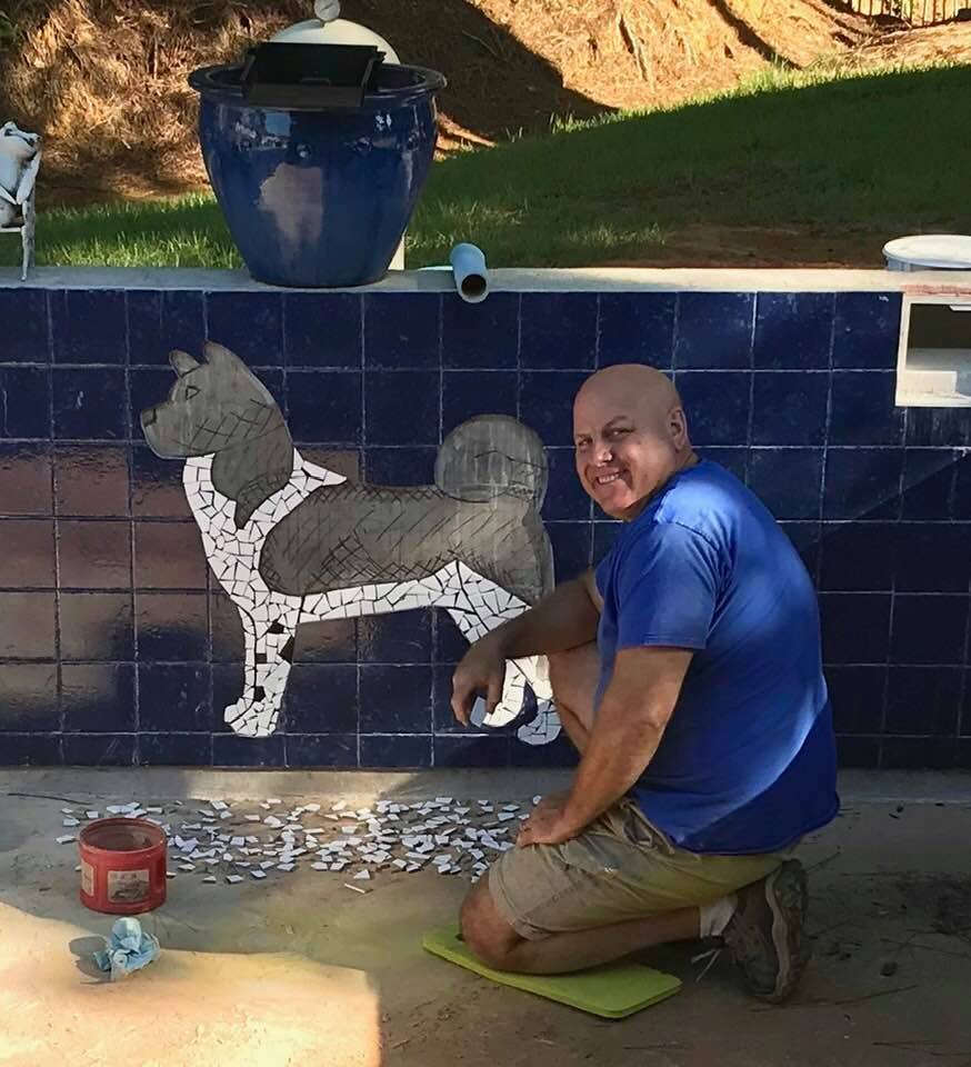

Gotta love that dog mosaic, Eddie!
   / Swimming pool - inside or outside #14
Thank you. We love our Akita's.

They are welcome to go into it, but they are not water dogs and so far, they have not tried to swim or cool off in the water. Mostly they use it as a giant water dish to drink out of, which is why it's salt water and not chlorine. Akita Pool is the name because of the mosaic I put on the wall.
