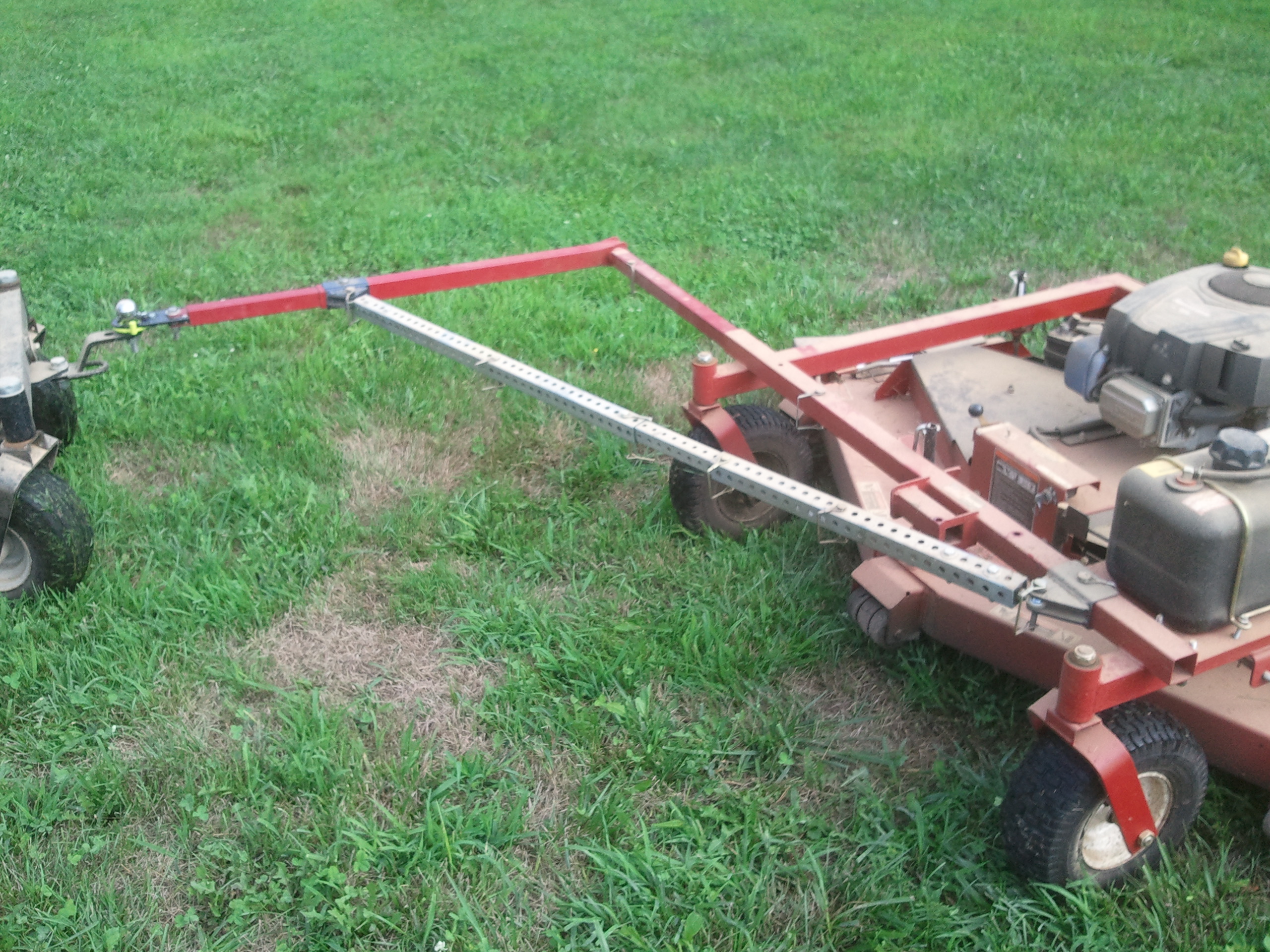

I had a 19hp 66" finish cut mower that I pulled with my zero turn to mow pastures. I had a blade break that also ruined the bearing housing and slightly bent the deck after I hit a stump or something. I just replaced the housing and straightened the deck and it was fine. I sold it only because I do not have as much to mow.
I did rig up a brace for the hitch which I found to be "springy". 2012-07-18 09.52.22.jpg
