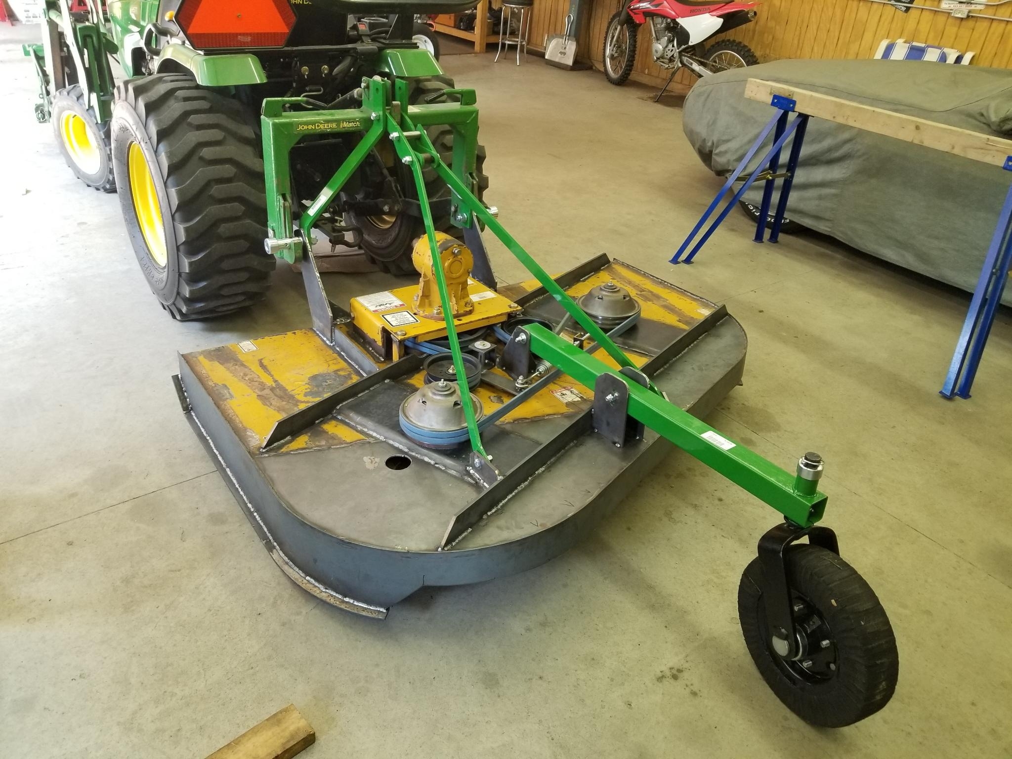

This problem has plagued me for years. What does a retired guy do staying up at night thinking about solving the mower/tire track issue??? He builds a mower!
A guy buys a beat up King Kutter 3-point finish mower and converts it into a 6' rotary cutter with 2- CCW 3' swing blades offset so they back-sweep BOTH tire tracks!!!
