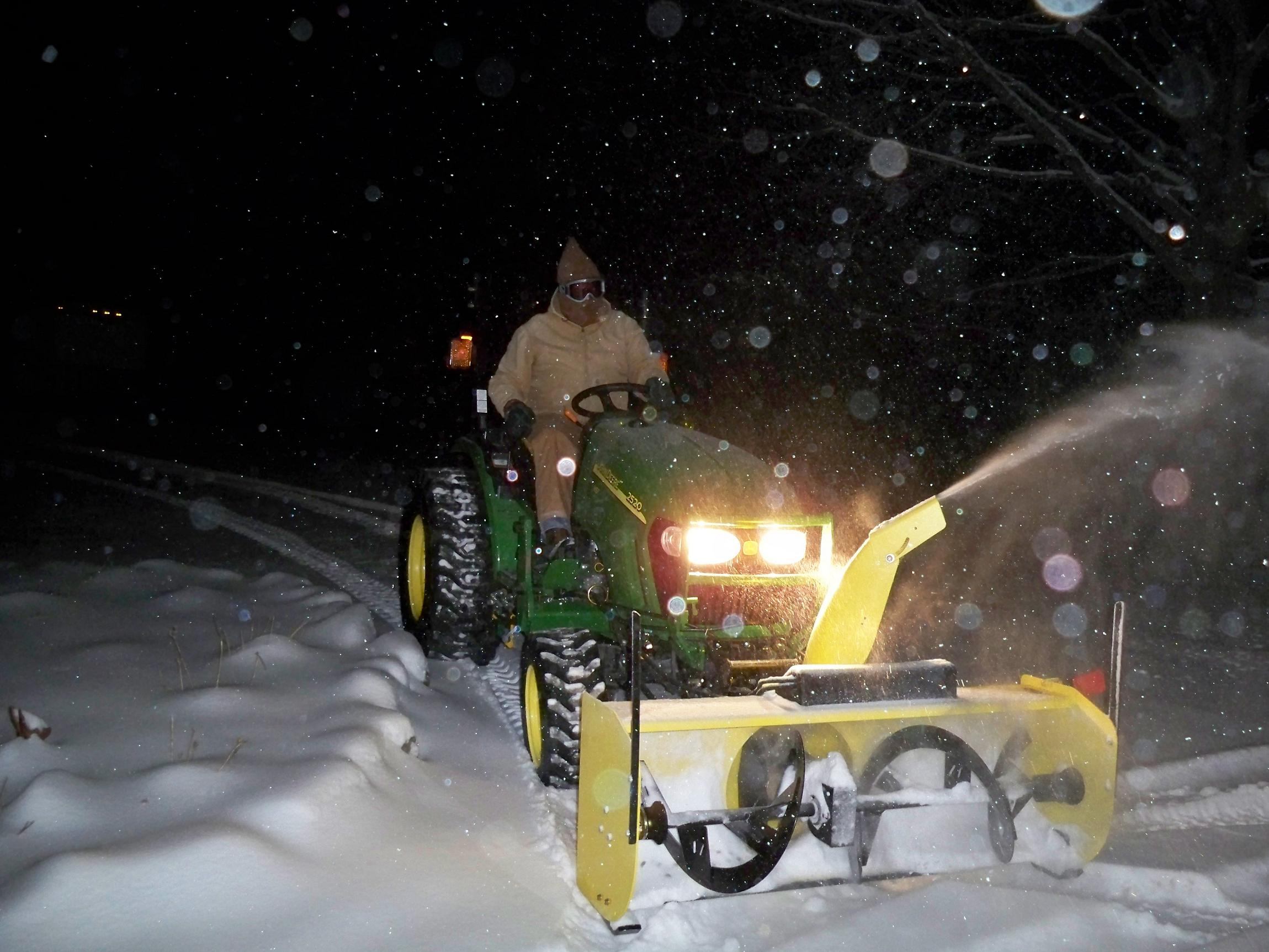

I just got the 54" snowblower this winter but when the dealer was showing me how to operate it he said I could leave all the hoops and chute control bracket on when I mounted my FEL. I haven't tried it yet.
