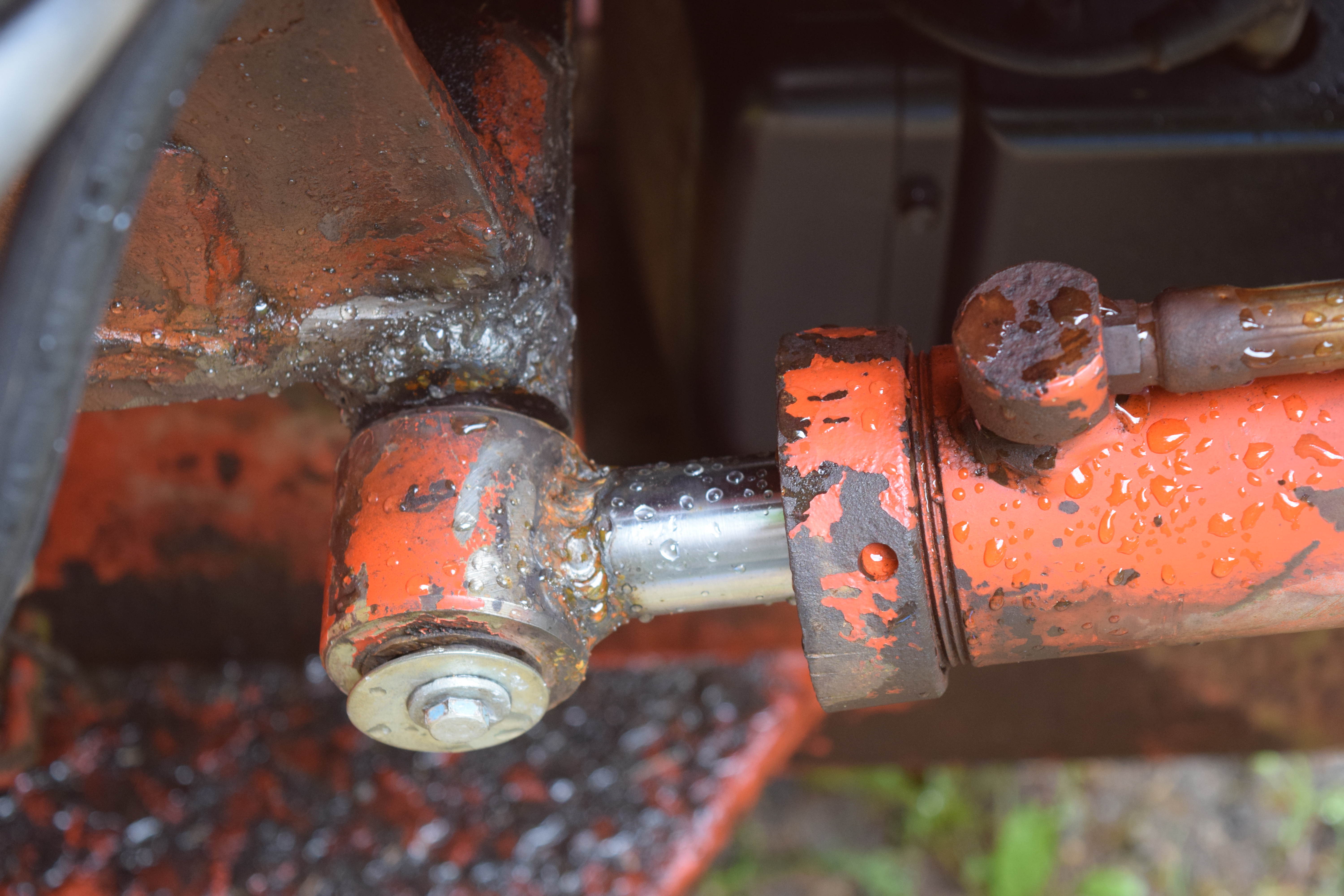

So now I think I understand.
I thought ALL NPTM fittings had a VERY small bevel on the end. Like 1.5mm wide while the swivel NPTF has a bevel width of more like 5mm. I have never seen a NPTM fitting, sold for hydraulic applications, with threads that go all the way to the end. I was envisioning two wide mating surfaces like JIC. I apologize for the confusion.
I knew I should've kept my mouth shut. :D

NPTF MPX
Luke if you look close at the pix of a MPX you'll see there is no 30 deg chamfer inside the ID

Thanks for the help guys. Turns out that the hose fitting all have the small i.d. chamfer so looking good. I saw that Tractor Supply had them and went there tonight; they had only one in the store. I'll try NAPA in the morning. I'll post pix soon.
