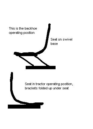

I just picked up a locking swivel seat base at the marina up the street from my office today. It was only $24.26. I want to mount my tractor seat on it. I'm planning to remove my standard seat & base from the frame, install a couple pieces of heavy C or tube stock there then mount the swivel base on the C/tube stock a little further away from the dash than the stock seat base placement. Then I'll mount the stock seat and seat base on the swivel base. That will give me some more legroom when the seat is in the full back position on its tracks by positioning the seat both higher and further from the dash.
I'm going to use the swivel portion when I operate my backhoe. My plan is to simply eliminate the backhoe seat altogether. When I want to use the backhoe I'll simply swivel my tractor seat around 180 degrees and have a backhoe seat. /w3tcompact/icons/clever.gif
I'm going to have to play around with the seat placement before I permanently mount anything to the bar stock. I need to be able to slide it into a position it so as to be comfortable operating the tractor and be able to swivel it around and postion it so as to be comfortable operatin the backhoe.
I don't know if this is even possible, but I'm hopeful. I think it'll probably be a situation of setting the seat all the way back when operating the tractor and all the way forward when I swivel it around to operate the backhoe.
I'm also going to have to make certain it can be swiveled around without rubbing the fenders. Now, this might not be a challenge for some of you engineering types. Please remember, though, it's a poor social science major who's going to be doing all of this. I'm more than open for any suggestions as to how to make certain this works out OK. /w3tcompact/icons/smile.gif

Gary, I'm not familar with the seat position on your John Deere. You might take a look at the Kubota BX22 as it has a seat that swivels for backhoe use. The seat raises about four or more inches in the backhoe position. Let us know how it turns out, maybe a change I could do also. Good luck!
   / Swivel seat base
I hadn't planned on adding the 4" rise. I considered it but douldn't come up with a way to do it in one simple move.
Do you know if the Kubota operates on a screw base or exactly how they do get that rise out of it? I'd be curious to know how they do it.
   / Swivel seat base #4
Gary,
The Kubota seat on my L35 has two ranges of motion. In addition to swiveling it swings back and forth on a frame shaped like a parallelogram. The rear swing stops at a lesser angle then the front, that's what gives you the rise. The swing also moves the seat position back and forth about 6 inches to get you closer to operator controls. The frame is spring assisted to help with the weight of the seat and there is a self engaging metal finger which locks the seat in the fore or aft position.
All in all, a pretty ingenous arrangement, and more complicated then you would first imagine. I could take some pics of the arrangement if you want to build something like it. It could be done if you've got the right fabrication equipment.

   / Swivel seat base #10
Gary,
I got to thinking that maybe you'd like the seat a little higher when operating the backhoe. Look at the crude drawing I did. The seat pulls up and hinges back, then swivels.

   / Swivel seat base #12
Dave
Thats about what I had in mind when I did the drawing...../w3tcompact/icons/grin.gif
   / Swivel seat base
#13
Well, in going out to actually start this project yesterday I discovered a couple things. First, the day wasn't nearly long enough to get everything else done AND do this, too. Second, in looking at the tractor seat level and the level of the base for the backhoe seat I found about a 5-6" height difference. Now it's not a matter of IF I want the seat at a higher level for the backhoe as it is how to get it up there.
I'm going to have to do more than a little additional engineering on this to make it work now. The spring loaded pipe idea won't work for a couple of reasons, not the least of which being that I need to move the seat further horizontally than the seat track range would allow by itself.
The method on the drawing and in the pictures seems like it's a lot closer to what I need. I'm going to try to scavenge some heavy angle iron for the pieces I'll want on the very bottom and at the bottom of the seat base and then try to use something like square tubing for the two moving pieces.
