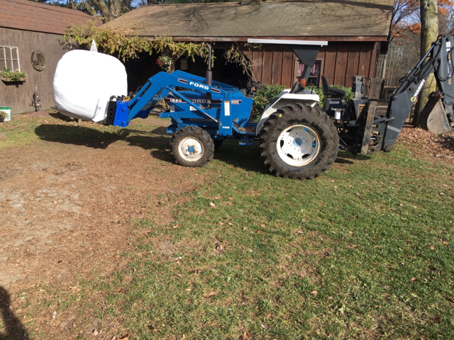

I put a SSQA on my 32 hp Ford. Love it switch from bucket to forks in a few seconds. It did not take away much from lift capacity. Here is a picture of me moving a third cut silage bale. It weighs probably a little over 1,000 lbs. From what I can find my loader is rated at 800 lbs to max height. IMG_1478807154.325635.jpg

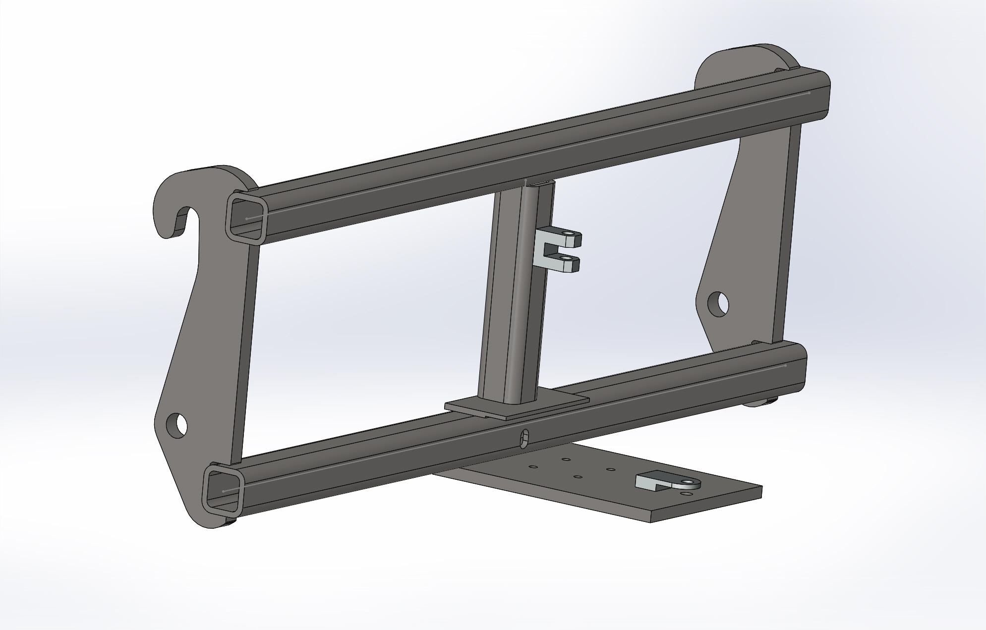

I have a .dxf file of the quick attach for the cl200 loader for the sx3100. It is the 2 ends on the bucket that hook on the loader and you slide the pins thruogh. with this file you can have someone waterjet or laser out the brackets. the dxf is attach to this post as a zip file. I made a quick attach for my snowplow, so these brackets have notches drawn in for 2 x 2 tube but you can ajust for yourself. remember when welding that they will move around so be careful welding so they still line up when you are done.
Bumping an old post from the dead, but I was hoping someone still had the .zip or .dxf that was originally posted here. It looks like the only thing attached now is a .jpg.
   / SX3100 quick attach conversion ?? #13
here you go, adjust to your needs ..... well apparently can't attach dxf files
