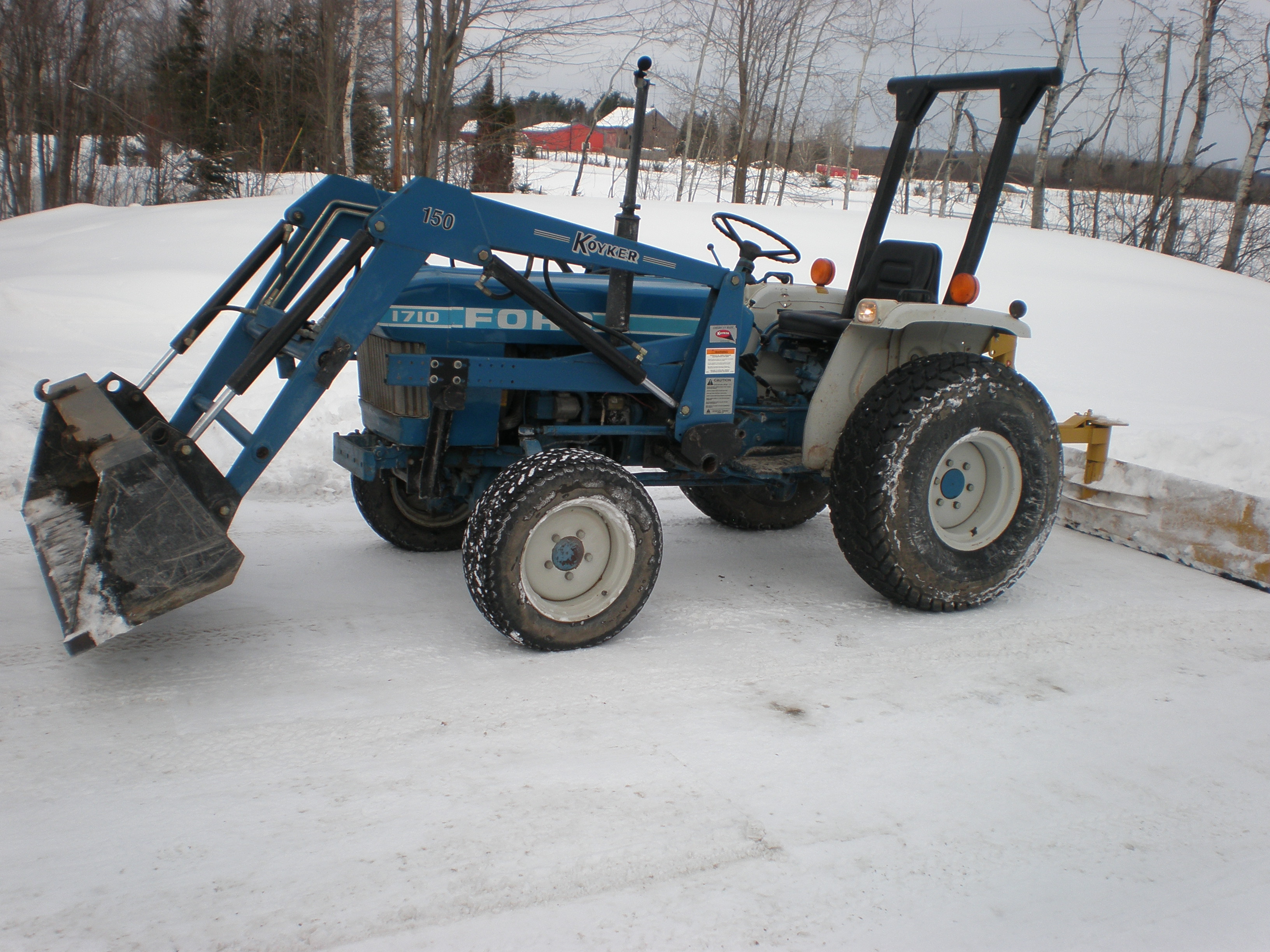

Look's like your building same tractor as I have, I can only speak on the syncro and I really like mine..I wish you lived around me-would like seeing it progress, keep posted with pic's if ya can..good luck. tractor 1.JPG

thanks BigDog1956, your tractor is just what I want but with ag tires. won't be pushing snow lol. Not good on the computer so I don't know about pics. Hope I can get some feedback on the non syc. trans.
