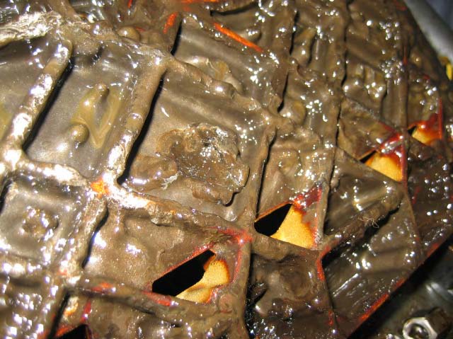

cp1969, as per your request. Here is a nice picture of the windage tray and main bearing from the inside of an '02 Dodge Intrepid. Owner has changed oil every 5500 miles; has receipts. Major engine failure due to lack of lubrication directly due to (jelling) sludging of motor oil plugging oil journals. I knew I'd get a fresh pic today; it happens every single day.
By the way, I'm not just picking on Dodge Intrepids. That is just the photo that came across my desk with a report today. It happens thousands of times each day across the country. With the facts I have, I still stand by my statement that I'll use a quality synthetic oil in every engine I own that is worth more than the cost of the synthetic oil it takes to fill it. /forums/images/graemlins/grin.gif

Yep, that looks nasty, although it isn't really clear to me what I'm looking at. I don't see a main bearing. It almost looks like a waffle iron. That brown stuff is not what I'm accustomed to seeing as sludge; sludge is very nearly jet black.
Now, though, the $64K question: This won't happen with synthetic? Had this fellow been using synthetic, this engine would not look this way?

Question? the car this pic came from, by the looks of things it was a short distance city driven car? Sludge build up usually indicates this, since city driving is murder!!
My 2 cents............... My 1982 GMC 1500 was driven short distance for a number of years, and I let time, not KM's ( milage ) dictate oil change intervals. I later sold the motor to a friend for a 1938 chev truck, and when they took the intake off to put an aluminum one on it, the inside looked new!!
This is often one thing we dont see in the hot debate of dino versus synthetic oil, driving distance from point A to point B everyday.
Only my 2 cents though, not meant to get anyone mad!!
What year was the intrepid?

I'd mentioned before, the pic is of the guts of an '02 Intrepid. Attached is a news article about the VW problem. I'll attach a pic in the next post about Chrysler. I have one on Toyota, but can't put my hands on it right now.
The issue is NOT related to highway or city driving. It is related to certain parts of the oil passages being "super heated" and causing the oil to break down. The oil companies say that it is a defect in engine design. The auto manufacturers claim that it is a defect in the refining process. Either way, without going into more than I can regarding my business, oil problems happen every day by the thousands.
After much research, synthetic oil does not have the sub components needed to break down into "sludge". In other words, synthetic oil is chemically not able to break down into a wax or parifin or jelly (whatever you want to call it) that begins the end of an engine.
I'm not placing blame, I'm just reporting facts based upon a base of thousands of cases. Again, for the assurance that the problem supposedly physically cannot happen with synthetic oil, I'm going to use it. In the insurance business, it is known as cheap insurance. /forums/images/graemlins/wink.gif
