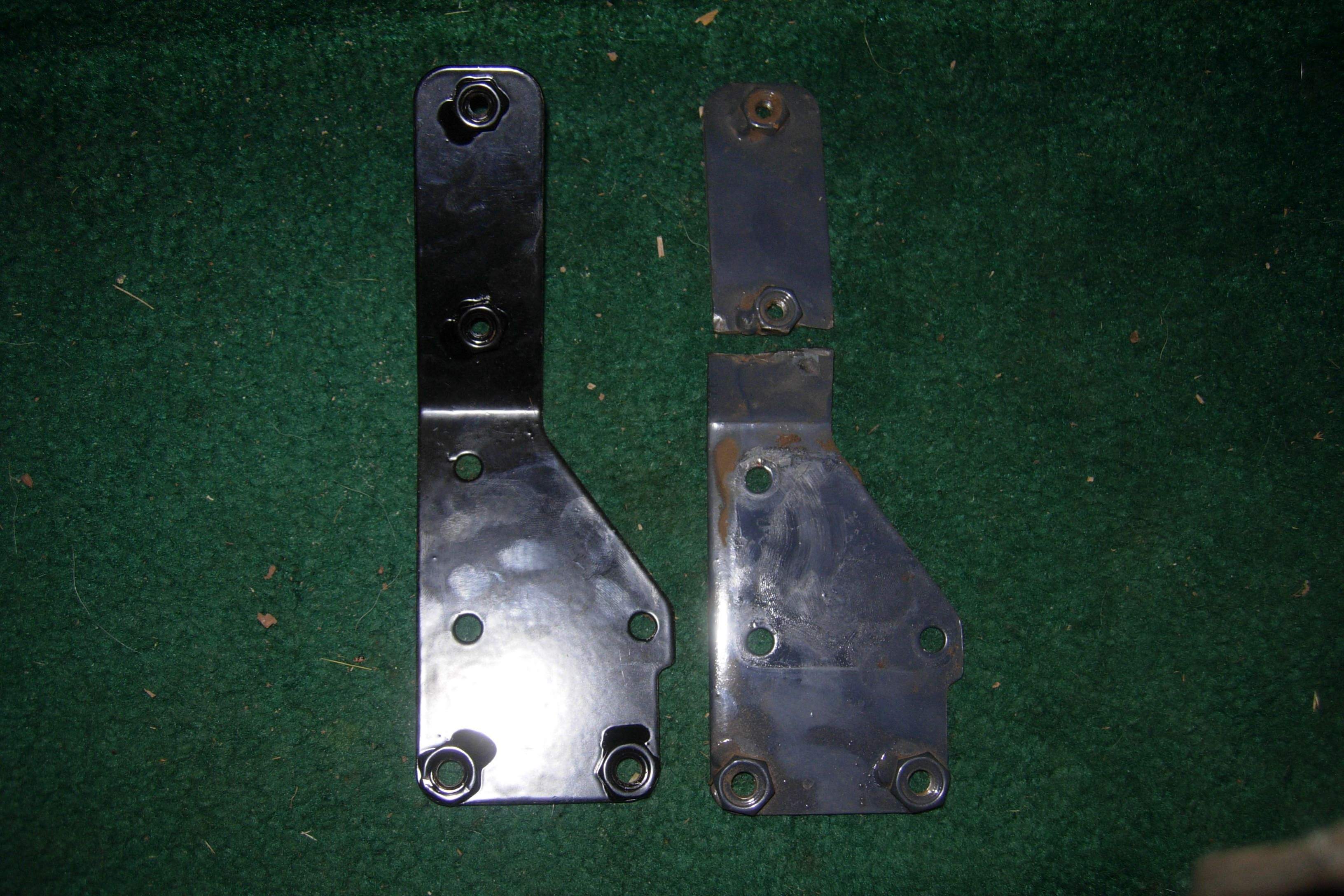

Just to followup and my earlier e-mail. I just finished installing my new fuel bulb mounting bracket. Looks like it's an identical part to the original. Close inspection of the backside (see pic) indicates that the break is occurring at a spot where a bolt is welded. I'm guessing I'll be replacing this do-dad again. Time to learn how to weld I guess. . . .:D
Pete

Hi all,
Same issue with my T273 re: the muffler and the fuel pump mounting bracket breaking. On the third go around with the fuel pump mount, although it is actually the first one that I welded back together along with the addition of a small gusset on the 'front' side (nearest the fan). That has been holding for over 100 hours now and doesn't vibrate at all. A simple fix that should be factory done. I had a discussion with a rep from TYM when the muffler and fuel pump bracket broke about re-engineering them. Apparently the muffler has been redone (I'm on the second version and it is working fine - I hear that they modified it a second time by adding some angle iron). Sounds like the fuel pump bracket has yet to be changed. Too bad, it seems to be a very common problem. I was told that it was an addition after production because the fuel strainer bowl was too low and hit the frame if mounted as it was engineered (notice the unused two threaded holes on the engine, beneath the bracket - that was the original idea for mounting directly - no bracket).
As for another vibration related problem, keep an eye on the hydraulic fluid cooler. Mine shook so bad at idle that the mounting stud broke off. Fortunately it was still under warranty (within 2 years of new). It is possible that mine was flawed by looking at it after the break but it does still vibrate a lot. Might have to weld that one up too.
I have a lawn tractor - the TYM T273 is no lawn tractor. I work it hard, and other than the above design issues, have had no trouble with it. It is amazing what you can do with it.
Have fun and if anyone gets an updated fuel pump mount, post it here. I'd like to see what they did to correct the problem.

Hi,
I just used a small piece of 1/8" steel and welded it along the edges of the fuel pump bracket. Of course I also welded the original break. Just be sure to keep your bead small on the back side of the bracket. It fits tight to the engine and there isn't a lot of space for a big ugly bead. Unfortunately most of my welds are big ugly beads so my best welding is done with a grinder. I'll try to get a picture posted here soon.

Thanks. Unfortunately, I don't weld. But, I do have a neighbor who be able to do something similar to what you've suggested. I also noticed that my replacement muffler/ mounting bracket included the addition of rubber grommets that are sleeved over the attachment bolts. I'm guessing these are there to further "dampen" the effect of engine vibration. I'm thinking about just adding a couple of O-rings/rubber washers to the fuel bulb bracket and see if it helps.

I would highly recommend the welding of a brace, even onto a new bracket. The grommets might help, but could also make it worse by allowing even more movement. One thing that happened when my bracket broke was that since the pump was flopping around in the engine compartment the fuel line got close to the fan and if I hadn't noticed it could have eventually ruptured the line. As it is there is only a small frayed area on the outer jacket of the line.
Hopefully the picture came out. The brace I welded on is the rust colored metal along the front (right side in the photo) of the pump bracket. Rock solid and has lasted for 100+ hours.
Good luck with yours which ever way you go.
Regarding the muffler, the only mod that TYM did to my version of the muffler was to change the lower mount (where it attaches to the frame near the exhaust end) from a hole with a grommet to a fork and grommet, open on the bottom, that allows the muffler to move when the frame flexes. That movement was what broke the muffler because it didn't have enough free play with just a hole and pulled the exhaust pipe. Something had to give. I don't know if vibration really played a part in it breaking or not.
Anyway, have fun with the 273. I really like mine for what I do with it.
