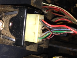

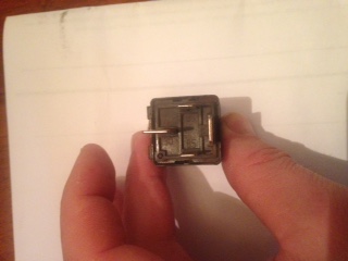

Hi all,
Been awhile, but I'm back. I'm the proud owner of a TYM273 tractor (circa 2005). About 6 months back I developed some trouble with the glow plug system. When I turn the key to the left (position 3), the glow plug "coil" indicator fails to light, and more importantly I no longer hear the timer ticking. These little L3 engines are a pain in the neck to start without preheating the block. I was able to confirm that the 15A fuse for the glow plug system is intact, though I also noted that when I place a voltmeter across the fuse terminals I don't register any voltage, even if I turn the key to supposedly activate the glow plugs (symptom? problem?). I also confirmed that the slow blow 75A fuse is also fine. Based on these symptoms I suspect that either the glow plug timer has died, or perhaps the glow plug relay? I pulled the relay - this is the little do-dad in-line just in front of the battery. See attached pics if you've never seen the relay before (I'm a visual guy). Unfortunately, I don't know of any way to determine if it's the problem. I have contacted a dealer, and I'm waiting on replacement part pricing, but I'm wondering if this is just a timer issue. Has anyone encountered and/or fixed a similar problem? As many of you noted the wiring diagram in the service manual is pretty poor. I'm just not sure if the relay is in front of the timer, behind it, or both. I'm willing to tear into the dash, but I'm not sure what I'm looking for exactly.
Any help would be greatly appreciated!
Thanks!
Pete

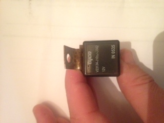

Quick followup:
I just got off the phone with a TYM dealer, and service provider in Idaho. He indicated that the "timer" sound is actually the fuel pump and that the glow plug timer is silent. He also indicated that the usual failure point for the glow plug system in these tractors is the relay. It's a pretty standard relay you can get a NAPA (part no. AR282). So, I'm going to pick one up over lunch and see if this doesn't address the problem.
More shortly.
P

It is just a standard really you can get from a local electronic parts store or online. I had to take mine apart one time because I sprayed water in it and had to clean the contact points.

Ugh. . apparently wasn't the relay. Replaced and still no lit coil on the dash cluster and the glow plugs are presumably off. I did checked every 10, 15, and 20 amp fuses in the box outside the firewall and they are all fine. I also didn't see anything obvious (crimping, corrosion) in the wiring leading from the relay back to the dash. Popped the steering wheel and dash cluster and confirmed that the two main 50A fuses are also fine. I did find a few dash bulbs that were out, but not the bulb related to the coil indicator. Checked the harness wiring, and did find some corrosion on a couple of wires connected to the PTO switch. I taped these up, but everything else looks fine to the naked eye. Next, I was able to confirm that I do get 12V from the ignition switch when I turn it to the glow plug preheat position 3. So, that doesn't appear to be the problem.
So, I decided to look more closely at the glow timer. There are 5 wires leading to/from the glow timer (see attached pic Time Pinout.jpg). From left to right and top to bottom, they are Grn; blank; Blk and BLk/Blu; Blk/Red; Red. What I was hoping to find was some combinations of wires that are only hot for 8 seconds after I turn the ignition to position 3. I did find a wire (green) that is hot (12V) when the ignition switch is in position 3, but it immediately returns to 0V when I release the ignition. Perhaps this is the input voltage? The Blk and Red pair not surprisingly are always registering 12V. So, either this is where the problem lies, or it's something on the glow plug side and the timer is simply not seeing a load.
The crappy thing is I don't have a good wiring diagram to better understand what goes to where and why. At this point I'm working my way towards the glow plugs, but also checking some other issues that have me worried (e.g. fuel pump not making a sound during preheat). So, far I have determined that the fuel pump is at least seeing 12V.
Thoughts? Suggestions?
Pete

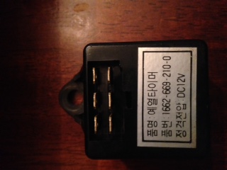

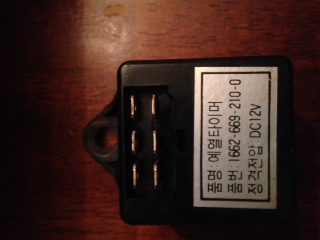

She's dead Jim. . .
Removed the cover. . . well more accurately destroyed the cover. I took a picture of the components on an old school bread board and it's pretty obvious that the timer is dead. Measured several resistors that are now open, and at least one cap that's bad too. Even if I was able to replace the components, which I'm not since they're embedded in epoxy, it'd probably cost me more in parts than the replacement at $40. The crappy thing is the part is designed to be sealed, but yet there is a pretty large hole near the blade connector. Oregon moisture (or mouse pee) clearly got inside and corroded the parts.
Bummer. . .
P

Indeed I do. As listed in the TYM parts catalog (PM me if you need a PDF copy):
Timer, Glow Part No: 16626692100 (it's also stamped on the component for convenience)
I did search around for cross-listed alternatives, but couldn't find any. Based on the Korean writing on the part, I'm guessing it's probably a custom part.
Pete
