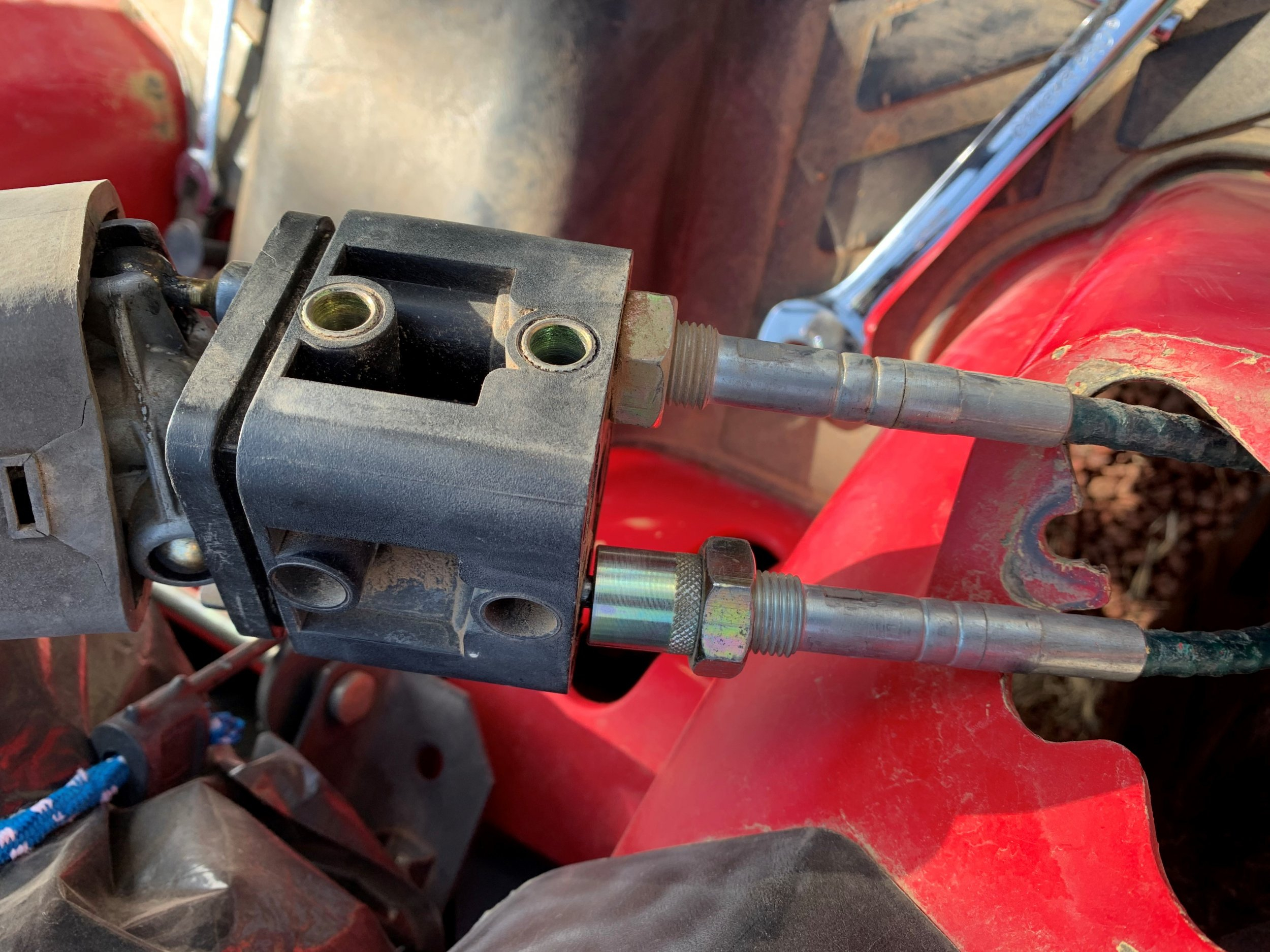

The cable for the bucket articulation keeps pooping out of the joystick. I can articulate up with no issue. Every now and then and maybe a bit more than that when I go to down articulate nothing happens. If I grab the cable and push it up hard into the joystick then it works again for a while. Is there some sort of locking pin or something that may be missing or loose that holds the cable in place? How do I fix this?
   / T293 Joystick Cable Connection Help
#2
This what I have. The collar that has the threads in it keeps coming out. Is there a way to lock it in there?

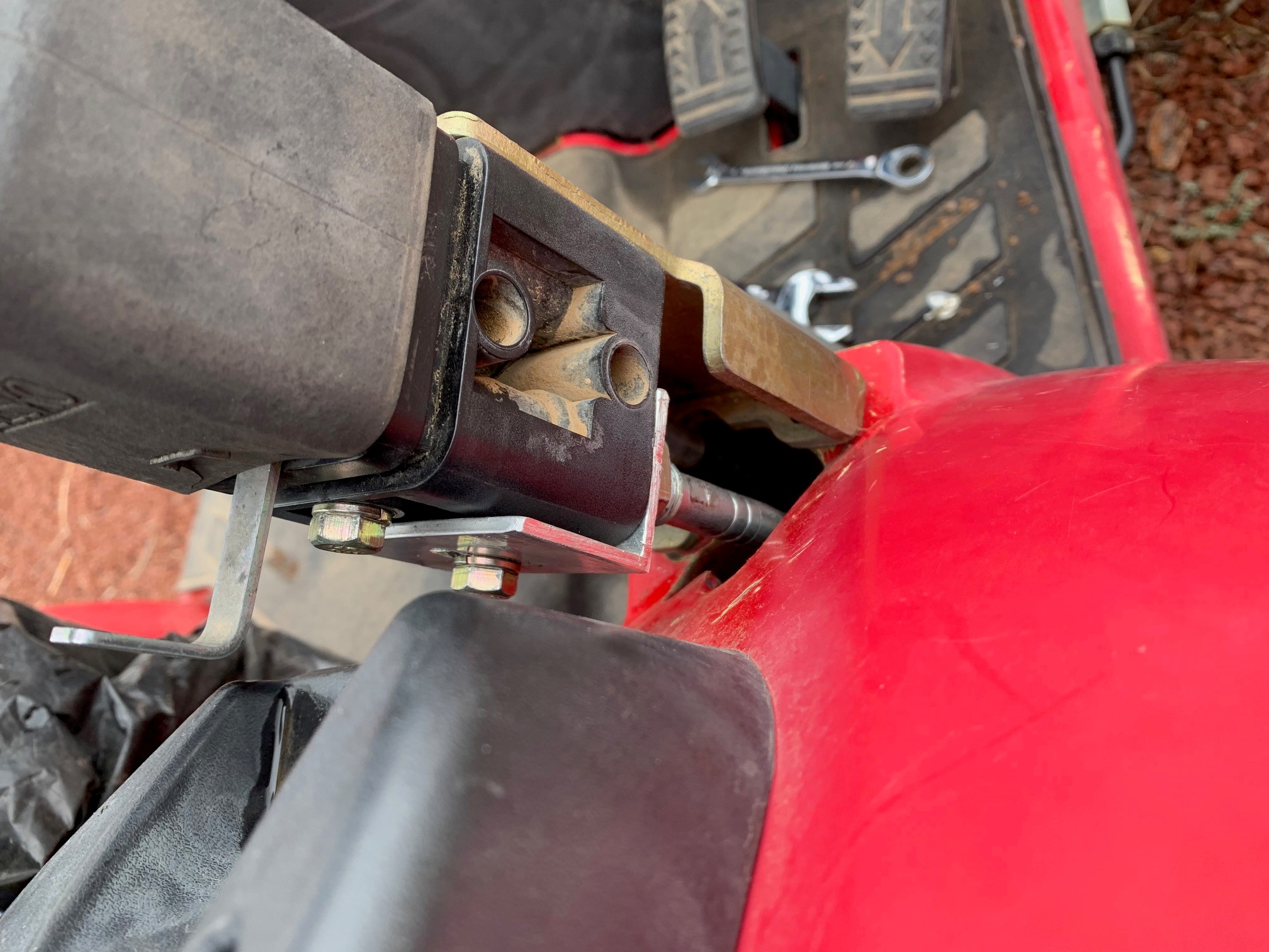

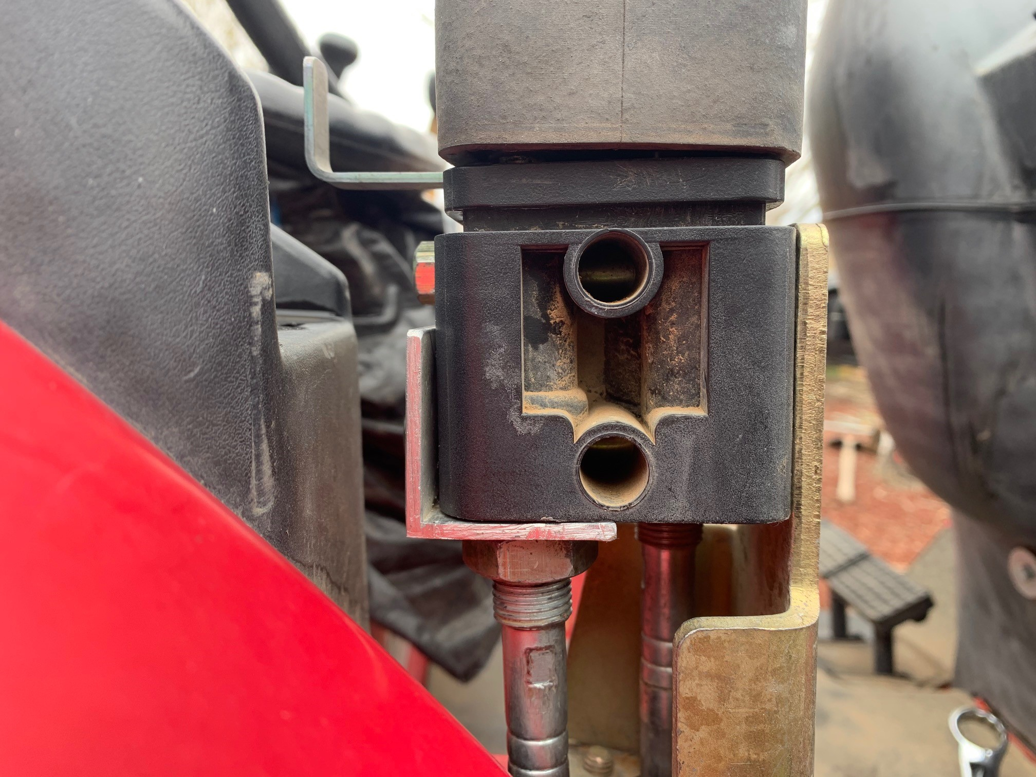

So what I have done, used brake cleaner followed by electrical cleaner to make sure the is no oil, grease or dirt in the hole for the bushing. Useg a mini pointed file to rough up the plastic in the tube, smeared JB Weld on the bushing and drove it back up into the tube of the housing. It was very tight with the JB Weld on it. Letting it cure now. Will add a holding clamp to make extra sure it never pops out again. Will add a picture to the clamp when I make it.
So this is the hold down clamp or bracket I made. It is a scrap piece of aluminum angle bar. I used the lower joystick mounting bolt to hold it in place. We will see how it holds.

I am going to have to give a shot of lubricant. When I cleaned it out I think I did to good of a job but it is working now.
