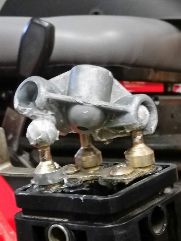

OK, here is the update, I broke the control cable going to the loader valve. I went to my dealer today and picked up a new cable ($50) and received basic info on how to replace it, the service side was closed today. I have reinstalled the cable now all I have to do is reconnect the joystick to the cable end which is a steel ball on a shaft. There are three, the center one in the picture which really is on a corner is stationary and the joystick pivots on it. The left and right ends in the picture controls the FEL and the bucket. I can get any two in their slots but not all three. I stopped today before I tried to force it and break the gray piece which is cast something. The joystick actually screws into the top of the gray piece and I don't know if it is available separately if I break it. I do know that the whole joystick control is $800 so I don't want to go there!
My question now is has anyone had to deal with this in the past? Any hints on how to get all three "balls" into the piece in the picture? I have tried many combinations of raising or lowering the cable ends, different angles etc.
I would think you have to remove the retaining plate to free the ball(s) and fasten it back when all three balls are inserted in the "swash" armature.

The answer above is wrong. I just looked at FEL control on my tractor. I think you need to unbolt the "fixed" ball, insert it to the "swash" armature and bolt it back.
   / T330 Loader Control Valve #52
Ladia,
I tried that, when the other two are connected there is not enough room to slide the fixed one back in place. I will look at it again, I tried so many combinations already I may not have had the other two in a looser or higher position. Thanks!

Take the bolts out that hold the joystick unit to the tractor. Under the base that is a allen bolt that holds the center pivot ball in place. Remove the allen bolt and slide it out. Put the ball head in the triangle plate and angle it downward so you can slide it over the two cable ball heads at the same time as you put it back in the housing. When down in put the allen bolt back in and try the joystick. If all works bolt it back to the fender brace. Note- In some cases you may need to adjust the bucket and boom cables higher to get everything to slide together.
   / T330 Loader Control Valve #55
Pete, thanks I think I just don't think I have the cables high enough. I will try it and let you both know.
   / T330 Loader Control Valve #56
Ladia and Pete,
You both had the right idea, I just needed to adjust the ball ends of the cable more to finally get it to fit into the triangular plate. It still took a few more combinations to get it right. Thanks for being so helpful!! I have to give a shout out to my TYM dealer, Jordan's Tractor in Post Falls Idaho, for being helpful and having a good supply of parts in stock.

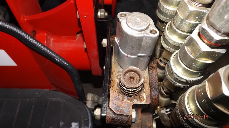

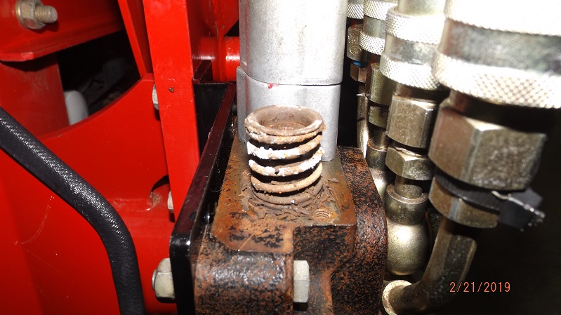

I know it's an old thread... hopefully, this will help some understand the loader valve issue on these tractors.

late.. reply..if anyone cares.
vmax540--yes these valves vent upward Causing issues. Not many options to remedy it. Tried slicone sealing holes and keep lubed. I had my vavle replaced adding a new lever mounted vavle and plate mount off of loader like the older tractors had. no cable crap to deal with... it has been awesome for the past 12 or so years.
