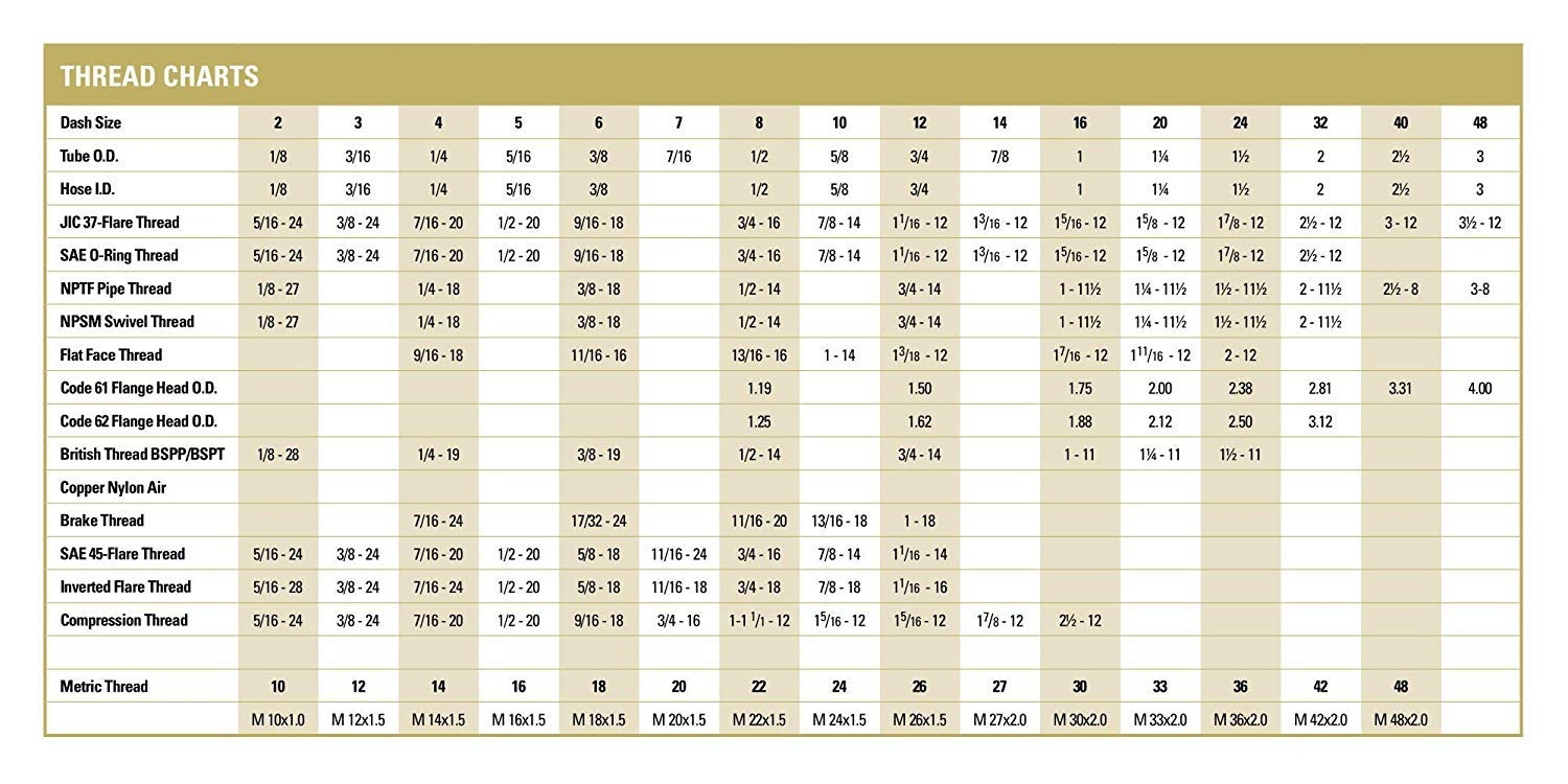

Yeah, for sure there's no shortage of standards. Everyone has at least couple. It's a world market these days. The best place to start would be having a couple of tools. A good set of thread-count gages and a caliper. Knowing the threads per inch and the OD of the male thread will help determine which "standard" is being used. ;)
Discount Hydraulic Hose has a nice Thread Guide PDF file you can use to check fitting ends.
Here's chart that shows various standards and the sizes of each with a thread count. You can save this image or print it out.
