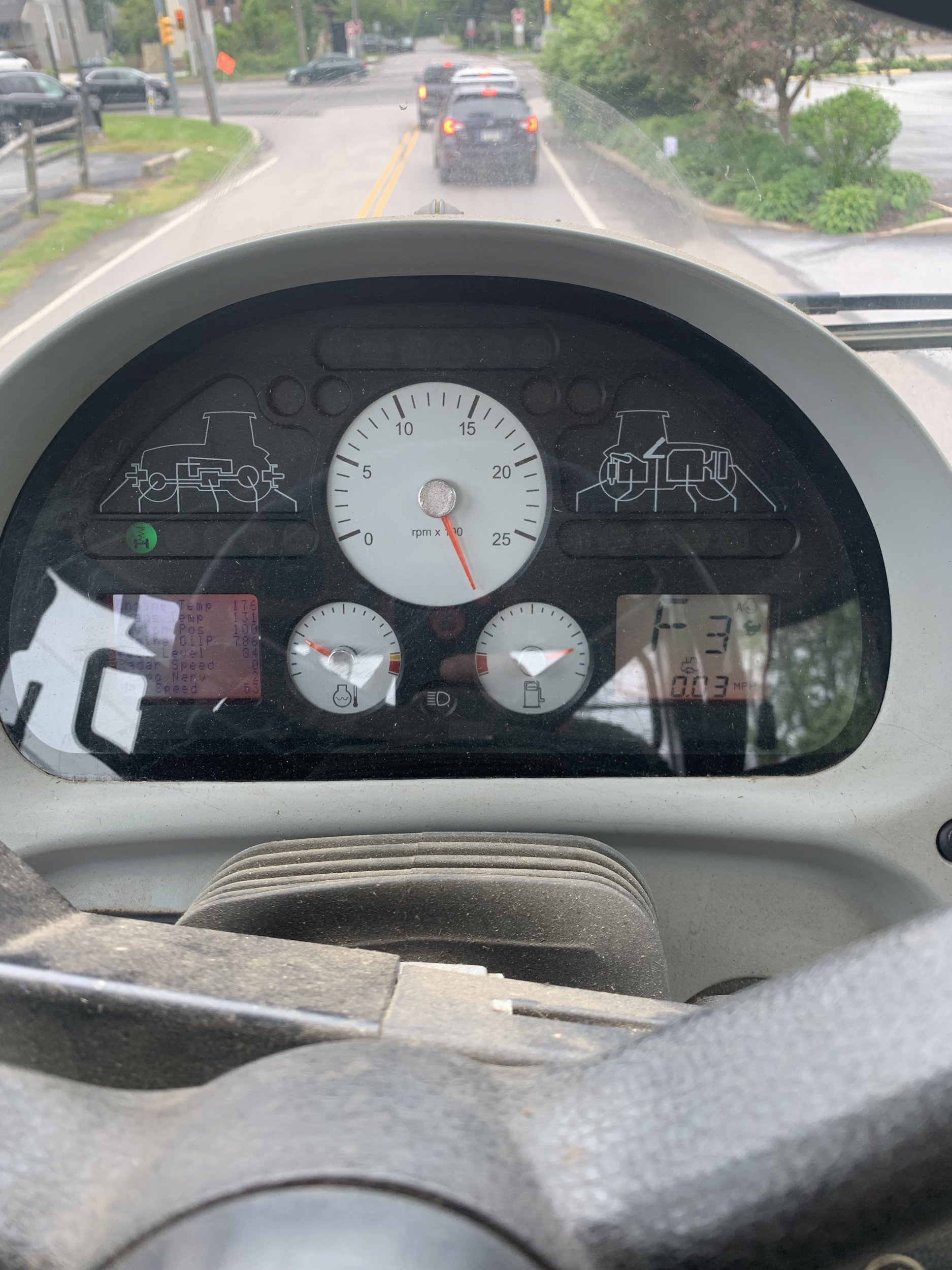

Massey 7495 tractor with traditional dash cluster tach. After running for a couple hours and presenting correct tach speed (compared to digital readout), the tach goes past the correct reading (2000RPM) creeps up towards 2500RPM, then into the white zone and sits just there.
Turn tractor off and it corrects itself, reads properly and 1-2 hours later, it does the same thing.
Any thoughts on cause or repair?

Had similar issue with a 2005 Chevy Truck.... The (stepper) motor/drive mechanism that moves the needle was bad and had to be replaced.... In fact all the whole dash had to have drive motors replaced in all the gauges.... Quality issue with Chevy...

Good above, speed sensor or cluster is heat sensitive, hopefully not the cluster, and not too expensive to replace.
A little can of duster air held upside down and sprayed on components will often help trouble shoot heat sensitive "stuff".

Have you tried some "love taps" behind the cluster to see if the needle reacts?
Had a similar issue on a 25 year old Mitsubishi Pajero/Montero, where the solder on some resistors for the tach would break and it would work intermittently. A couple love taps would get it going, which only proved about the broken solder.
