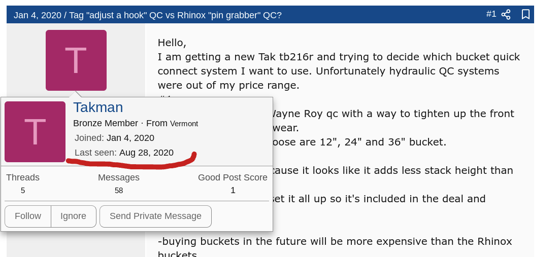

Old thread and Takman long gone, but maybe someone else has an opinion of it.
