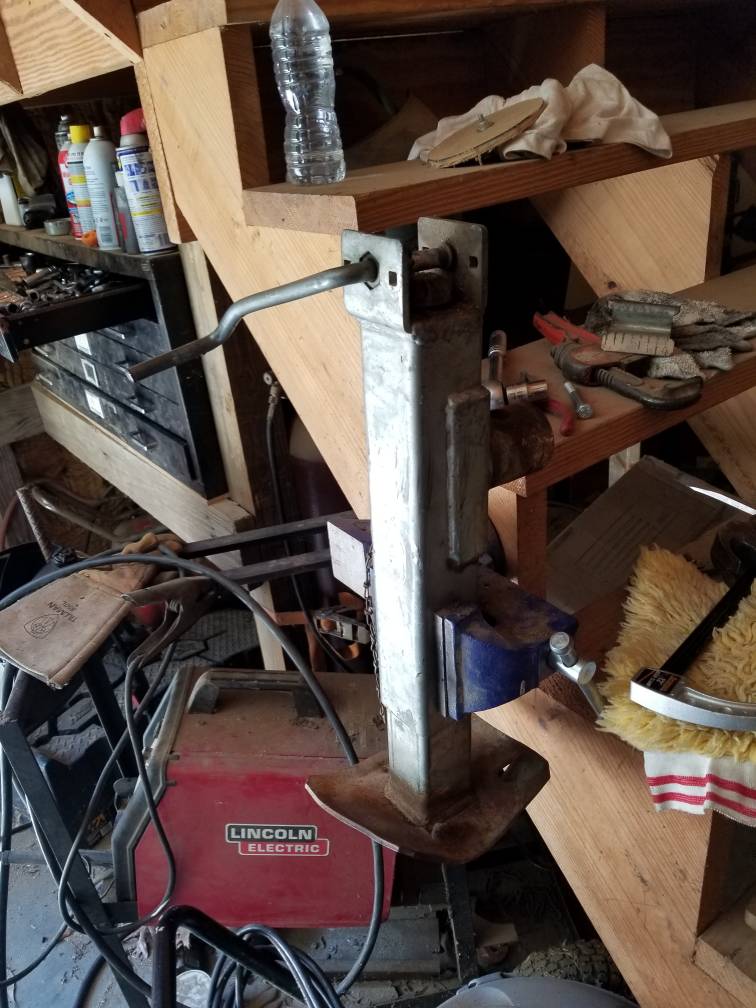

This isn't on a trailer but a batwing. It's takes considerable force to make it move. It appears they took off without removing the jack and the parts sliding together are binding.

I's imagine that there is a stop to keep it from unscrewing all the way out, so if there is a 90 degree gear arrangement at the handle, I think that you have to remove the handle, drive out the roll pin on the driven gear and the whole thing should come out the bottom.

I have worked on hundreds of them on semi trailers, though more heavy duty.
There should be a keeper on the horizontal gear, either nut or pin.
With the keeper removed the lower leg should come out.
If it works that hard you will need pound on the bottom to get it out.
If it is not bent too bad some times you can ding in the tight spot to free it up.
Worst case is if the worm shaft is damaged or worm shaft nut stripped or broken.
Once you get it apart you can figure out what is damaged. No harm in trying!

Can not tell from the picture. Is there not a "c" ring or keeper ring of some sort at the top of the shaft where it exits the square tubbing of the jack ? Handle come off, ring comes of the top of the shaft sticking out the top then the innards of the jack are pushed out the bottom.

For anyone interested, got this apart AND realized what's binding it. The vertical gear on the handle has a pin. Everything was froze up but finally got it. The horizontal pin from a youtube video, should just then lift out to reveal a pin. Knock it out, should drop out.
My horizontal gear is perhaps permanent froze. I noted a good size dent on the outer tube that's the reason for the bind. I just started cranking, had to stop several times....it is TIGHT.
Now it's apart, what do I do with the binding dent? Have thought of just drilling holes around it and take all the metal out in that dent area? Anyone with suggestions?
