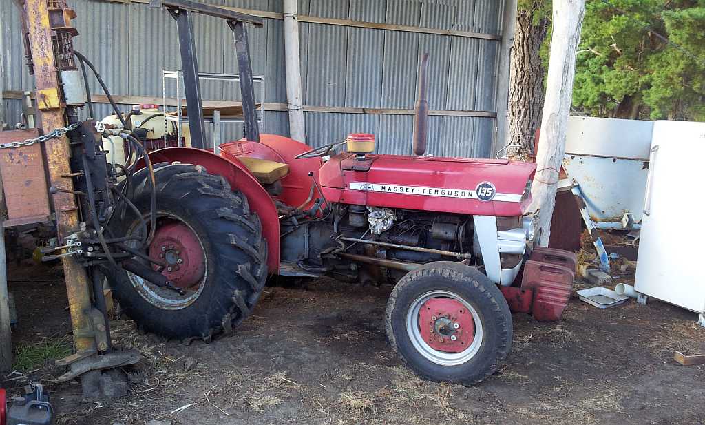

So. apart from my introduction, this is my first post here.
I'm no mechanic but I'm keen to learn - I don't think I'm too old just yet.
With our new property we became the proud owners of two MF tractors. A 3080 that will be the general purpose workhorse and a 135 that, while it still has to earn its keep, is also going to be the machine that I cut my teeth on.
This post is about the 135.
As far as I can determine, it's a 1968 model:
I guess my problem is that I'm not sure where to start (probably, hunting down a manual would be a good place but sometimes there are books and guides that are better than the original manual?).
It's tired, a bit tatty but it starts and runs well and I suspect that it's been reasonably well looked after - I checked the transmission fluid at the weekend and was pleased to see that, not only was it full, it was also clean and looked fairly new.
So, where should a newbie start? What jobs/checks should I do immediately?
Realistically, I'm not looking at a concourse makeover, my priority is to ensure that it continues to have a long and productive life.
Any tips?

You sure about the year? They sure make them different in England.

I saw some service manuals and owners manuals there for sale. Since the European version of the 135 was sold in Australia I would just imagine parts are available there as well. I do know you can rebuild that tractor from a catalog. There are more parts made for your version than the U.S. version. The euro version was more road/street ready with rear view mirrors I closed cans, wipers turning signals, foot excelerator. They are nice tractors.

You may have a 68 model but it looks different than my 68. I don't have a pic of mine with all the sheet metal but I have the continental 4cyl gas. When I got mine I was thinking like you. However, I found it to be worn out and did a rebuild.
