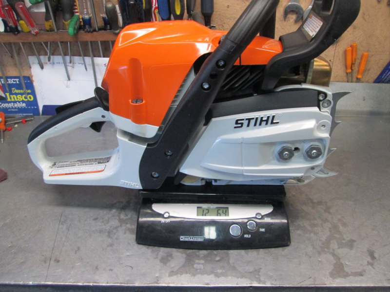

261 Gen2 Gen3 might be on Gen4 by now. Nice light like the 026 260 was. But I wouldnt want for bigger hardwoods. Sure they can cut bigger softwoods like spruce and pine. But hardwoods I be wanting more cc of a saw. $700
I would want the 400 66.7cc over the 362 59cc that it replaced for same weight. $1000

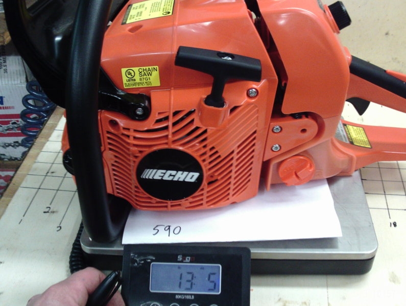

Echo 590 59cc entry level to their pro saw builds. Great saw with long stroke for bigger wood. $439
Echo 620 is the cadillac of the 59cc for echo. Has better stock porting then 590. rim drive, metal handle etc. $639
Down fall of the 59cc echos is the extra weight over stihls in same size. But you save 400 bucks or more too. 1lb more PHO dry as done by oem.
