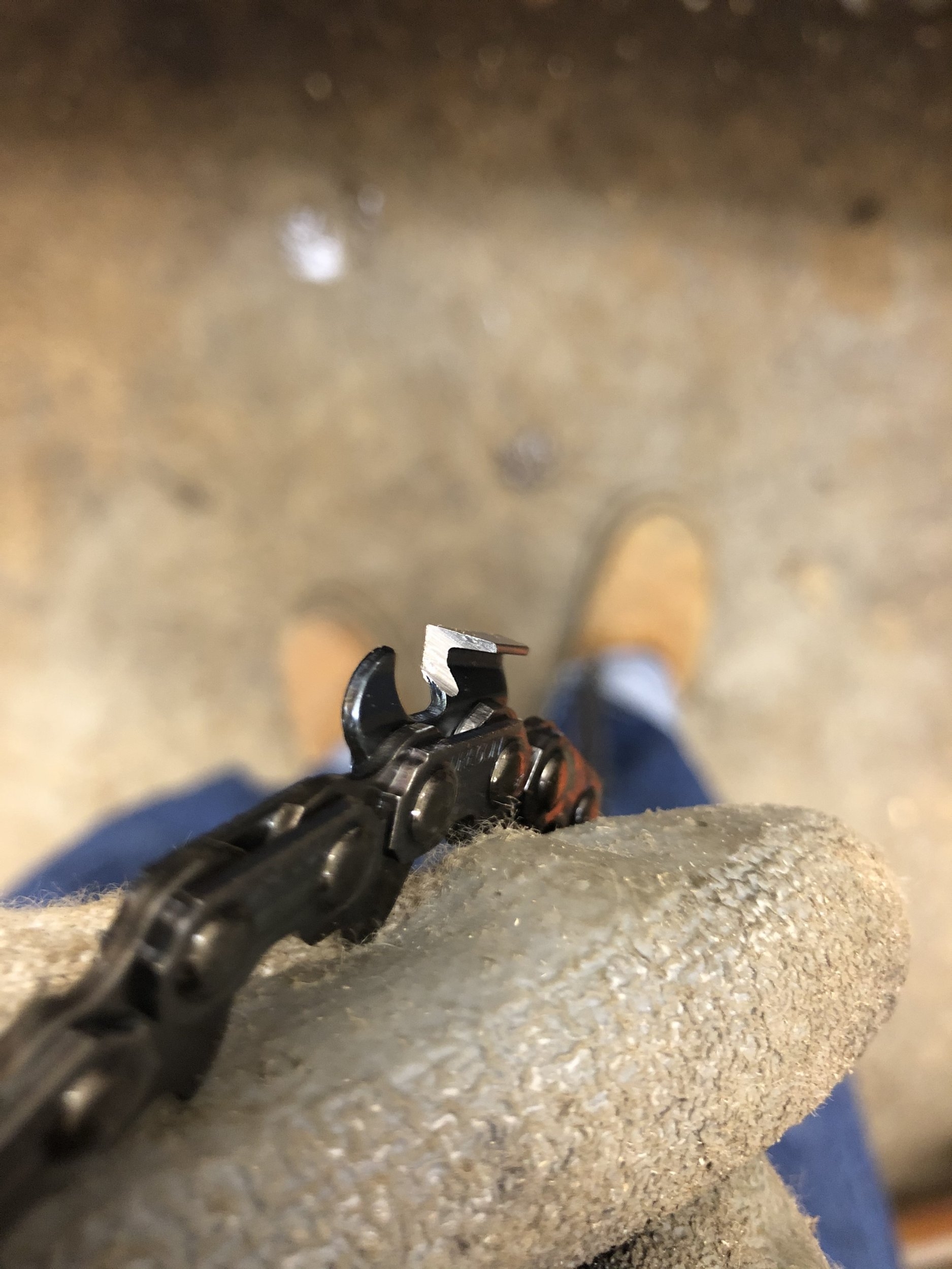

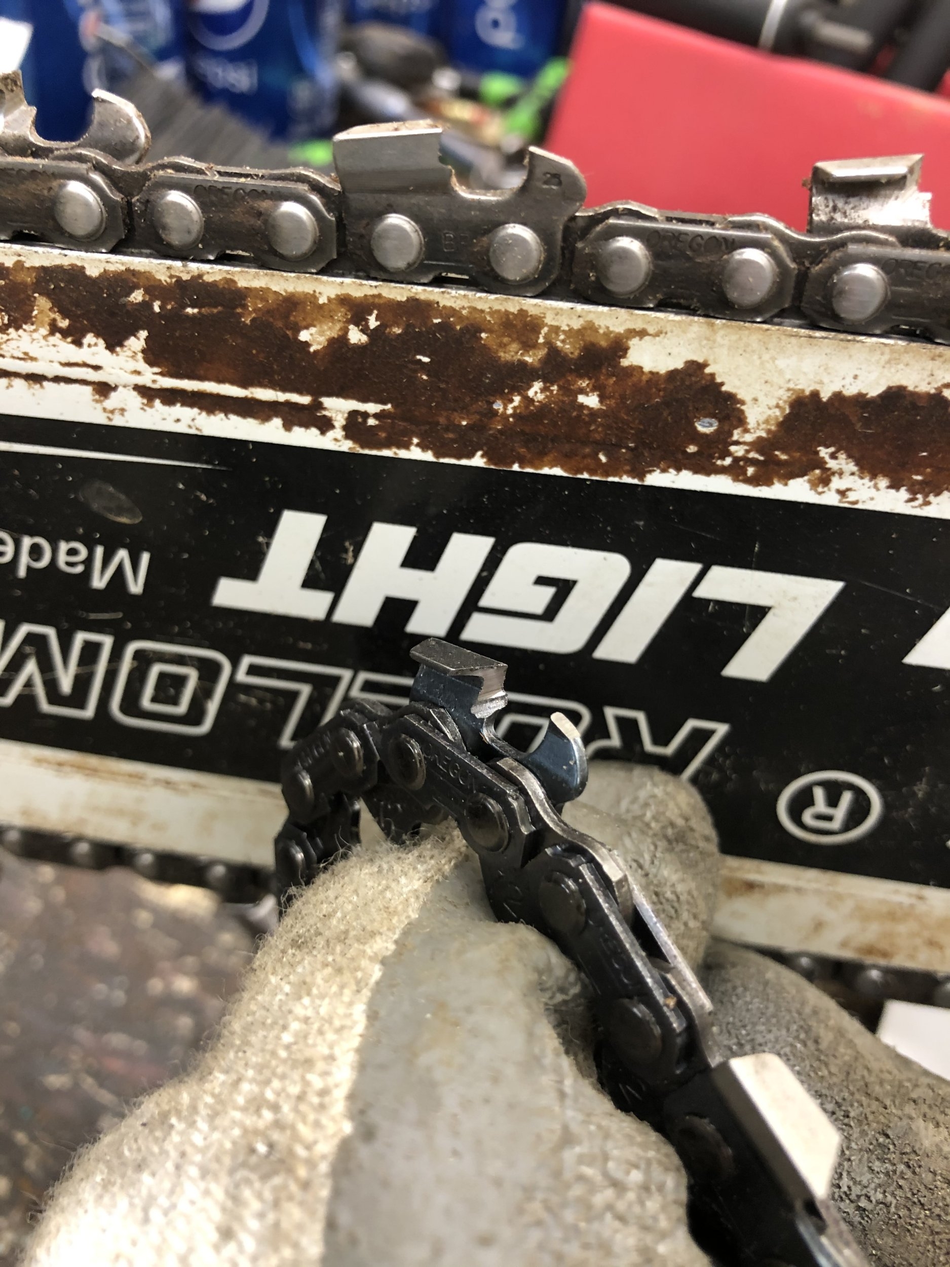

These are brand new chains after having been ground and had the rakers dropped, from the factory they’re too high.
