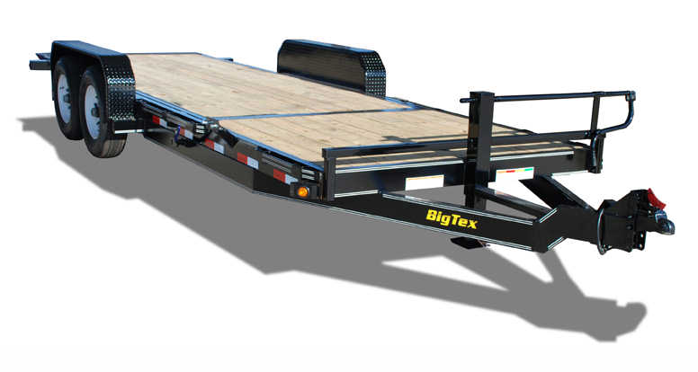

So when they load the pallets from the back cause the pipe-top rails will the 18ft be enough trailer?
I like my carhauler cause I can load from sides and the extra width...
Something like this. 102x22 View attachment 298766
Good point... Trailer might even be lighter... None of this is on my "need to do now" list. I'm just looking for additional uses for the truck (and trying to learn all of the in's and out's of hauling).
