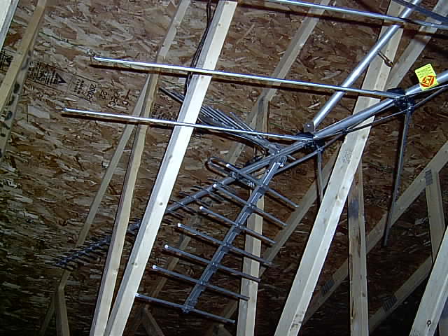

<font color="blue"> So now I am leaning on sticking with fuzzy tv reception and letting the lovely Mrs_Bob complain while she attempts to watch "COLD CASE" </font>
If you mentioned it already, I missed it...
What are you using now to pick up your over the air signals?
At our old house, we had a large rooftop antenna mounted on a tripod at the peak of the roof. It also had an antenna rotor with it, but we never used it. We picked up all of the local stations from one position, so once we set the rotor to one position, there was no need to move it.
When we moved into this house, I bought the largest rooftop antenna that Lowes sold and I mounted it in our garage attic, because MrsAndyM didn't want the eyesore sticking out like a sore thumb on the rooftop of our new house. When I hooked it up to the television, I got frustrated because the reception was so poor.
I was really close to ordering cable! /forums/images/graemlins/crazy.gif
Fortunately, someone at CountryByNet stepped in and suggested I buy one of those antenna signal boosters at Radio Shack. That made all the difference in the world. However, it makes my signal TOO strong on one of the local channels-- the picture is great, but there is too much "noise", making that channel unwatchable sometimes. We're able to receive four other NBC stations, so we can turn the channel if one doesn't come in well enough!
I was told that mounting the antenna in the garage causes the signal strength to be reduced by 50 percent. If I can receive five NBC stations now, what would I receive if I mounted the antenna on the roof? /forums/images/graemlins/tongue.gif

I have a large (about 12' long?) antenna on the roof. About every other year a bolt of lightning strikes it and blows it apart and I find elements all over the yard in every direction. The antenna is pointed toward Chicago, we pick up all their stations, but CBS and NBC often come in very badly. Chicago is the closest transmitting city. South Bend is about twice as far away.
   / Talk me out of Satellite & HDTV??? #47
<font color="blue">The antenna is pointed toward Chicago, we pick up all their stations, but CBS and NBC often come in very badly. Chicago is the closest transmitting city. South Bend is about twice as far away </font>
I just got the same 12 foot long antenna the other week. Put it in the attic hoping to get Chicago. When aimed at nearby South Bend I get their stations just fine but aimed at Chicago all I get is fuzz and the South Bend stations then come in poorly as well. So it's aimed back to South Bend, I guess I could have gotten the smaller model antenna after all /forums/images/graemlins/smile.gif
   / Talk me out of Satellite & HDTV??? #48
<font color="blue"> When aimed at nearby South Bend I get their stations just fine but aimed at Chicago all I get is fuzz and the South Bend stations then come in poorly as well. </font>
Is that with a signal booster installed? I suggested that Bob install his in the attic with the booster, and maybe that will improve the signal and solve his lightning problem.
   / Talk me out of Satellite & HDTV??? #49
Hmmm, hadn't considered a signal booster. I may have to try that. Of course, if it does work I may have to have one of those rotator things too as we will still want the South Bend stations /forums/images/graemlins/smile.gif
   / Talk me out of Satellite & HDTV??? #50
The signal booster worked great for me, but I can't use a rotor in my garage attic-- it's wedged in there pretty good and I have to disassemble and reassemble the antenna every time I want to reposition it.
