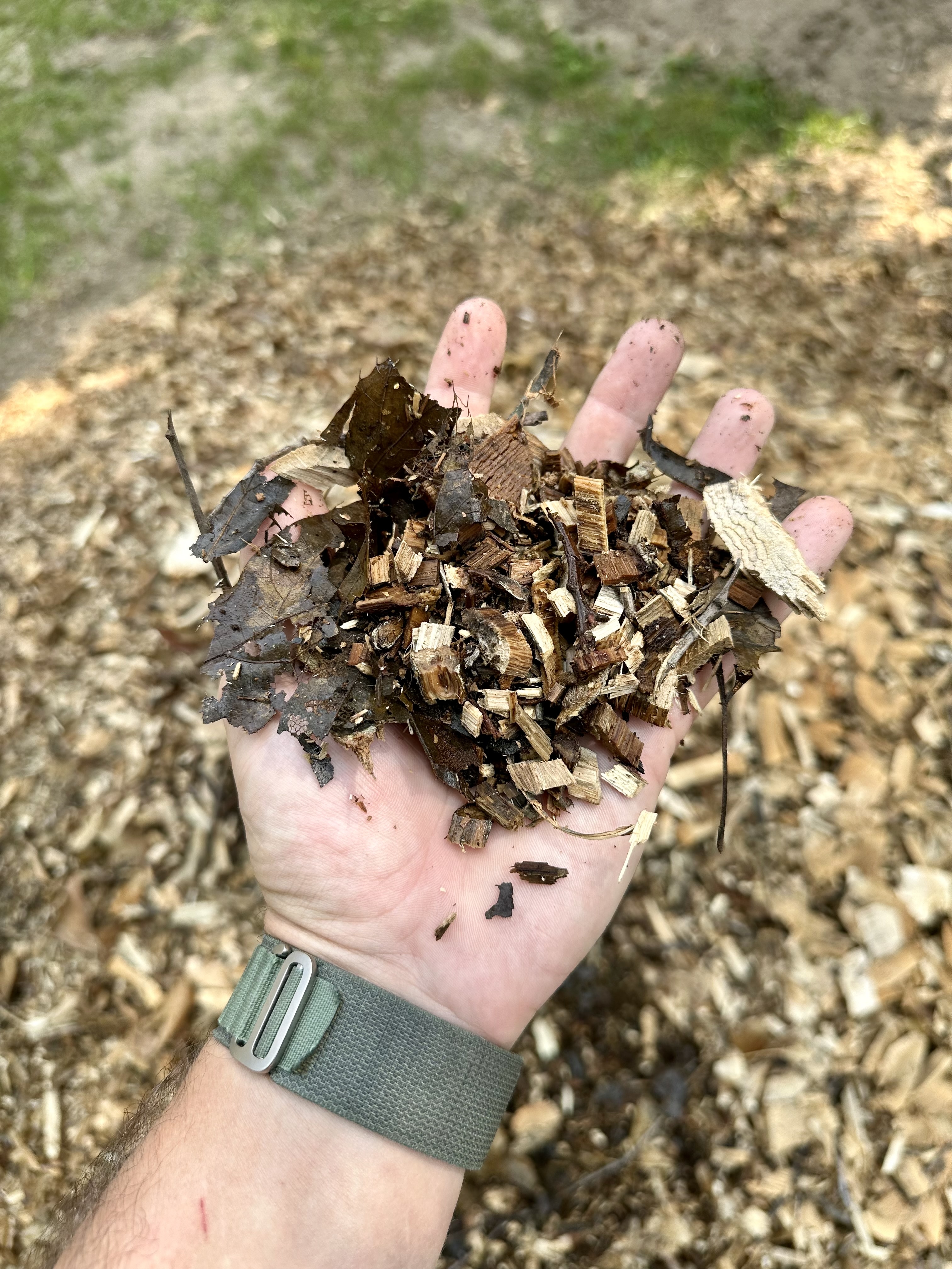

You might look into getting chips from a tree service. Often they will be happy to dump chips on your property instead of driving them to the dump and paying to dump them.
Around here that don't work. All the arborists here dump their wood chips at a couple yards where the process them and color them and resell them to homeowners as colored mulch. Big business here.

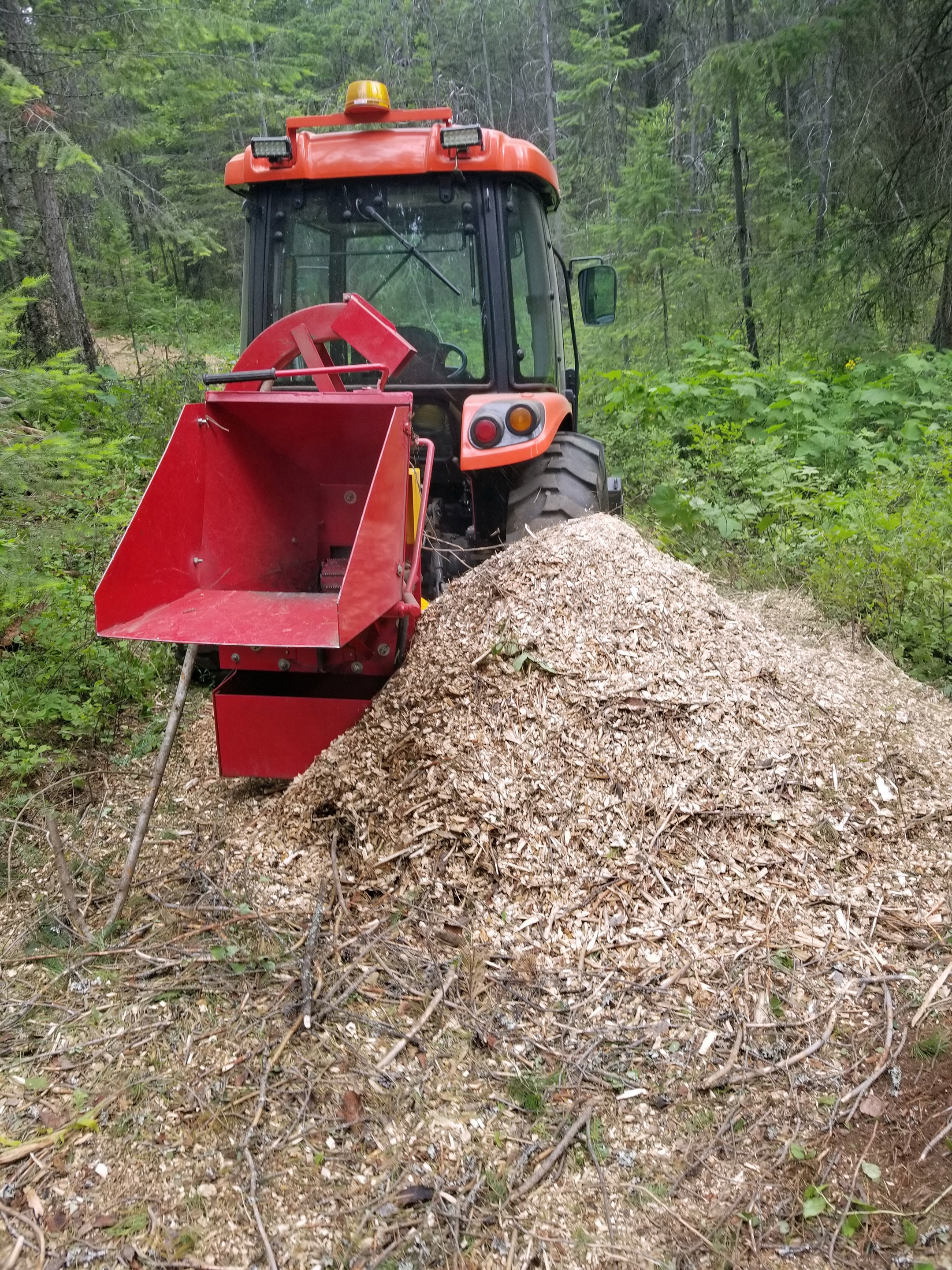

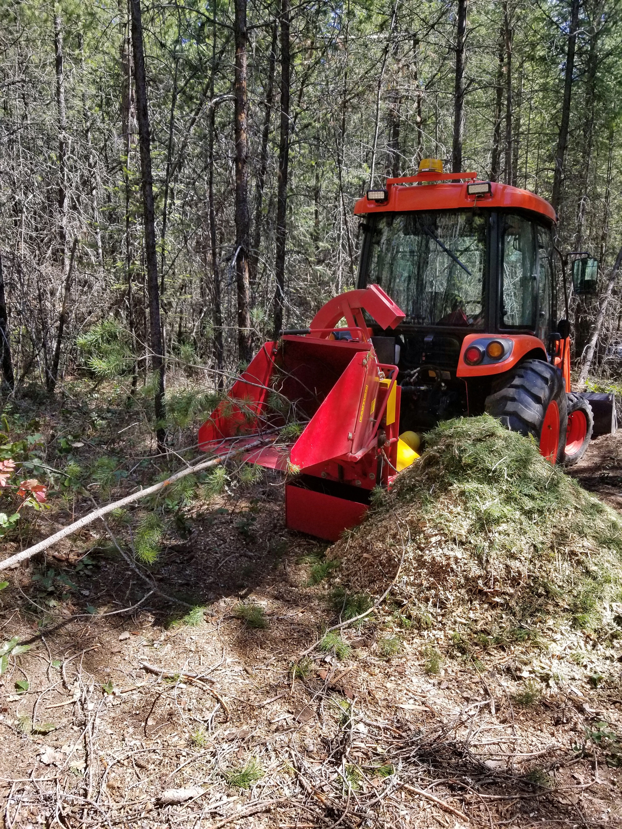

My original chipper - Wallenstein BX42S - would plug when chipping my green pines. Not enough HP - not enough air flow. I used it with my Ford 1700.
In 2009 I bought my Kubota M6040 and upgraded to a Wally BX62S. This solved the plugging problems. More than twice the HP and a whole lot more air flow.
I devised a plan that solved the plugging with the BX42S. Thin my pine stands - drag the thinned pines to large piles - let them sit a full year and dry out. This worked with very little plugging.
When chipping stuff that is likely to clog (lots of green leaves, and especially, cedar trees) I try to have a pile of branches without any leaves handy to feed in between the green stuff. The big chips act like fiber in the chipper diet to keep the flow going. Ewwww.

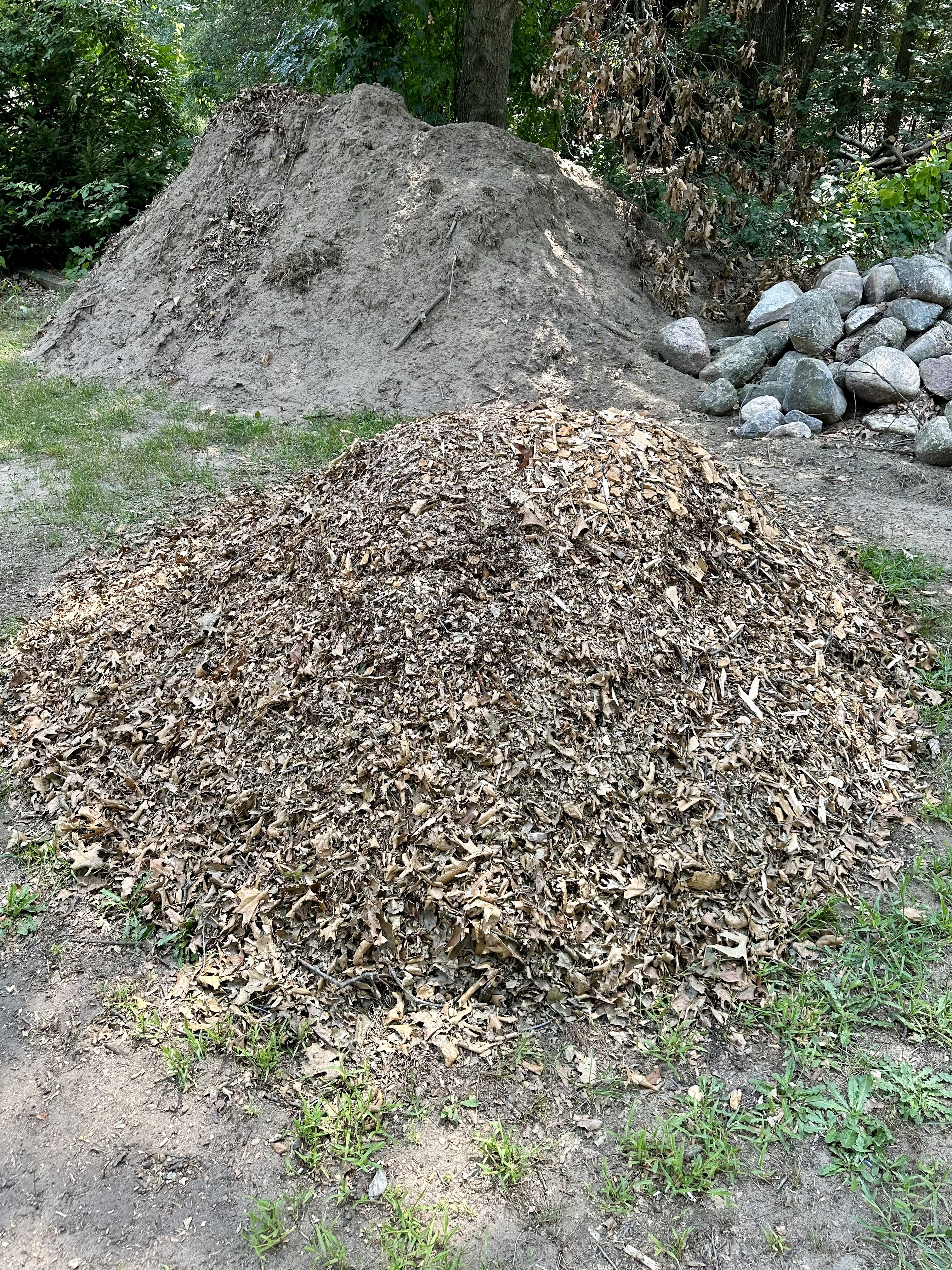

The chips on the few spots on my driveway do reduce the dust. I could transport the large piles and spread on the driveway.
However - if we ever get enough snow that I would need to plow the driveway - the chips, along with the snow, end up in the ditch.

I have forest trails I put chips on. The power company comes through about every three years clearing power lines. I track them down and get put on the list for getting chips. Last year I hit the jackpot and got 8 truckloads of chips. I think it was because my dump location is on a cul-de-sac and easily accessible.

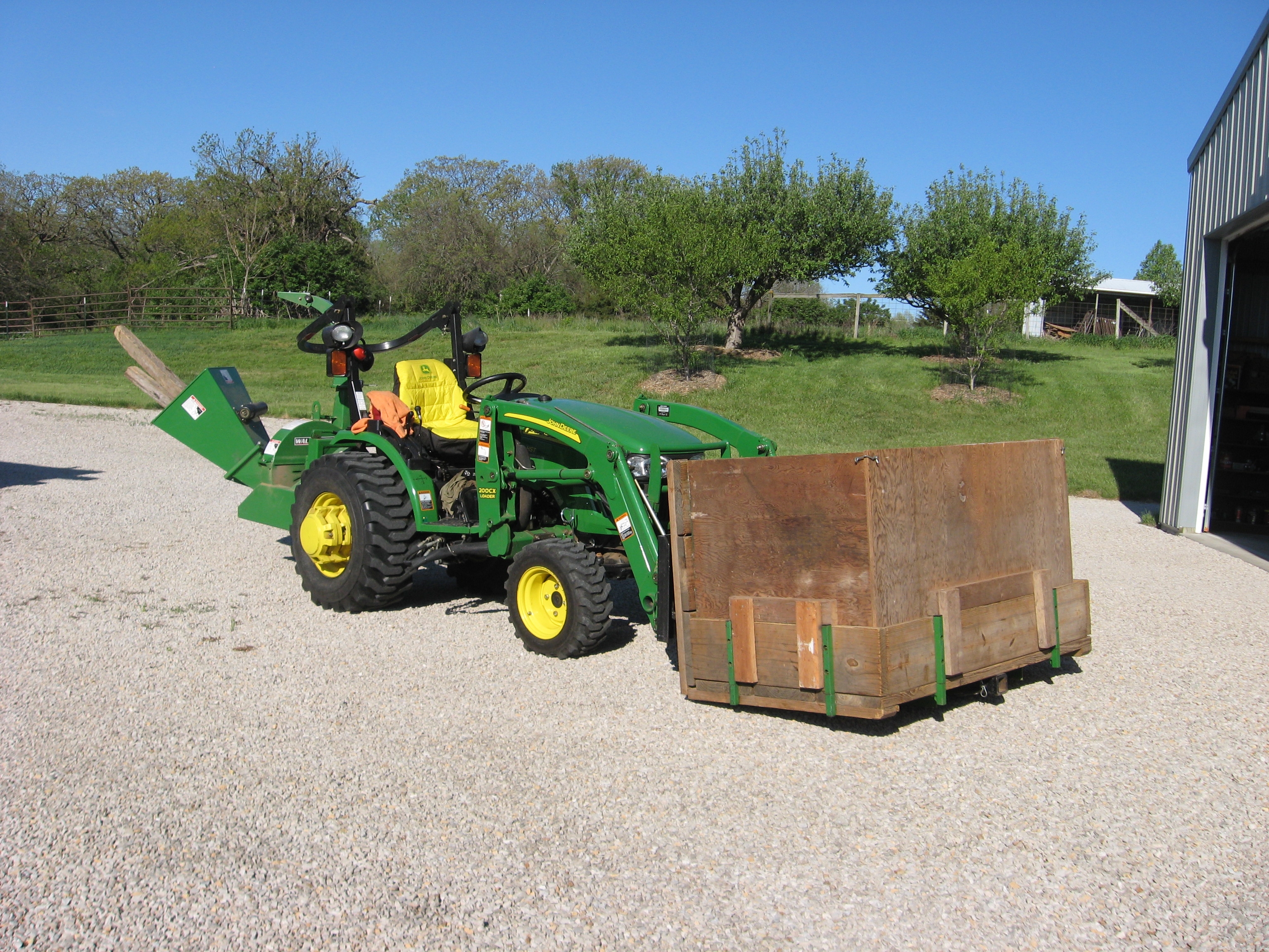

It takes a long time to spread that many chips. I have a Kubota BX24. Previously I would get the loader full and then hand shoveled chips into my carryall box. This last time I made a hitch mount on the back of my carryall for my 15cu ft JD trailer. I would balance my carryall on a 4x4, disconnect it from the tractor, and load my carry all and trailer with the loader, get the loader full of chips, reconnect the carryall and trailer, and finally go spread the load. It worked pretty well. My goal was to minimize my trips.
The 4x4 made it much easier to reconnect on the soft uneven ground. I could rock it up and down and shift it to make the connections.

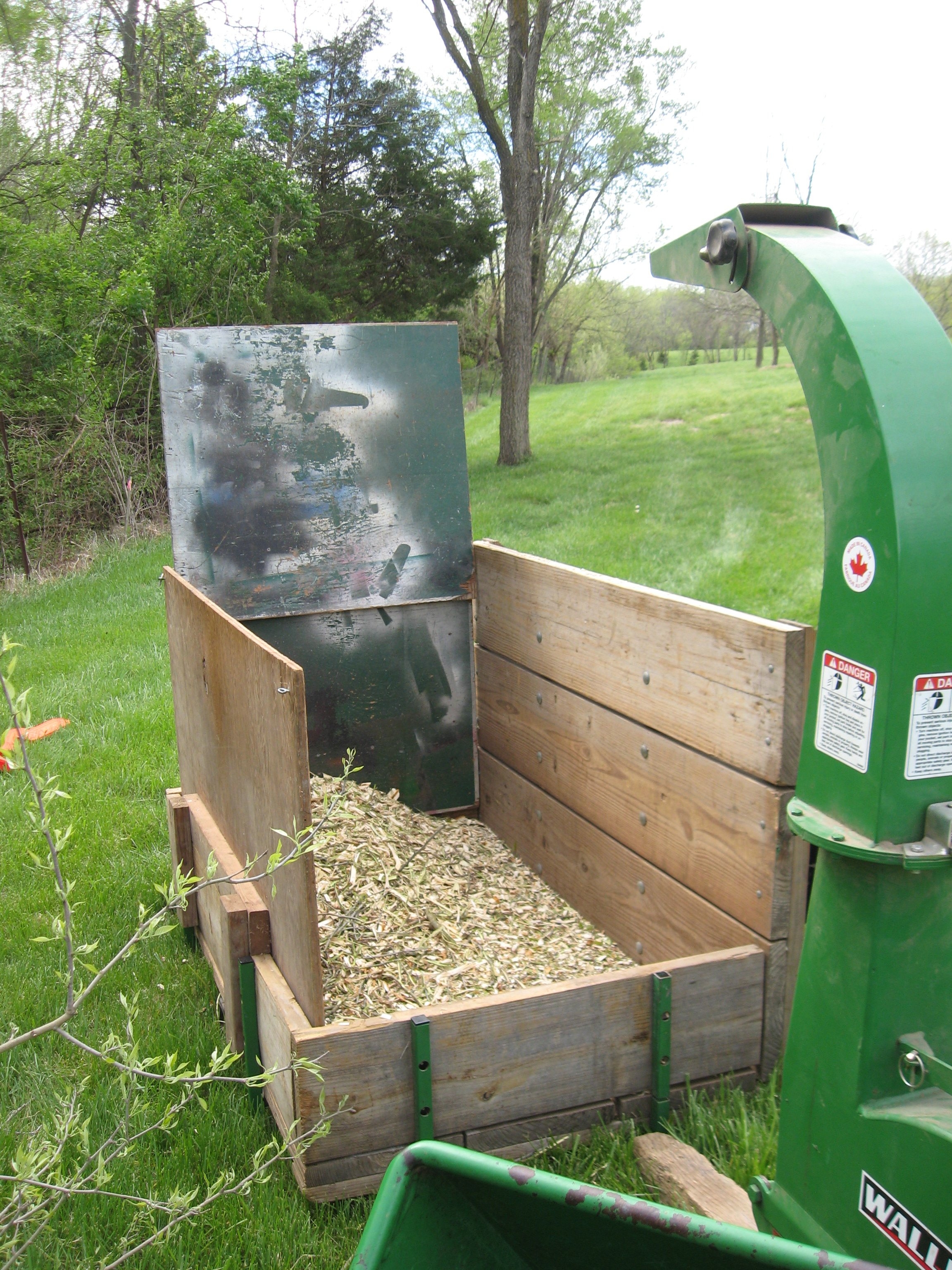

Carryall on the loader with extended sideboards is the best way I've found to handle wood chips. If I'm chipping, I chip directly into the box. If I am spreading from the pile, I load the box with the loader bucket, then, drop the bucket and take the box to where I need to dump the chips.
I either take off the front of the box to dump with the loader, or take off the side to unload at a tree ring, etc. Very easy to use a rake to pull the chips out the side wherever I need to place them.
