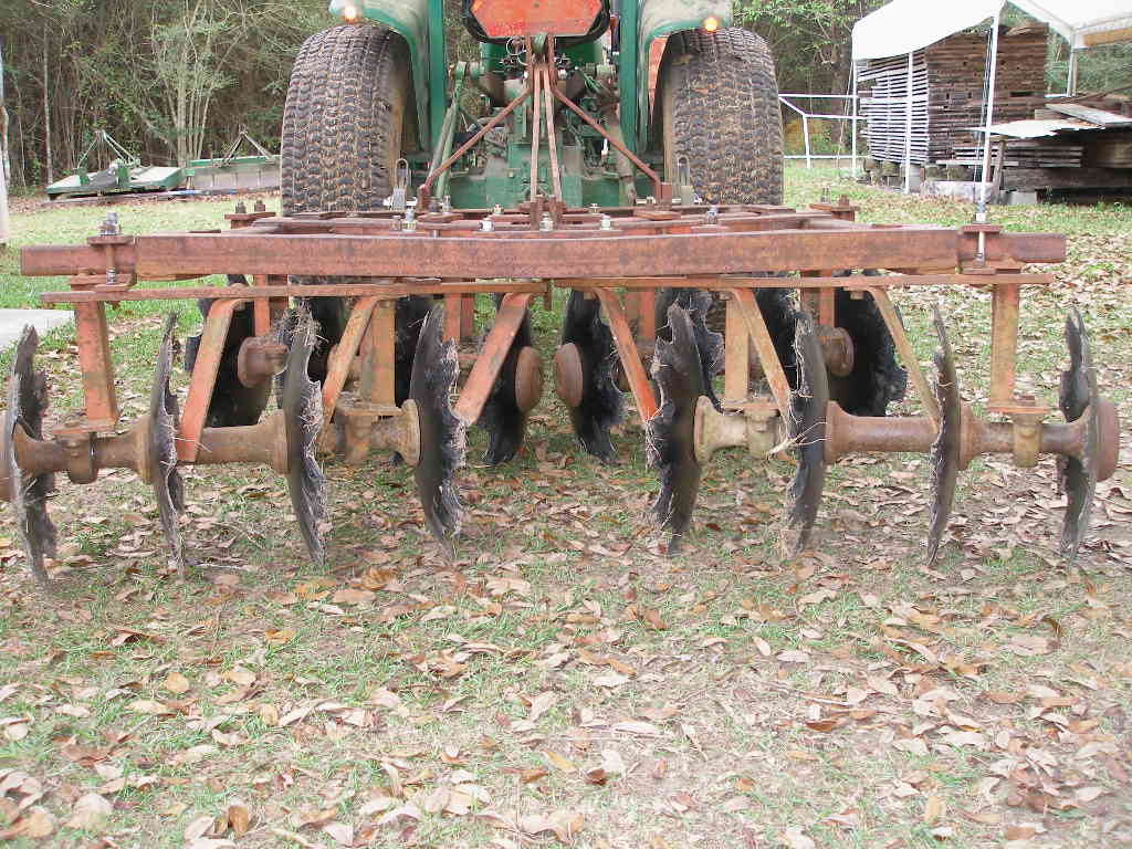

All the pans on my Tufline are the same diameter, 20". What varies is the spacing between pans; 9" spacing between pans on the front gang for penetration, 7-1/2" spacing on the rear gang for smoothing.
In theory, you need pans to all be of one diameter so you can usefully vary gang pressure between front gang and rear gang by adjusting the Top Link of the Three Point Hitch.

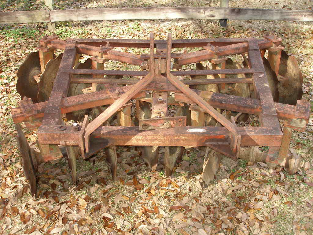

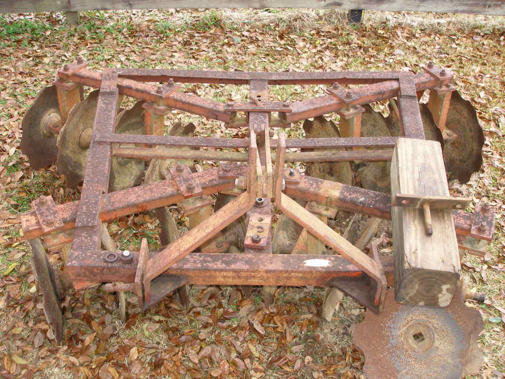

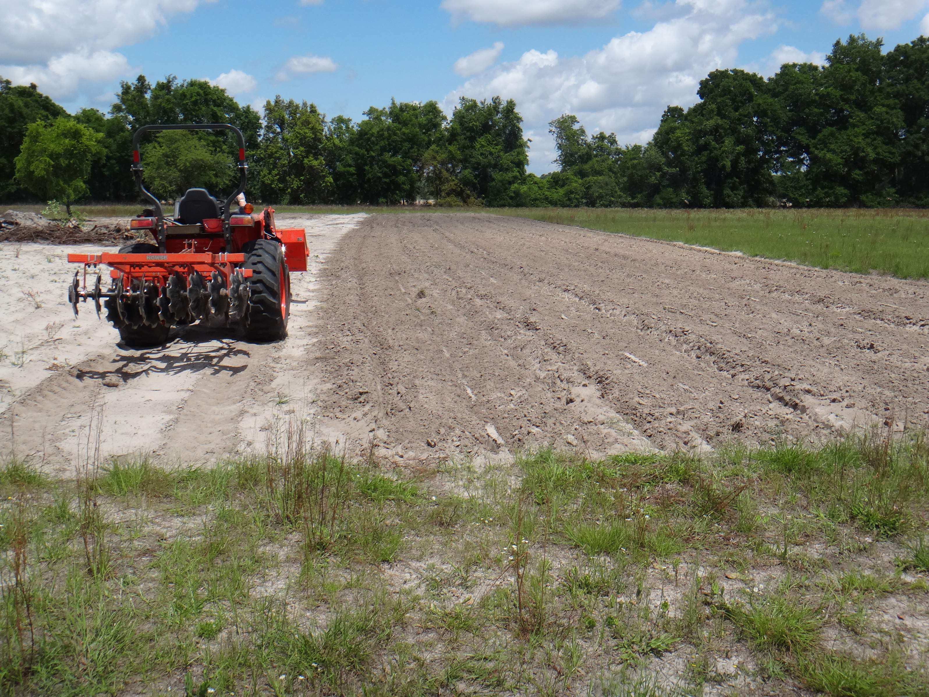

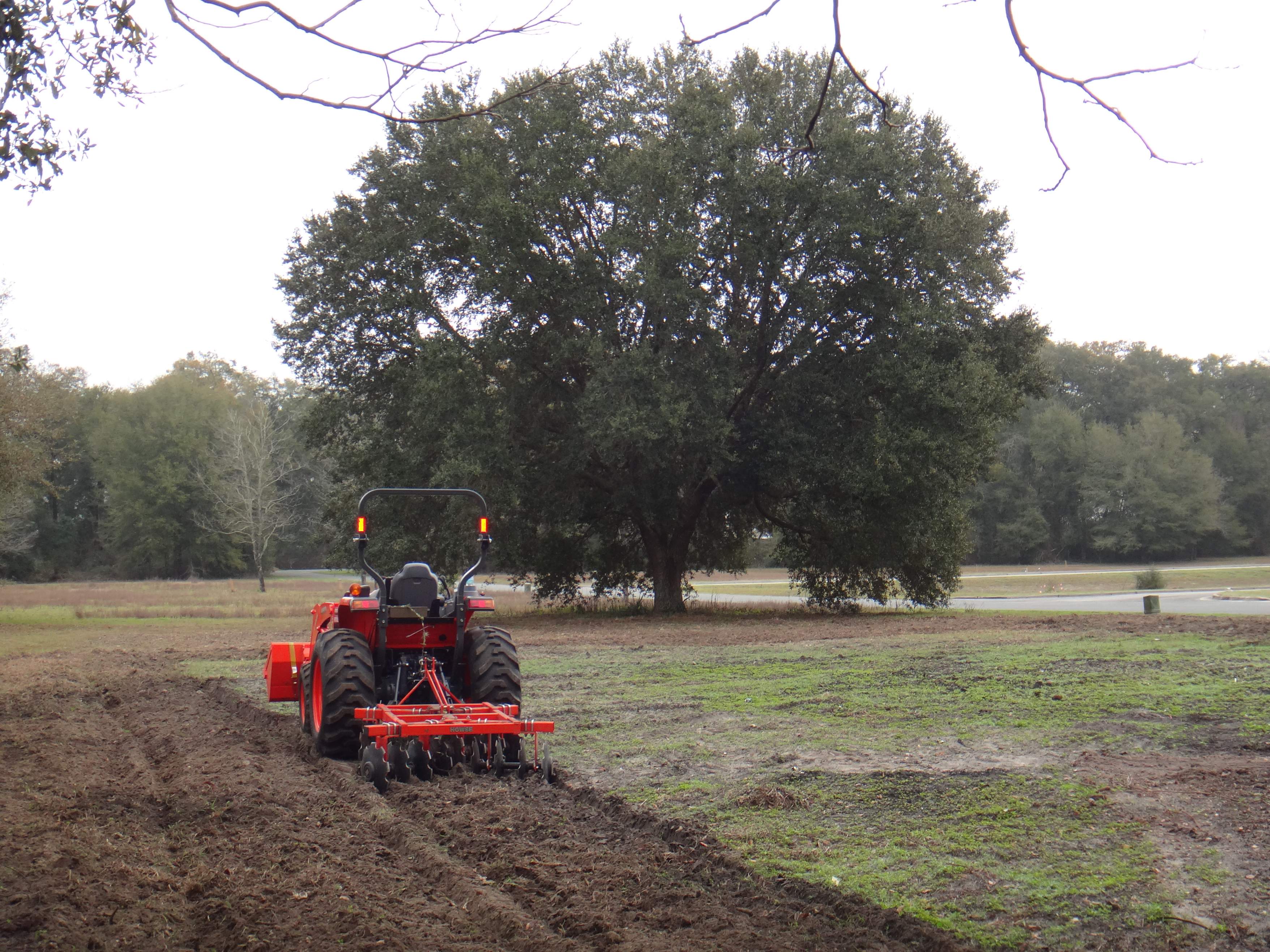

Jeff9366 you are very knowledgeable on disc harrows. Can you tell me where to position these scrappers? Outer edge, inner edge of disc?
I finished rebuilding this old Tufline model TM. It had 6 scrappers on the back gangs, 3 on each side. I can get more. Are they worth getting.
At the moment it is to wet to disc. That's why it was my winter project.
Thanks

Good looking repair job. Have much trouble getting the end nuts off the axles?

"Good looking repair job. Have much trouble getting the end nuts off the axles?"
Good question, vtsnowedin...
I thought getting those really rusted nuts off the axle was going to be the hard part. But here's what made it easy for my situation.
Fortunately, this had "Square axles" so slippage when turning was not going to be a problem. I used two pipe wrenches. One was put on the axle spacer spool and wedged against the frame to keep that axle from turning. Then the other was put on the nut and using a 6 foot cheater pipe over the handle of the pipe wrench for leverage. (these were heavy duty pipe wrenches by the way) The rust on the axle thread broke free and the nut came right off. Had that not worked, heat was going to be next. When putting every thing back together I used "never seize" on the threads, so future disassemble/repairs will hopefully go better.

A six foot cheetah pipe on a wrench that can take it is a wonderful thing. I'd of given it a 24 hour soak in PB blaster or equal then heated the nut up with my propane torch as hot as I could get it just so it knew I was talking to it. :)
