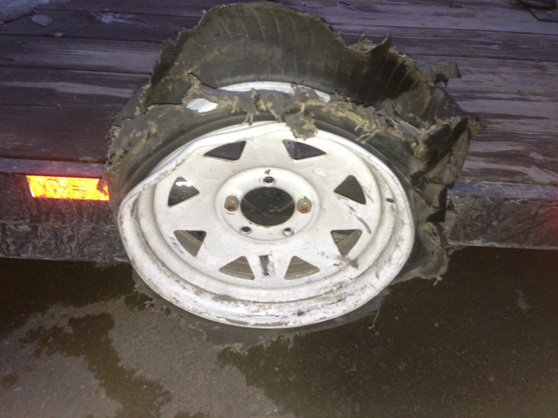

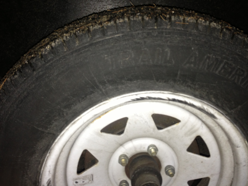

This trailer was last used 3 months before, which was also the last time tire pressures were measured and were appropriate. The trailer was dug out of 2 feet of snow for use, visual inspection, lights, brakes all checked but inflation pressures were not checked!!!! Trailer electronic brake gain set appropriately. Should tire inflation pressures be checked with every use ?
Tires: Trail America ST205 75D 15
i don't even pull off my farm without checking the tire pressure.
if I stop for a meal while hauling a load, I walk around and thump and look at all the tires.. etc.

check tire pressure with gauge weekly. visual check only inadequate
check visually AFTER loading trailer, each time, learn how to notice low pressure
use high pressure valve stems, there is a difference, metal are preferred.
include spare in pressure check
