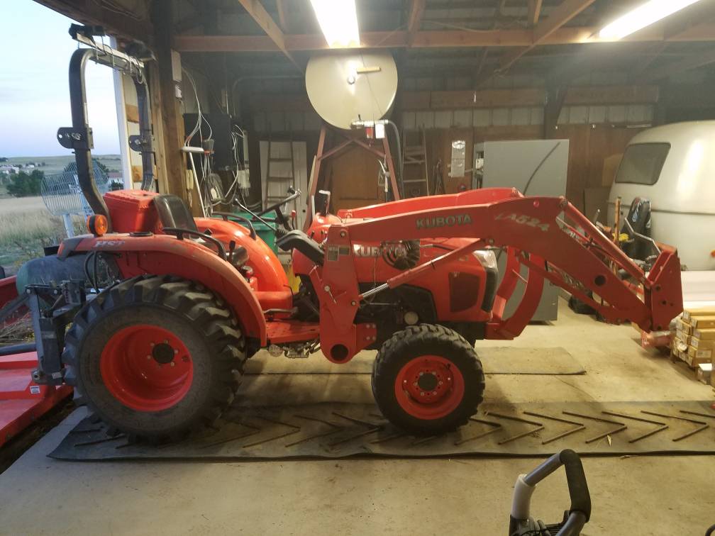

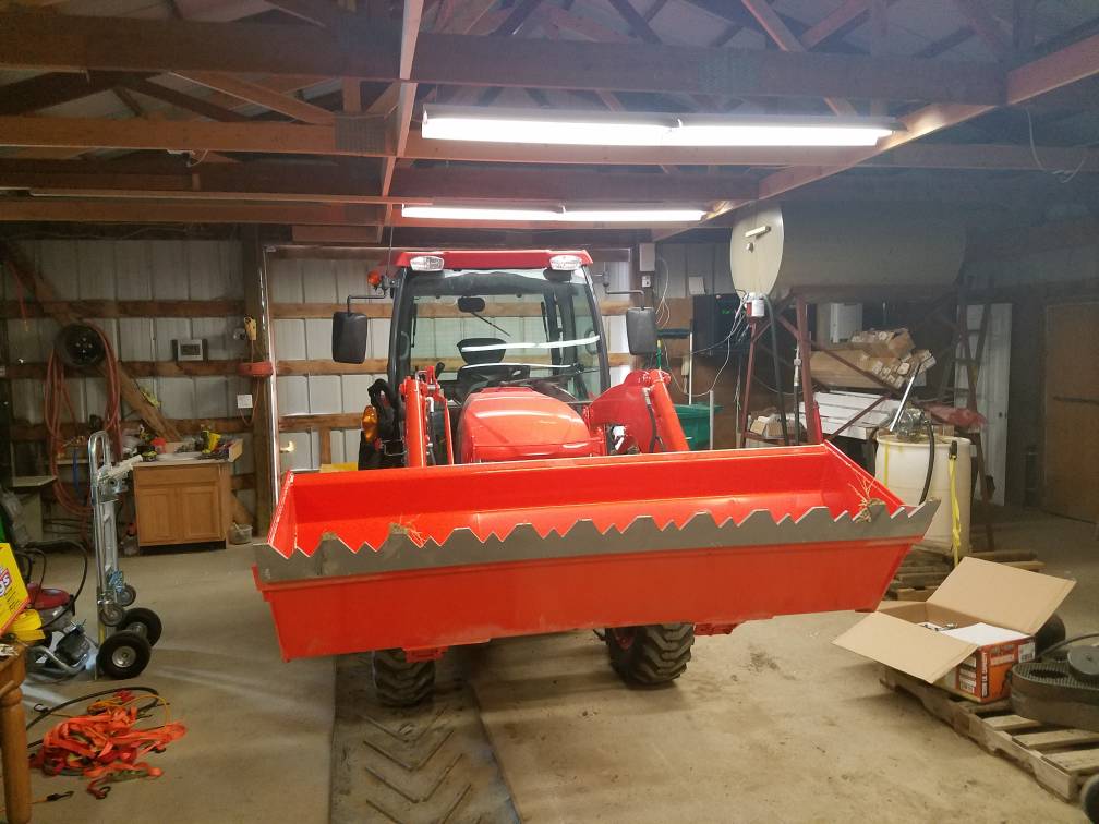

I upgraded from a white plastic 55 gallon tank with a hand pump to a 300 gallon tank on a stand at the shop. I haven't gotten around to calling the fuel truck yet & both are dry. Using some small plastic cans & stopping by the gas station a mile away until I fill the tanks in the shop up.
In the mean time I've been looking at some of the truck bed tanks a bit. I need to re-fuel on-site a bit as well. Not a need for a lot of fuel & a lot of my jobs I just road the tractor to (so wouldnt have the tank on the truck anyway).
Looked at a few 30 gallon tanks online, but haven't been able to convince myself they are quite worth the price tag yet. I can't see the need for any more than 40-50 gallons. The beater F250 has a utility bed on it that is 4'x8' for bed space. Its likely to get upgraded to a a non-beater 3/4 ton in the next year, maybe 2.
Realistically I can probably get by with 3 cans in the bed to get me through a day, but it gets tedious making sure they are full & loaded into the truck. Im often short on time as I'm loading up & taking off. I can't leave cans in the bed as sun eats them up, potential for theft .
Any thoughts on the extra cost for an aluminum tank over a steep tank? Worth it for minimizing rust or weight?
Any other thoughts or suggestions for easily fueling your machine on-site?

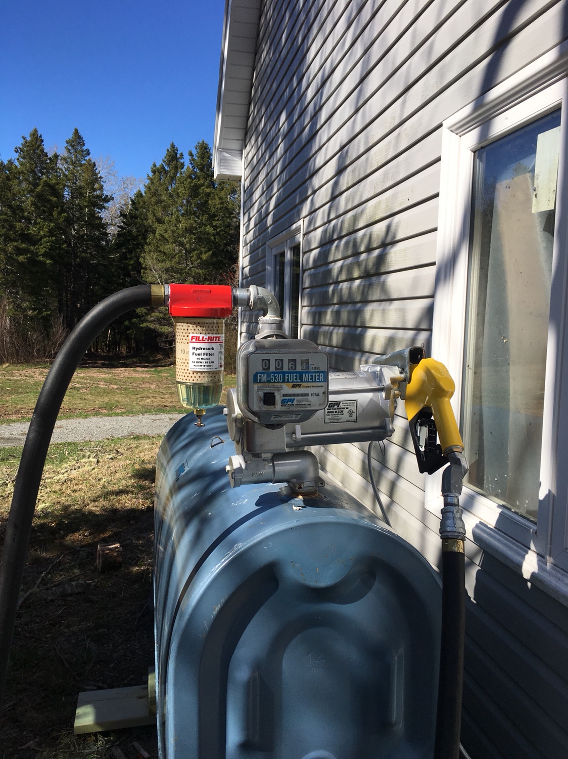

Here’s my set up for onsite fuelling. 300 gallon tank was free - It’s a ten-yer-old furnace oil tank from inside someone’s house. Around here insurance companies make you replace them every ten years. No such regulation for diesel storage.
I added a used 25gpm pump (a little overkill) that I found used for $300 with hose and nozzle. Then just this weekend,I added an auto-shutoff nozzle, swivel, and filter/ water separator.
As far as a slip tank goes, I’d just try to find a used one. I see them periodically for one or twi hundred bucks.

Thats a nice setup!

   / Tank for on-site fueling?
Not great photos, but you can see the 300 gallon tank on the stand in the back & the 55gal drum strapped to a pallet in front of the stand. The gravity stand & big works better than the hand pump. You can hear the tank on the tractor about to overflow with the quiet gravity fill as opposed to cranking on the hand pump.
But by on-site I mean out where I'm working on a customer's site & not near the fuel in my shop at home.
The drum isnt DOT approved as a transfer tank, not to mention being top heavy. I've thought about some of those 20-25 gallon plastic totes on wheels. But I have a bad back, they are still plastic & going to die from sun or cold & they are almost the price of a proper DOT approved metal transfer tank.20161207_104352.jpeg20160910_192217.jpeg
