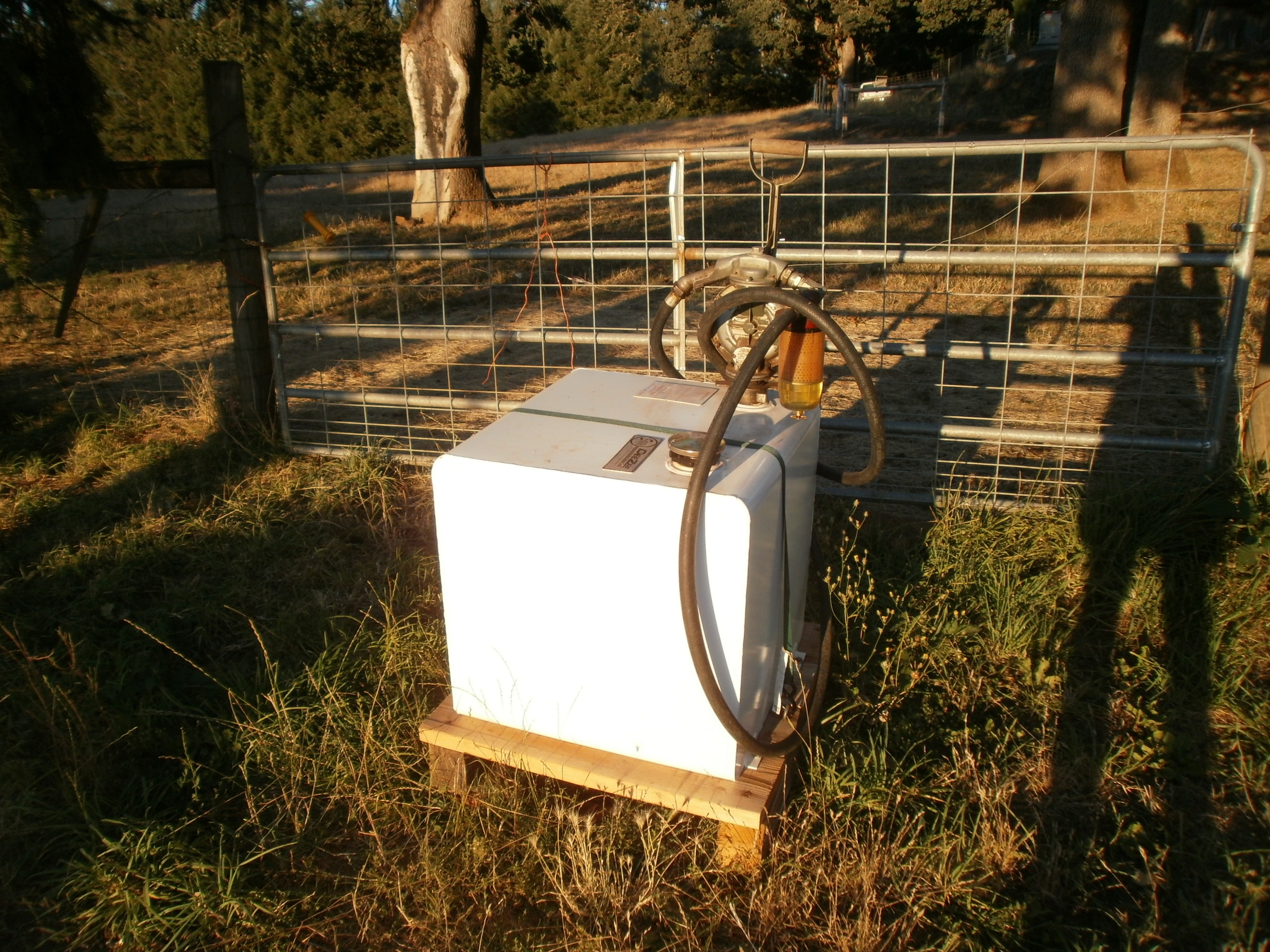

I would imagine any old fuel oil furnace tank could be used.
I have a fuel oil furnace do you guys know with the smaller CUT's can you run fuel oil (#2 diesel) or does it all have to be ULSD? My fuel oil is a 30% kero mix but I'm going to start filling from the pump with anti-gel as it is cheaper than getting Kero/Diesel mix.

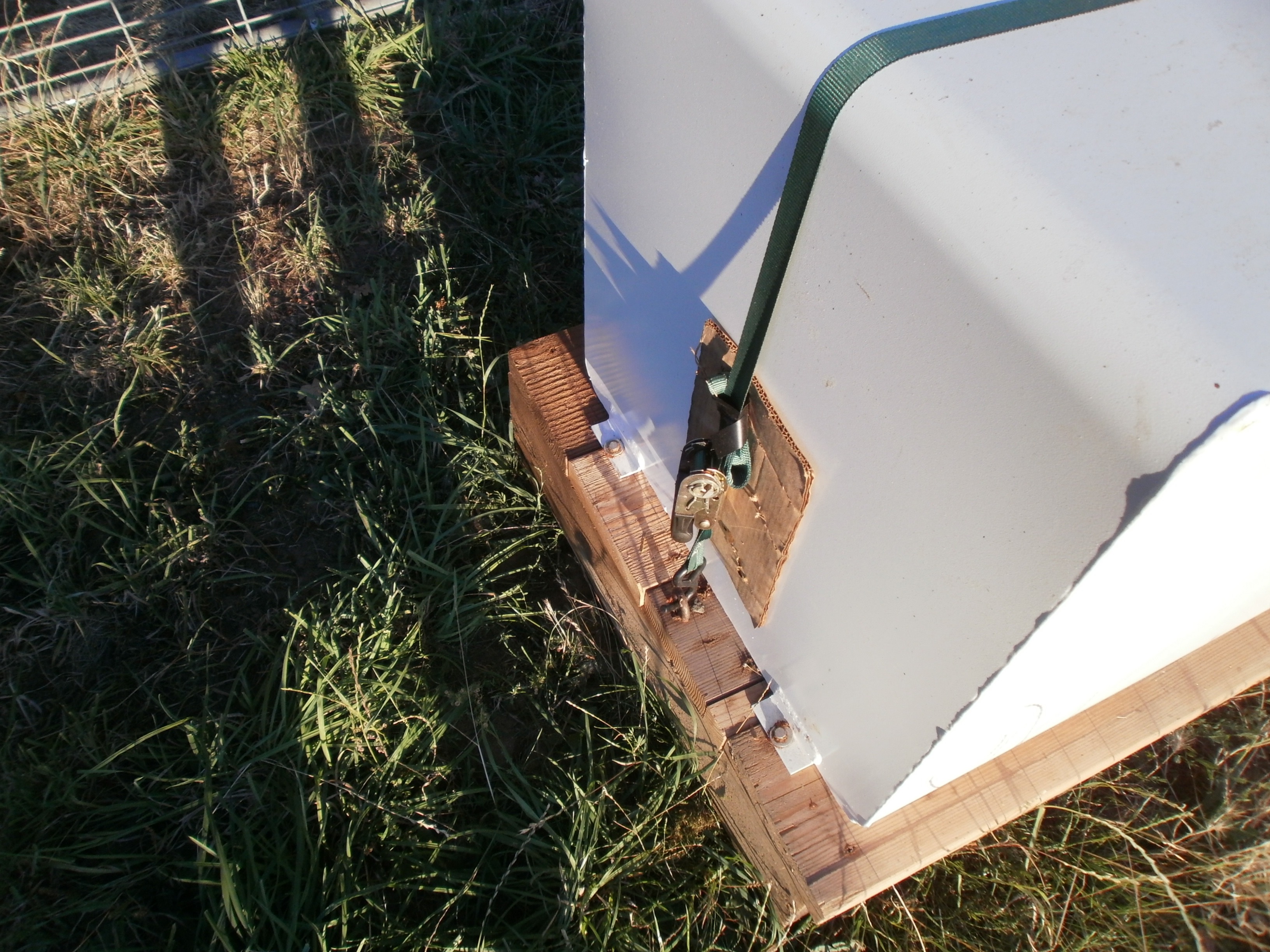

I have a 500 gallon tank. Local bylaws required it to be double containment. Electric pump and mechanical meter. Had it filled earlier this week............$2700 for marked. (Off road).

Only issue is that furnace oil has poor lubrication. You just need to add a lubricating additive.
I use a furnace oil tank. Works great.

If the FEL can lift it... a pallet-mounted tank would gravity-feed with no need for pumps or electricals.
