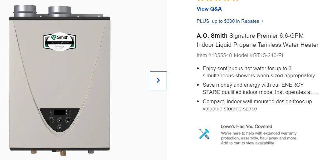

Thanks for your responses, keep them coming.
Should have mentioned it is for two old people in a small house.
Sounds like we would also have to get a water softener. :(
These are available and under consideration:
Your second photo is the exact same model I have, only mine says Takagi instead of AO Smith, as Takagi makes them and AO SMITH rebrands them in the US and handles service and parts for both. Both are sold in the US. Try Supplyhouse.com for good prices and excellent service. And Fast shipping.
