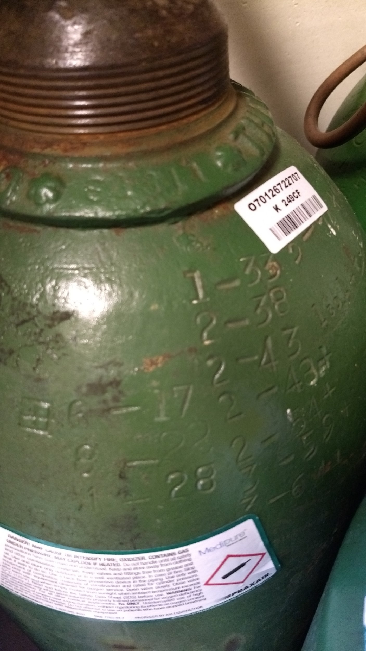

Mine was Pacific Oxygen Company based in Oakland CA with several California locations.
Here is one of the oldest I’ve come across in the Hospital medgas room… 1917… WWI era and still in use 105 years later for medical oxygen

These are standard cylinders at the satellite clinic…
Liquid Oxygen at the main hospital but the volume at the clinic isn’t cost effective for Liquid oxygen.
