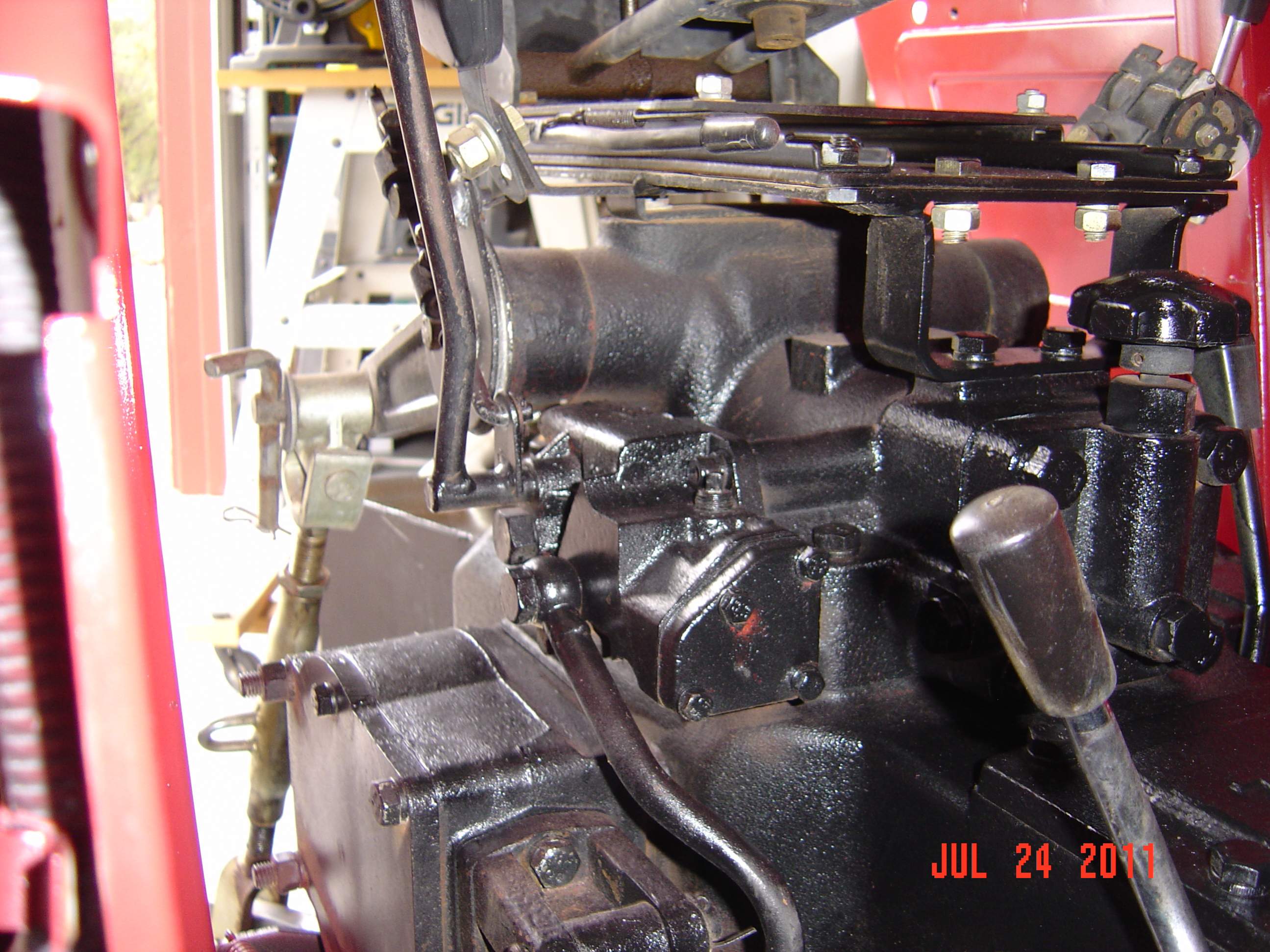

After the last bit of wonderful advice and info I'm again in need. I'm looking for a diagram of the HYD. system with flow direction and location of components if possible. Can't seem to locate such a critter, certainly none in the manuals. I have a loader, power steering, 3PT, but no backhoe. Seems the pump is below the starter, a strainer/filter (long/narrow) is below the step, with lines runnin to below the seat and some kind of valve located atop the 3PT housing. What appears to be a valve of sorts is located on left side of engine and runs to power steering below steering wheel.
Not sure if this system is common to three point and tranny sump. I would not think so but unsure as that valve/whatever is on top of 3PT housing.

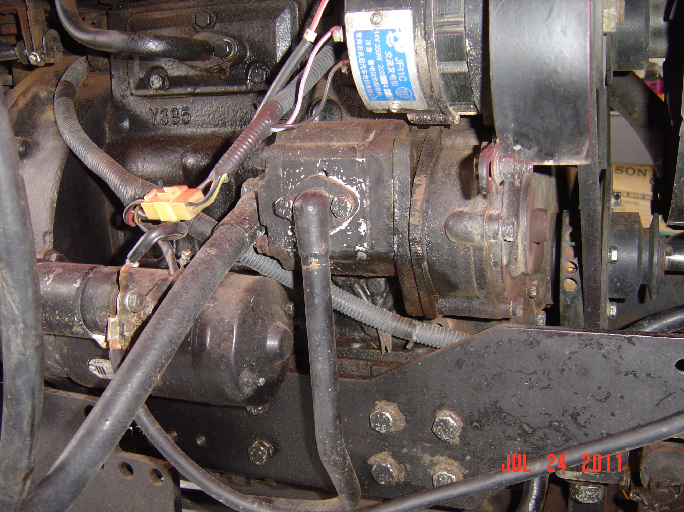

OK, looks as though the pics came thru ok. Machine is 2005 and I believe only one pump. Pic 2 shows what I believe is directional flow valve to power steering and is located on left sid of engine, lines run from right side fo front then under engine to left side and down to steering column.

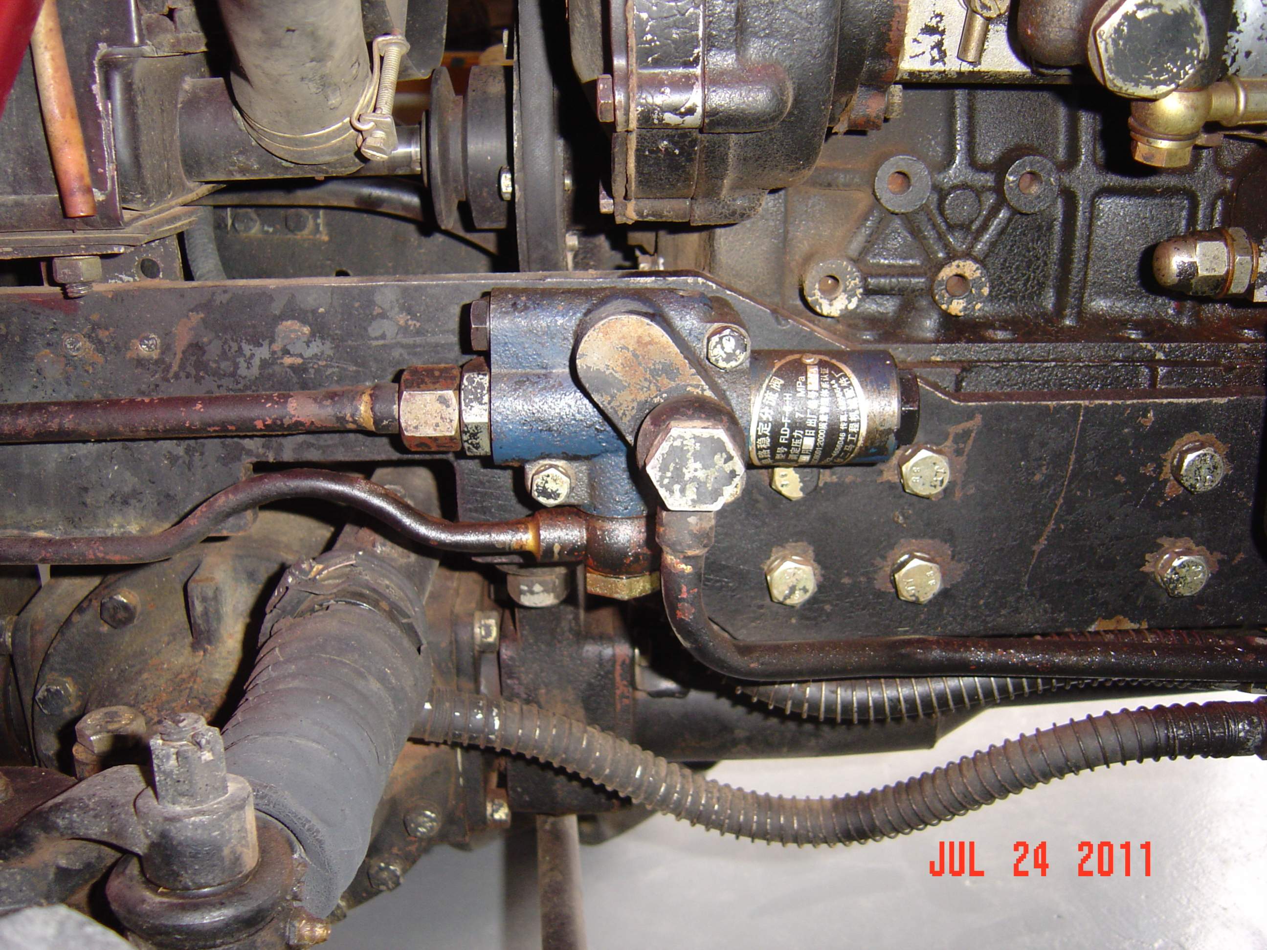

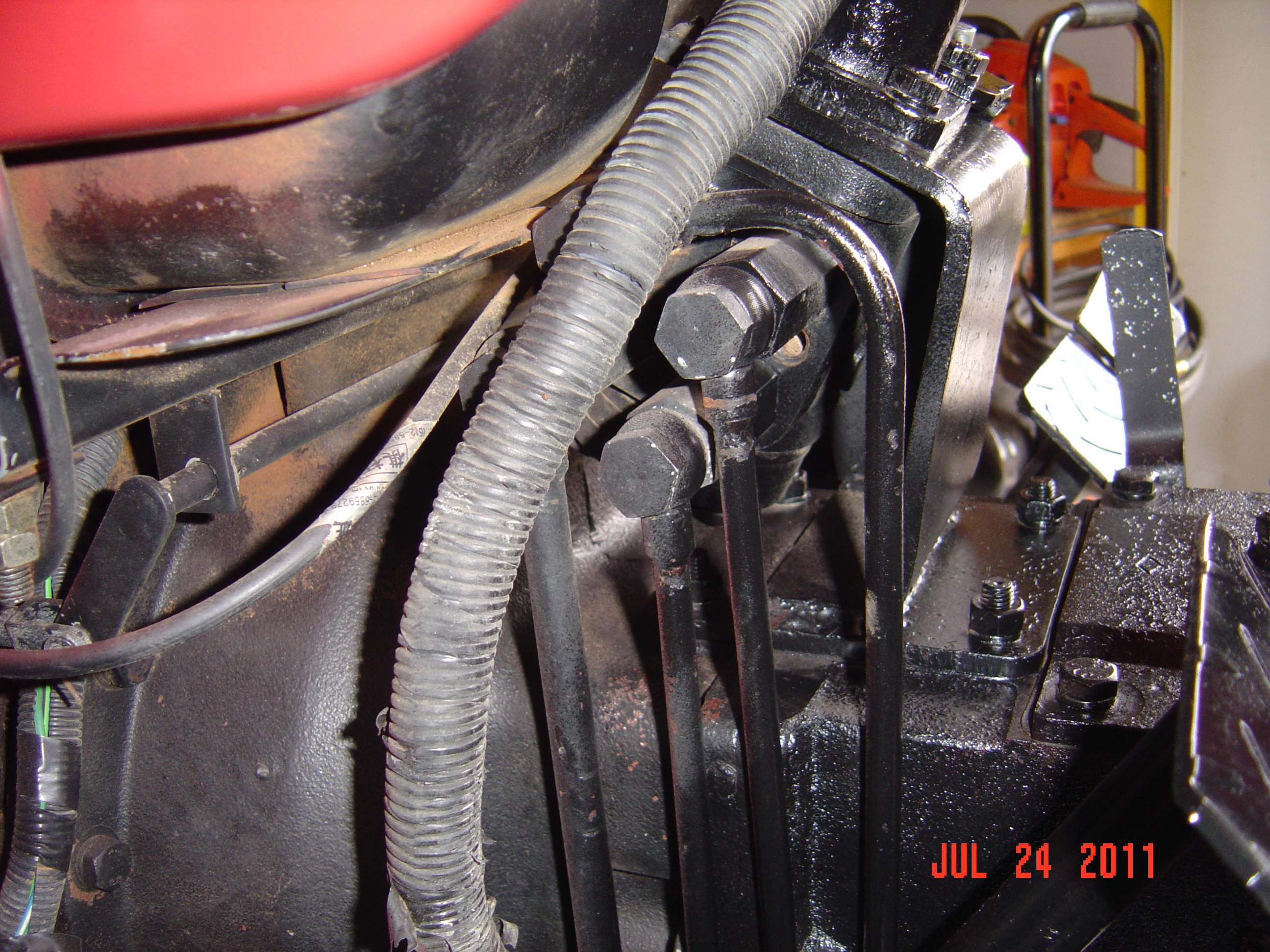

A little confused although I'm not the expert.
Pic 2 looks like a diverter/priority valve.
Pic 4 looks like the steering gear under the front dash.
Pic 5 looks like a single pump.

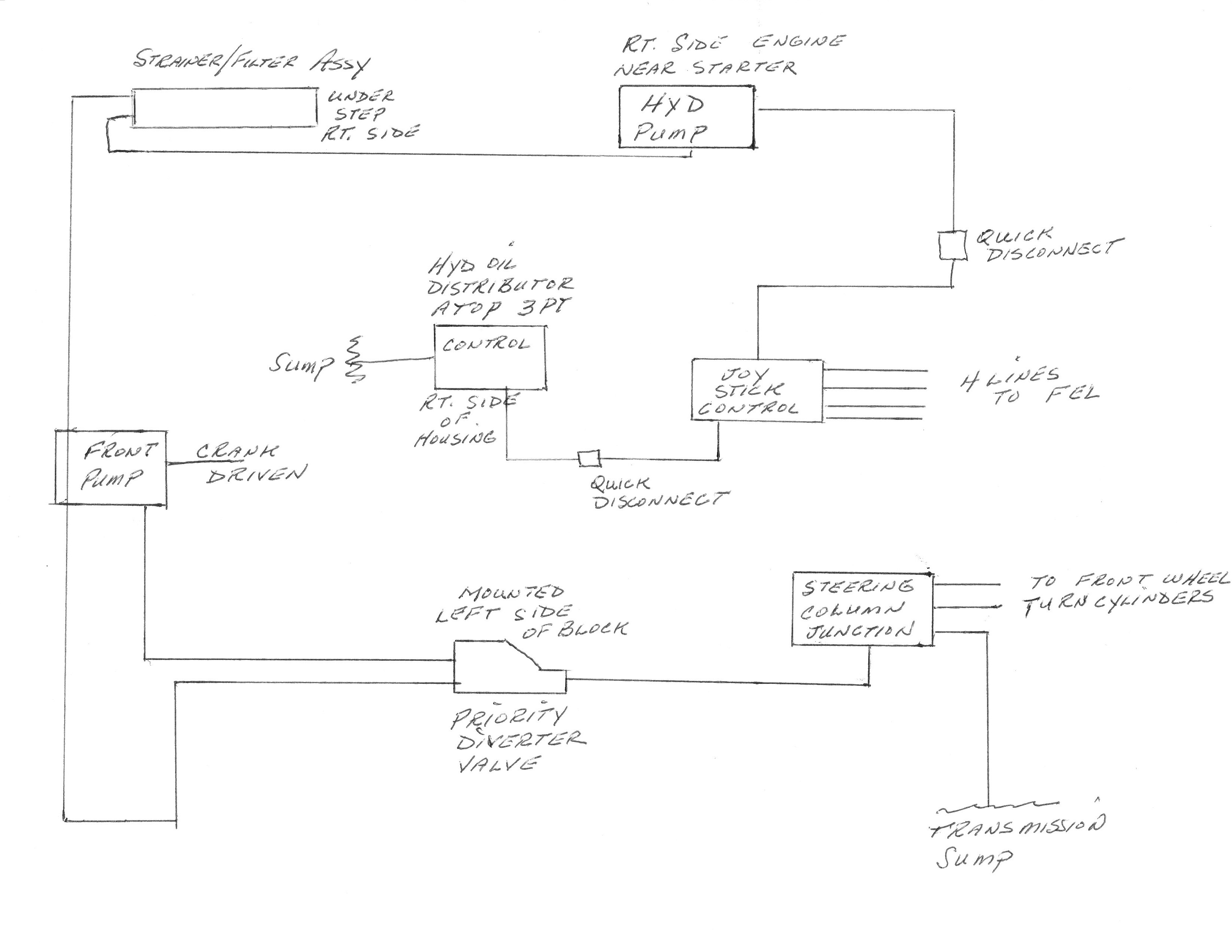

Tommy, you are correct also, that pic did show a driven pump fron the crank that is between the strainer assembly and the diverter/priority valve. There are two lines from that valve that go to the front pump, have not yet figured out the flow direction yet.
Feed & Return--One line runs to the 3PT and I would guess then into it's sump, another line runs from steering column box to the tranny sump.
I'm making a diagram of the system as to where components/lines are and run and hope to post same.

Well for what it's worth hear is the layout of the hydraulic lines from my tractor. Some of my terms may not be correct. Corrections/additions readily accepted.
Really difficult to determine flow direction unless there is a pickup point I was unable to uncover.
