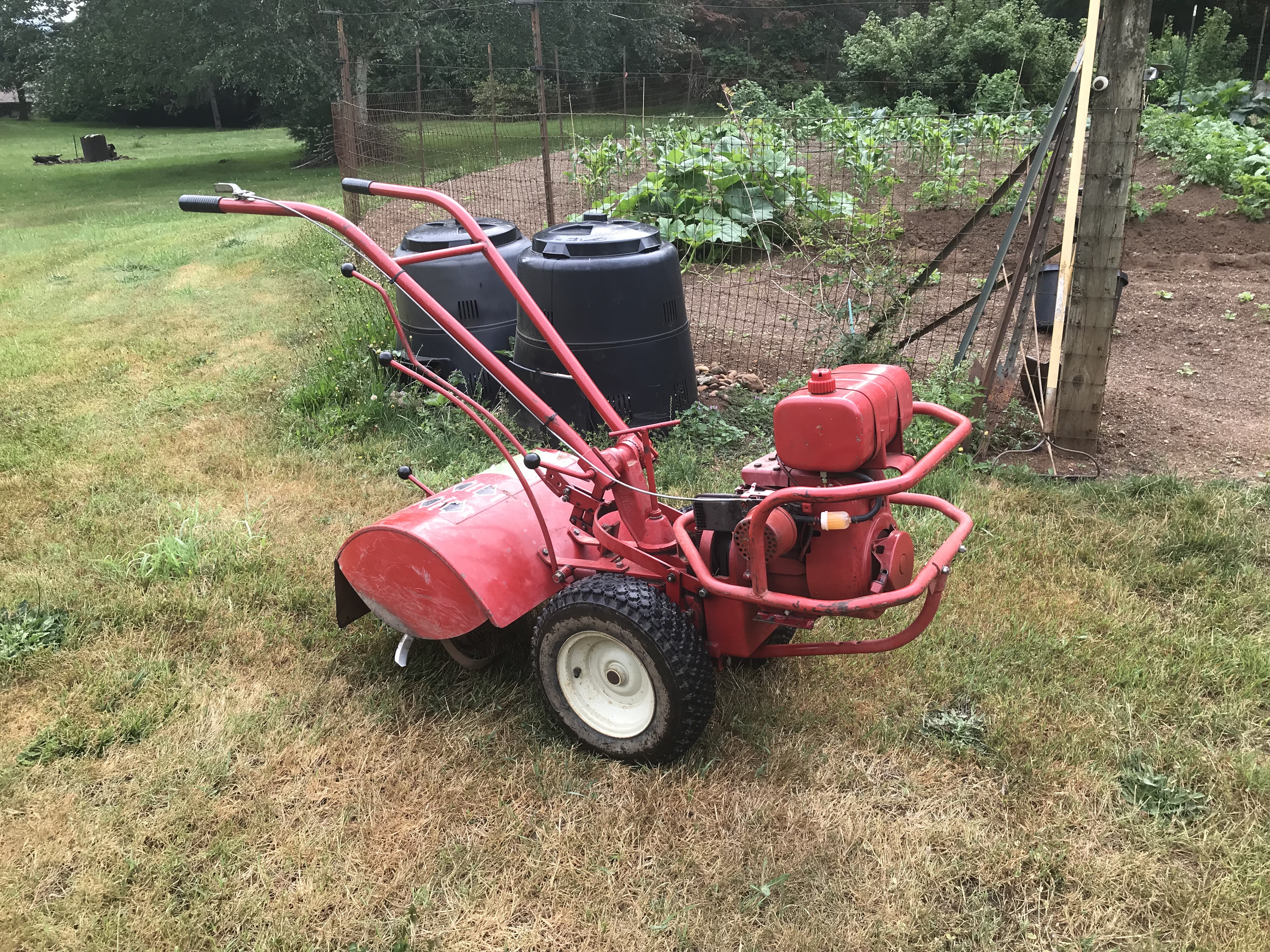

I have acquired a TB Horse serial number 144,xxx. It's the model with the fiber reverse disc. Six horse Tecumseh. It runs great but has no reverse. While the drive/reverse lever is in the neutral position, the cast tab on the rear of the motor to tiller mount (1002) is just above the adjusting screw (9713) but not touching. It's within 1/16". When I lift up on the drive/reverse lever the tab drops down and contacts the adjustment screw but nothing happens. I assume the spring assembly under the screw is supposed to compress slightly to allow the reverse disc to make contact with the pulley below. The spring does not compress. Nothing moves. I'm suspecting the plunger (1035) is supposed to move down when reverse is attempted. Should the plunger be free to move slightly? Thanks for any help you guys can offer.

Are you aware you have to lift the lever with some force, and hold it there, to compress the spring to get to reverse? It doesn't go into or stay in reverse like a gear transmission.

One thing I didn't mention is that my tiller has been sitting for a lot of years. On yours, when you lift up on the forward/reverse lever, can you actually see the spring compress? I think the plunger in mine is not free. When I lift up on the lever, as soon as the cast tab contacts the adjusting bolt, nothing happens other than the lever flexing. I'll go out there and squirt some penetrating oil into it and see what happens.

Watched a YouTube video, thanks 2manyrocks. I started watching it before, but got sidetracked before he got to the reverse disc/ plunger part. Anyway, the plunger on my unit was stuck. I doused it wd40 and gave it a good rap with a hammer. It works great now! Reverse works effortlessly.
