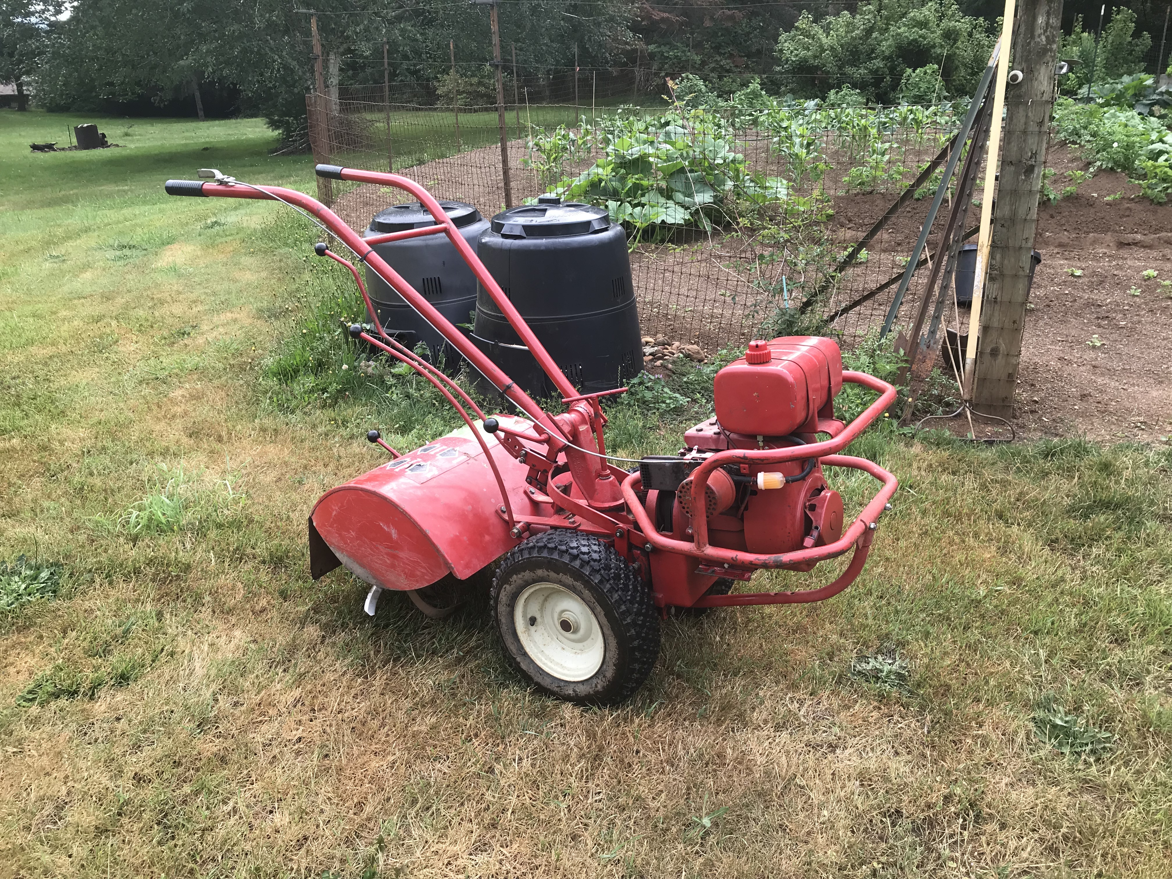

TB Horse Reverse
   / TB Horse Reverse #11
Reverse never worked from the factory very long on ANY of their tillers! I have and use 14 horses and only one of the newer ones has reverse! NONE of the older ones work and I took the disks out of most of them!--- dont need reverse anyway and yes the spring/plunger has to go down which most are bent/rusted or missing in them. They are almost impossible to get adjusted so they do work and NOT worth the trouble since they will only work for a short while then your back to square one and no backy up again!
   / TB Horse Reverse #12
I only have one Horse and the reverse works fine, but it took some adjusting and few drops of oil in the right places few years ago!
