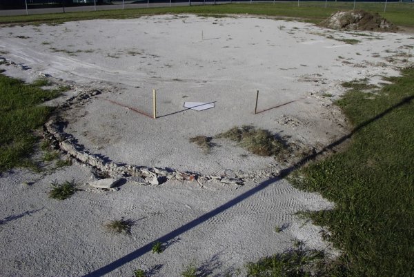

We first laid out the lines with strings and spray paint, then I used my <A target="_blank" HREF=http://www.tractorbynet.com/forumfiles/54-179976-slicer1.jpg>$10.00 slicer</A> to cut in the lines. At home I can cut a full 10 inches in one pass. Here at the park I was lucky to get 2 inches down per pass. The ground was rock hard and required three passes per line, but it worked great. I was even able to cut an 8 foot radius circle around home plate (see attached). As you can see by the picture, the ground way breaking out like concrete chunks.

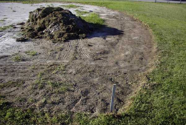

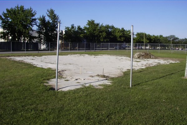

Next, I tried to use the 5 cubic foot bucket with teeth to dig up the sod where the infield meets the outfield. I could hardly scratch it. The teeth would dig in and then the tractor would bog down to the point of almost stalling. The wheels never spun so traction wasn't an issue. The ground was just too tough. So, I was making zero progress and decided to try the bigger 10 cubic foot bucket with a straight edge. Surprisingly, it worked great for getting under the hard sod. I could get a full 4 foot bite under the sod and advance about a foot, back up 6 inches and advance a foot and so on until the bucket was full. I followed the line around the infield that I cut with the slicer and it did a great job of seperating the infield from the outfield on an arc.
Trivia...Did you know that the radius of the arc on the infield is not taken from home plate, but from the center of the pitcher's mound?
7496d1028946157-tball-diamond-renovation-33-182352-day1pic003-jpg
   / TBall Diamond Renovation

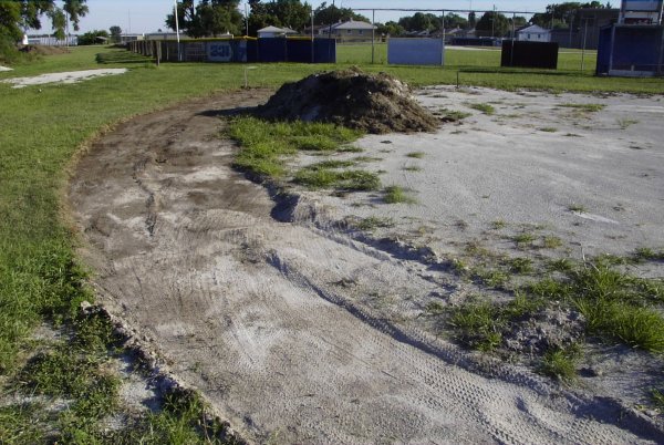

Day 1 we spent about an hour laying out the lines and about an hour making this pile of waste /w3tcompact/icons/laugh.gif. Not bad for a start.
