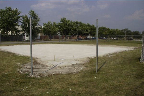

New Pics!
This is after day 3. Spent 4 hours with the PT425 on Sunday and it doesn't look half bad. Total time into the project is now 3 man hours and 5 or 6 PT425 hours.
I took two pictures and spliced them together for a wide shot of the field.

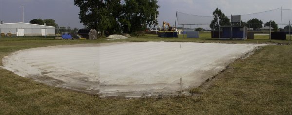

Here's a picture from behind the backstop. The area behind home plate circle will be filled in with black dirt and grass, as will the lines outside of the baselines. Then we'll add some moondust as needed for the low spots, keep it weeded all fall and spring and we should be set. /w3tcompact/icons/smile.gif

Moss, since no-one else has said it, thank you for your volunteer work. I too, take care of our ball diamonds. Have been doing it for 3 years now. Looks like your doing a good job. A few thin gs I can suggest you do tho are these.
1). Once you get to a point where you say, "Ok, lets play! The field is ready!" , use a rotor tiller on that field. If you dont, it will be a pond when it rains. Go to a depth of till you hit subsoil. That lime gets so dang stinkin hard, that it doesnt let water pass thru very easy. once tilled, let it sit for the winter. Leave it alone! This will allow you some time to raise some money. Next spring, you will need fill put on it. DONT USE LIME AGAIN! I cant remember what it is called, but it is a dark granular fill that packs pretty easy, but will still allow water to pass thru it. Find one of the fathers that has a dump truck and get him to use it for you. Dump it in the middle and move it around with your fel to a depth of about 3 inches taller than your outfield boarder. If you dont, and you leave it the way you have it, when a grounder goes to that outfield lip, it will "jump" up into the face of that lil youngun and hit him in the face.
2) Make a SMALL pitcher mound and a SMALL home base mound.
3) When you get ready to lay out your bases, get bases that have a pole, at least 8" long attached to them undernieth them. Wherever you put those bases, drive a steel pipe in the ground 1st, at least 10". Make sure you drive this BELOW ground level! After season end, you will need to work the fields again. When you do, remove the bases, work the field, get a metal detector and find those "pins" and you dont have to measure it all again.
3) UNLESS you want to have the responsibility of keeping this field lines and in shape all the time, make sure everyone in the league knows you will work the fields with your tractor when needed BUT you WILL NOT line the field BEFOR each and every game! Let the coaches do this.
4) Keep your "leveling" screens, "attachments", and other "toys" away from the field. If you keep these at the fields, then the coaches take it upon themselves to hook onto it with their trucks/cars/whatever and drive all over the fields! Thus packing it down more and more!They also will NOT remove the bases and drag the drag over/beside/any way they can to stay on the fat arsses and end up tearing those new bags. They will get pissed at you, but oh well! Leave some fill material and a wheelbarrow/rake/shovel nearby so they can use that!.
5) If you use lime for new fill material, you will have to find some other type of line making material, cause it is crushed ag lime.
6) Keep in mind, that the condition of those fields are what those parents look at, and that determines how many kids sign up. We have grown 3-fold since I started doing our fields. The fields I take care of are 2 at our local county park, and 2 at our local elementary school. All various stages of play...from senior leagues to T-ball leagues.
7) Once a year, you will need to spray weeds on the infield. Rig you up some kind of sprayer and do this yourself. Use some type of "kill-all" when these weeds get to a point where it bugs you that your field is looking like crap.
8) When you mow, or whomever does it, dont blow the clippings onto the field. Weed seeds on the field.
9) Have a "MASS" quantity of water available. (I get the local fire dept. to bring out their field/grass fire truck out to spray it down. IF you try and put fill over DRY material, it will not stick! You will just drag it out. IT HAS TO BE WET! A T-ball field will use 450 gals. in middle of summer with no problem at all!(thats how big a tank the fire truck is)
Is so many more things your in for that my experience has taught me! No one took care of the fields before I started and they looked like what you started with. I did things a little different than you, but the end result is the same. Happy kids playing ball and not getting hurt due to anything you have created! You need any advice.... email me if ya want. Would be happy to help!
woodyfloors@mchsi.com
have fun and rfemember to work WITH the materials and mother nature. You are exposed to all sorts of things against you doing this! Once you get those fields into shape, it takes a little time at 1st of year to get "winter" off them and ready to play. then MAYBE one time durinfg season of rework, and one time at end of season, and one time of weed spraying. Thats all you want to do! If you do more, it WILL eat up all your free time during the season!

Hey, thanks for the tips. /w3tcompact/icons/smile.gif
The bases are already set, you just can't see them in the pictures because they have their winter caps on and are buried under an inch or two of fill. We will do the same thing for the pitcher's mound after we are done.
The field drains pretty well, but you are correct that the granulated limestone packs down like concrete. We are lucky. All the fields in the park can usually be played on about a half hour after a hard rain.
The moondust was not my choice, but all of the park's 4 diamonds have it and that is what they are sticking with, so.../w3tcompact/icons/laugh.gif
I don't have to worry about parents dragging the field on their own time. That just won't happen as they are gone 5 minutes after the game /w3tcompact/icons/wink.gif
The coaches are responsible for lining the field with the little lining cart thing before each game, so I'll be OK with that. I can't remember if they use lime or chalk, but it comes in 50 pound sacks and is made especially for lining ball parks.
The coaches also have to pull the bags and put them in the shed after each game to prevent vandalism.
<font color=blue>Keep in mind, that the condition of those fields are what those parents look at, and that determines how many kids sign up.</font color=blue>
You got that right! I don't know how many people I talked to that got turned off to our park because of the bad experieince with the T-ball diamond. We could just never get those parents to volunteer to help, but they would easily volunteer their complaints/w3tcompact/icons/laugh.gif
And the other parent that helps me and I are going to place a weed killer schedule in the shed and we'll keep with it so we don't over/under apply the spot killer. Thanks for the tip on mowing away from the infield. I'll pass it along to the groundskeepers about the seeds blowing onto the field.
Again, thanks for the suggestions. They really help /w3tcompact/icons/smile.gif

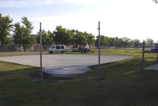

Here's a picture of the Tball diamond after about 15 hours of work. I took it this morning around 8:00am. Another father and I spent about 5 hours on it today. I forgot to take a picture before I left. We hand dug 10 fence post holes. It took several hours of watering and waiting as the ground is rock hard. Also spread several tons of moon dust in the low spots. Note in the background my PT425 on the trailer. /w3tcompact/icons/smile.gif

WHOOPS/w3tcompact/icons/eyes.gif Try again

Looks really nice. But what's Moon Dust?
