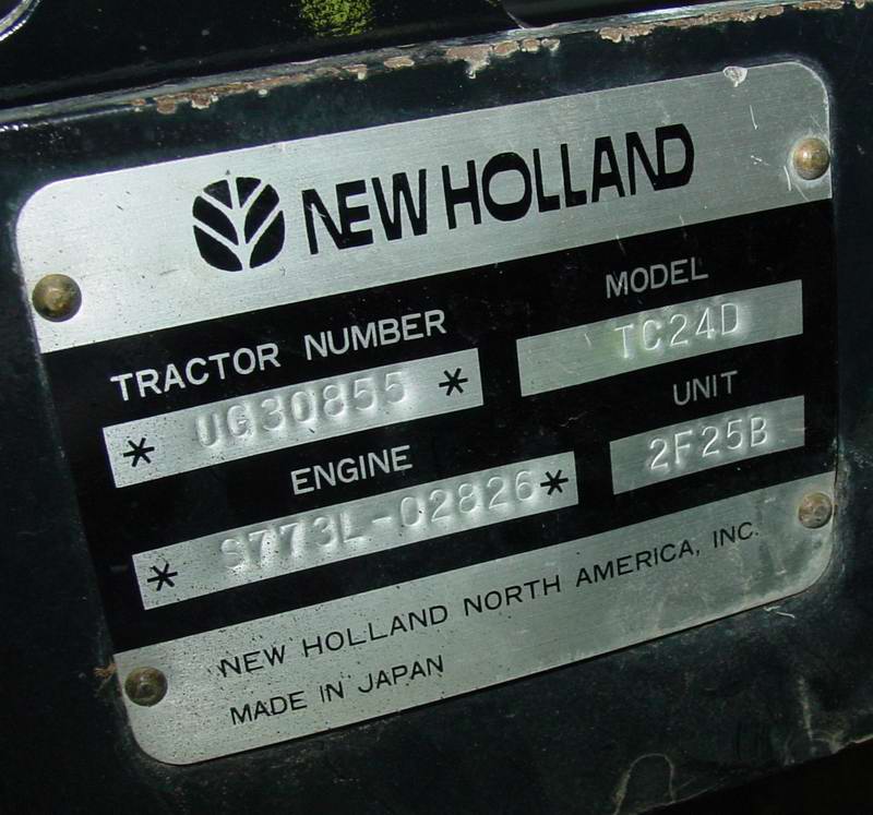

What is the serial number of this tractor I would like to go in and read the internal warranty reports on this tractor if you dont mind.
   / TC 24D with hole in the oil pan
#19
Re: TC 24D with hole in the oil pan more detail
Hope this helps, here is a picture of the serial plate on my tractor. Had it handy for the DMV farm plate app.
George
