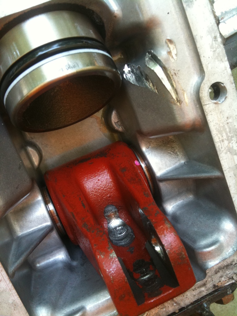

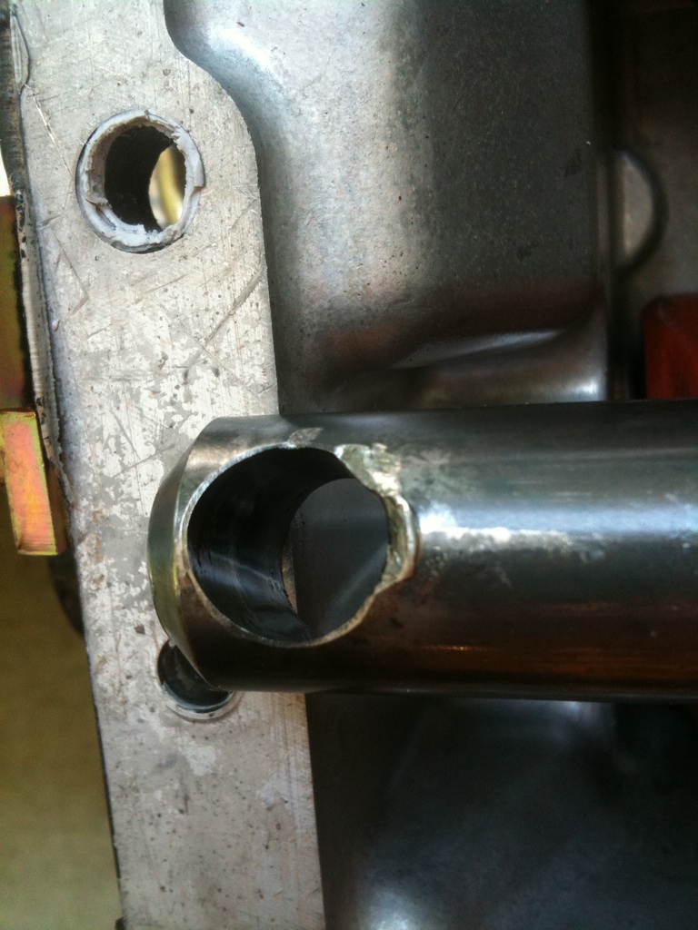

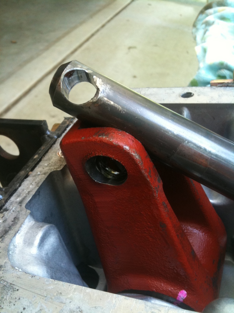

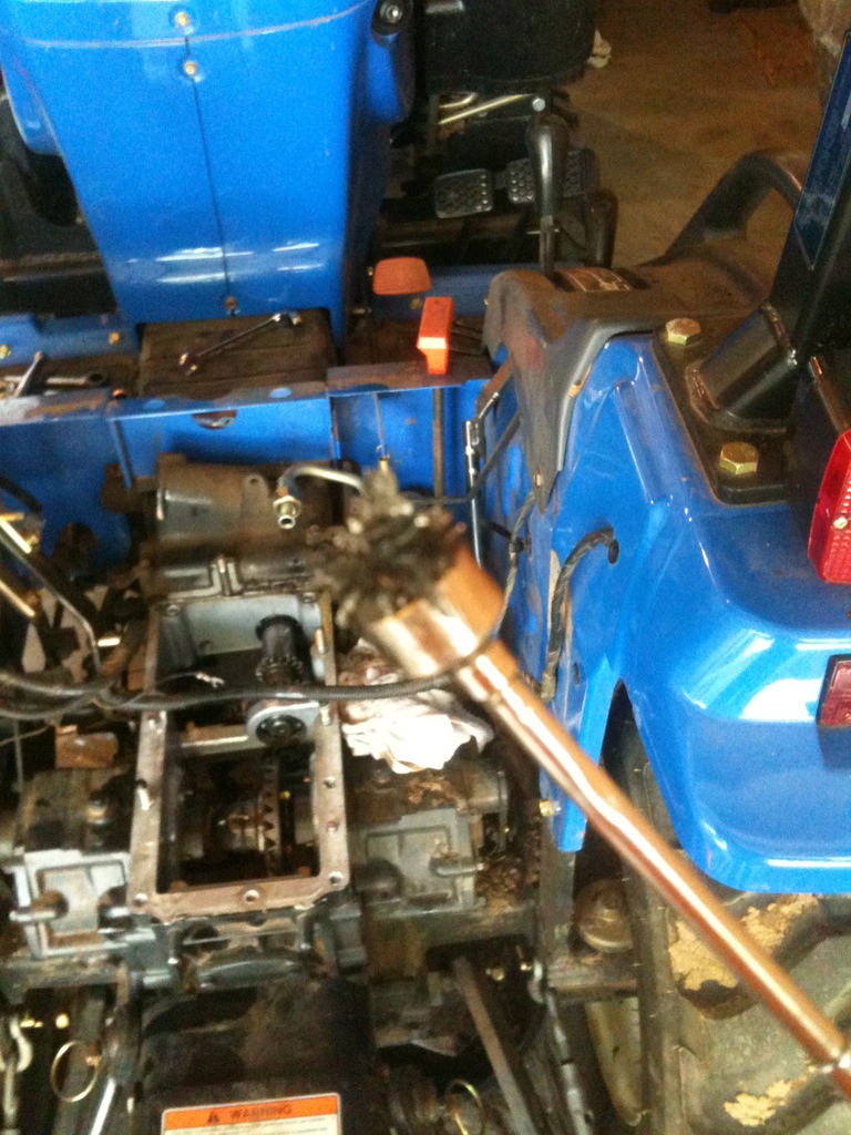

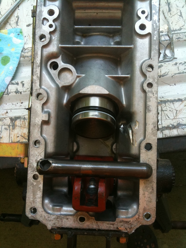

Well I took it all apart this weekend..... Never the less i dont see this as something I did or my friend. It looks as if the pin that holds the rod on the spline arm is missing, and by the looks of the metal shavings I found in the gearbox it has been going for some time. This comes down to someone at the factory screwed up and didnt put a circle clip on it or something.... Now what?

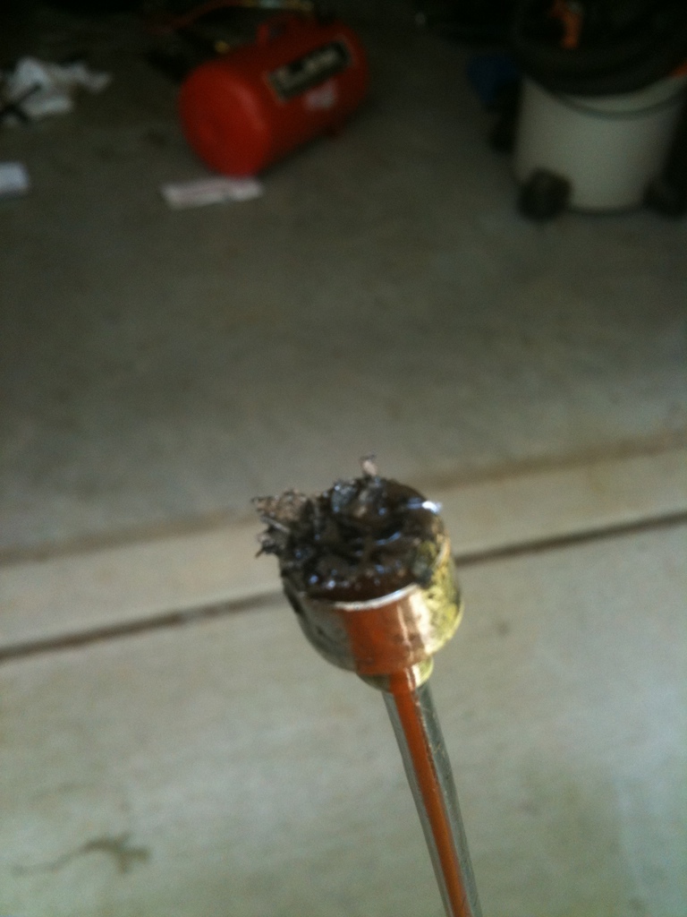

Both cases are scratched bad on the inside, the arm bracket is messed up as is the piston, and the lift pin. My gear box is FULL of metal shavings and all I want to do is choke the S.O.B. that build this tractor. What am I going to do with all of the metal in the gearbox? You know its in the bearings exc... This whole this makes me steam from my ears. I'm the sort of guy that waxes this thing twice a year and keeps it in the garage, this is my 2ed TC model, and I'm not pleased at this point with the prior TC24 or this unit. I just dont see how an entire 2-3 inch pin is just missing?
Look at the red bracket, you can tell it has been riding on the bottom of that for some time in favor of the top?
I just drained all of the fluid in the case, and shavings are on the bottom and on the diff gear, but there is no sign of the 2-3"pin that would hold everything together? I'm beginning to wonder if this thing ever had one? If you look at the first picture it looks as if the rod was riding at the bottom of the bracket for quite some time, and the piston cup has a notch at the top where it looks like the same thing, it would have worked this way, but I'm surprised it made it this long? I'm guessing because this thing is a 2006 I'm up the creek on War. but to me the factory is at fault, i mean how on earth does this just happen with ~200 hrs on it? I highly doubt that 2-3" pin got ground up without some major damage to the main gear.

Chico,
I just looked at the parts diagram on Messick's web site and ther is a pin that holds the rod in the rock shaft arm and that in turn is held in place by a cotter pin. There should not be any significant side loads on the rod or the pin so a cotter pin should be sufficient to hold the pin in position. It looks to me like the pin must have been sheared and since you don't have any thing but chips, it must have gone though the gears. I believe you said you loaned it to a friend the previous week before you noticed the problem. What was he doing with it?
The hydraulic relief valve should protect the lift system from overload so either the relief didn't work in an overload situation and the pin sheared or the pin was defective. I doubt you can claim it was misassembled unless you can identify what's in those chips. I'd talk to the NH dealer you bought it from. Maybe there's a service bulletin on this problem.
